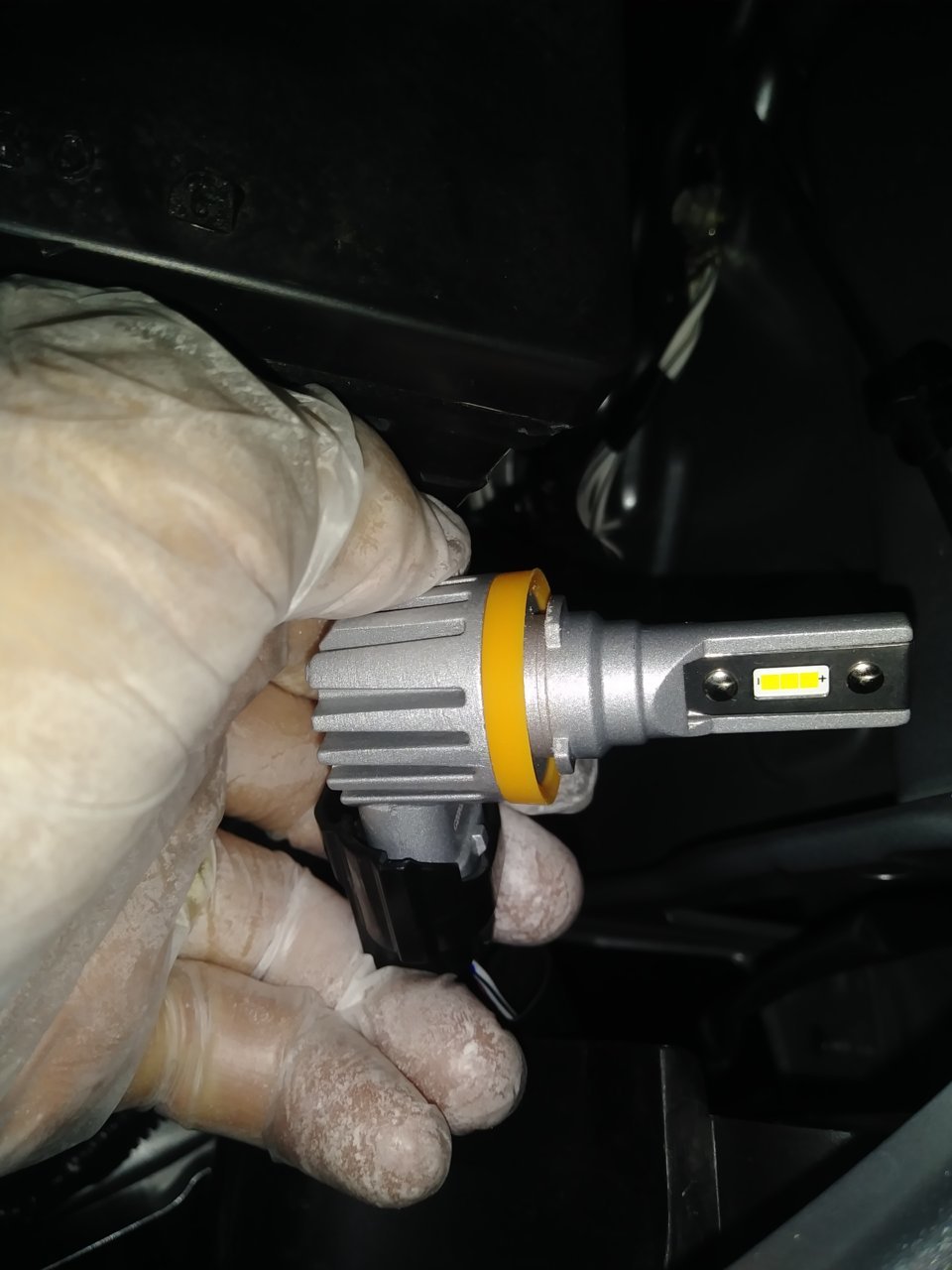

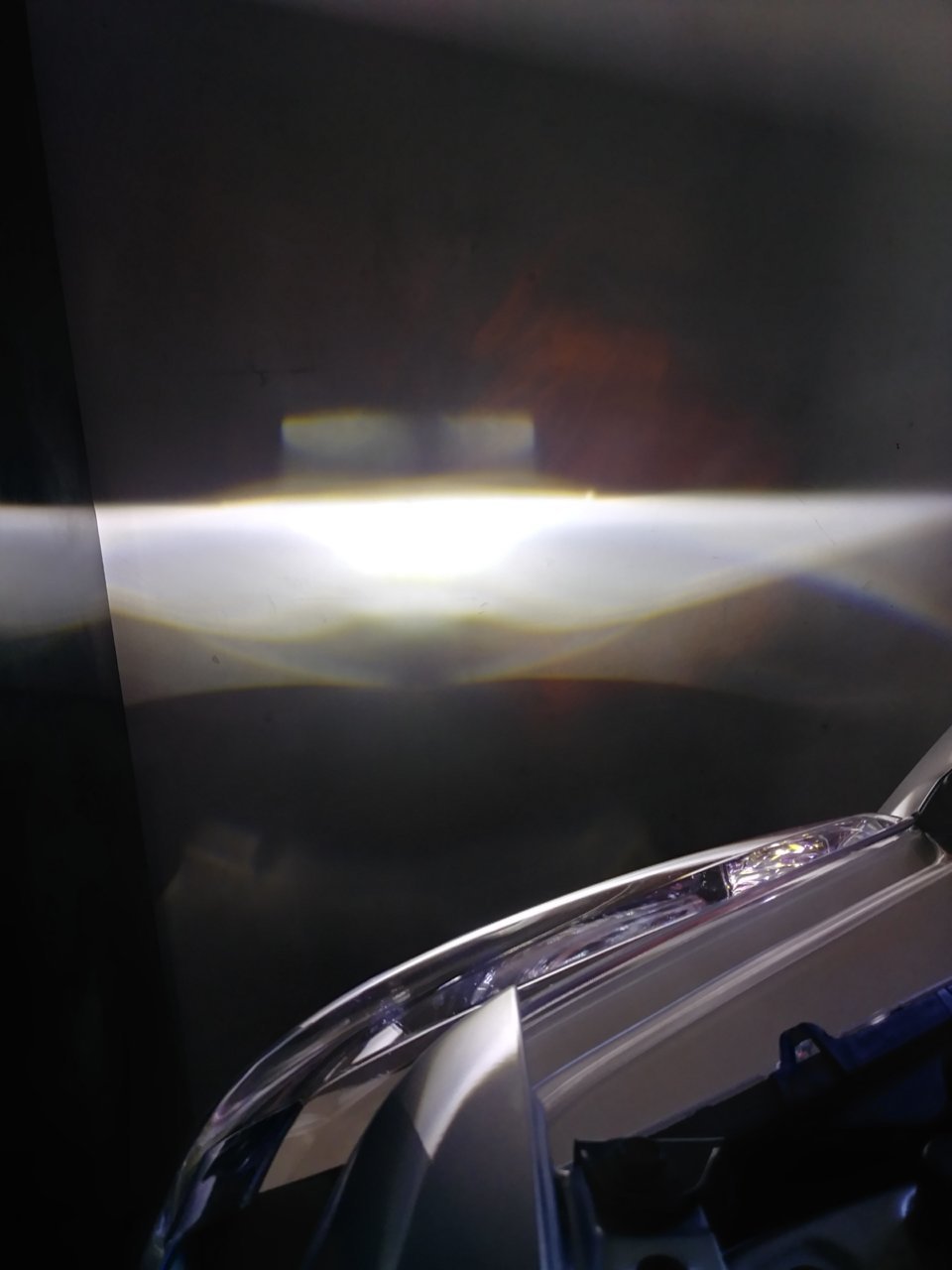

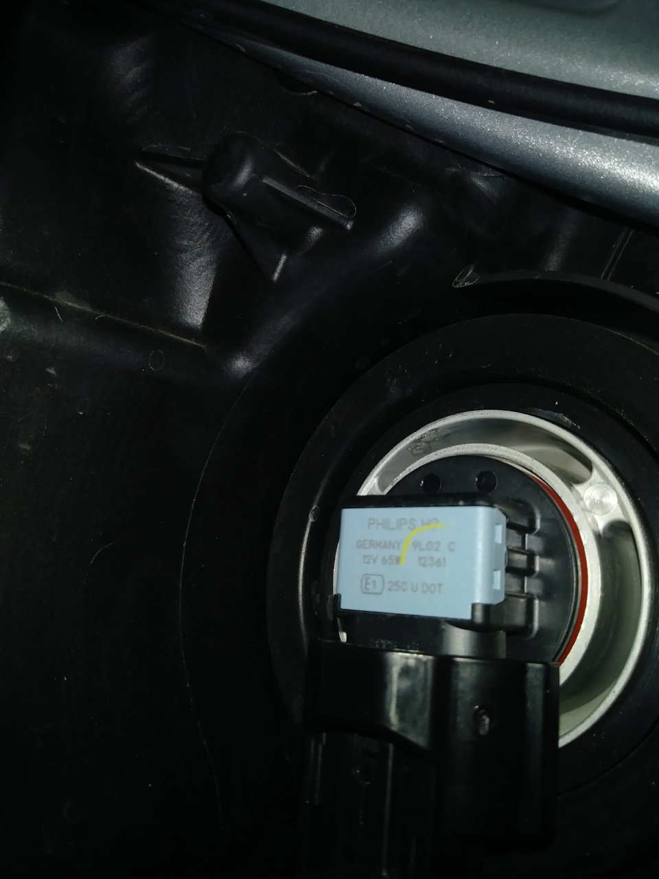

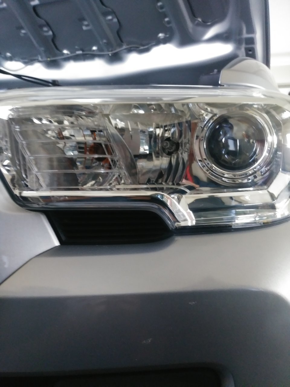

    Okay here are my pictures of my 2020 Taco SR5 fresh out of Mejico. The low beam 55w H11 LEDs are also used as day time running lights. I just photographed the back of the H9 halogen bulb 65w so I didn't have to take it out again but I'm sure you can see it in the front view of the headlight as well as my reflection. Let me know if you think my dealership substituted after market stuff in my truck. The truck also has auto high beams.

    Yeah those are definitely not OEM LEDs. Toyota LEDs are sealed units, along with other reputable LED replacement headlights (Morimoto XB/Aloha Rex). I would call your dealership.
    The SR5 DRLs are a dual filament amber bulb that acts as the turn signal as well. It’s a 7440 bulb. The low beam and DRL are completely separate bulbs.

    #328079

    Generic aftermarket. Those did not come from the factory, and are not legal.
    https://sbxparts.com/contents/en-us/p1701_H11-V10P-PerfectFit-LED-headlight-bulb-kit.html
    The only reason the beam pattern looks ok is because how the projector works with the internal cut off shields, while it looks fine in a short wall test it will not project distance like a halogen.

    The back side of the LED bulb has a square area where you would expect to see a manufacturer's sticker but it is blank! Does that mean the unthinkable? There is no discernible marking on the 'bulb'. Very interesting. I will take it for a drive tonight since I have not driven it at night yet.

    Yeah that sure looks like the 'bulb' in my truck. I will call the dealership manager tomorrow and find out what the scoop is on this. BTW, how do you know that they didn't come from the factory?

    Yeah, zero chance an illegal poor performing and likely dangerous aftermarket LED bulb swap that was never tested came from Toyota production.
    Exactly my thought.

    Wait a minute. Isn't AutoNation a used car dealer? I thought you bought it from a Toyota dealership? No Toyota dealership I know of would spend the money to swap in inferior bulbs. However, a truck sold by a used car dealership could have just about anything done to it by the previous owner.
    BTW, those are the factory halogen housings, not the factory LED housings. Just I like I predicted.
