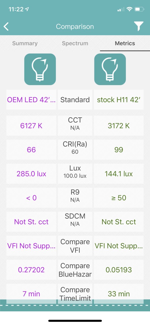

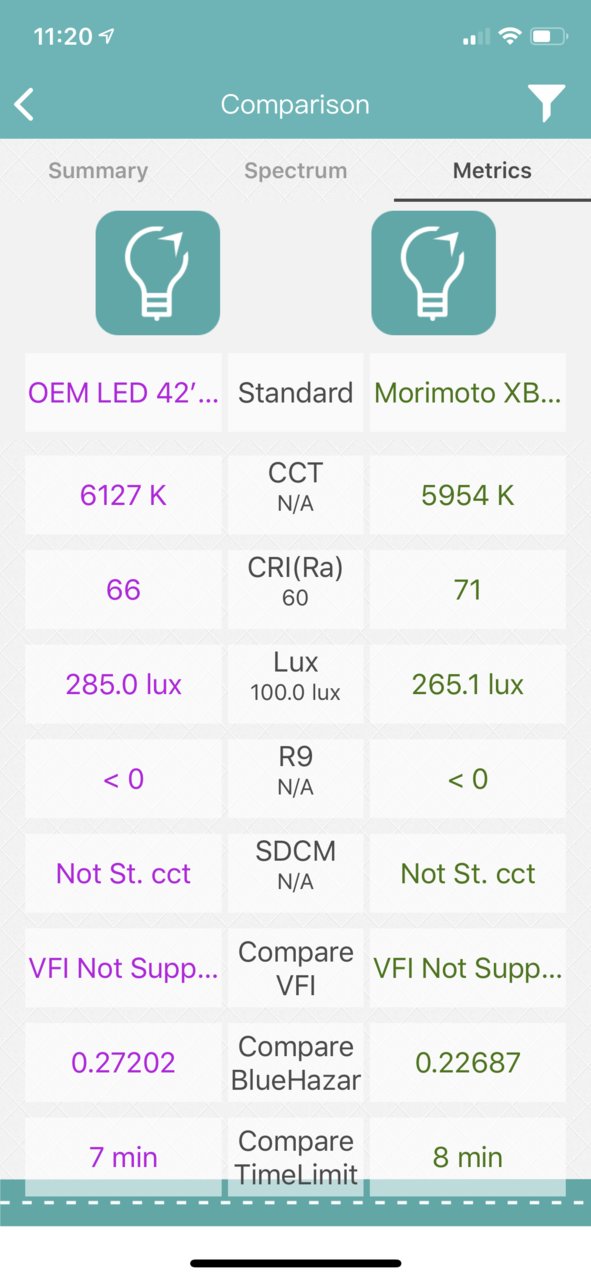

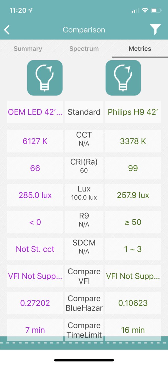

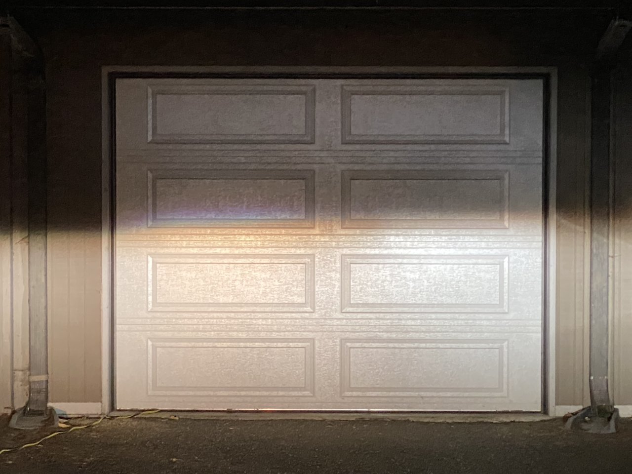

    OEM LED Headlight distance test
    Headlights ran for ~30 minutes for stable temp readings.
    German Philips H9 vs OEM LED in 42' test
    OEM LED vs German Philips H9 swap
    The OEM LED is the highest intensity street legal option tested yet. While the Philips H9s are about 10% lower in peak intensity than the OEM LED, keep in mind the Philips halogens will fade by 30% over the course of their lifetime, meaning in the later stages of the bulb life the LEDs will be substantially brighter.
    Compared to Morimotos, the OEM has higher peak intensity at 42'. However, the Morimotos do have a slight edge on color temperature, but not enough of a difference to be a factor in the decision making.
    Compared to stock the OEM assemblies are a substantial upgrade, nearing double peak intensity output.
    High beam testing still to come soon.
    Based on the additional low beam distance test, the OEM LED headlights appear to be the best performing off the shelf low beam headlight on the market for the Tacoma. If you do not need to worry about icing in snow environments, these look like a solid buy as an outstanding performing headlight. For environments where regular snow is a concern, a halogen upgrade would be more appropriate.

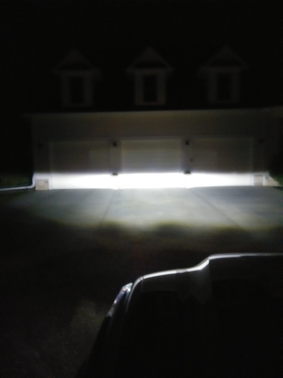

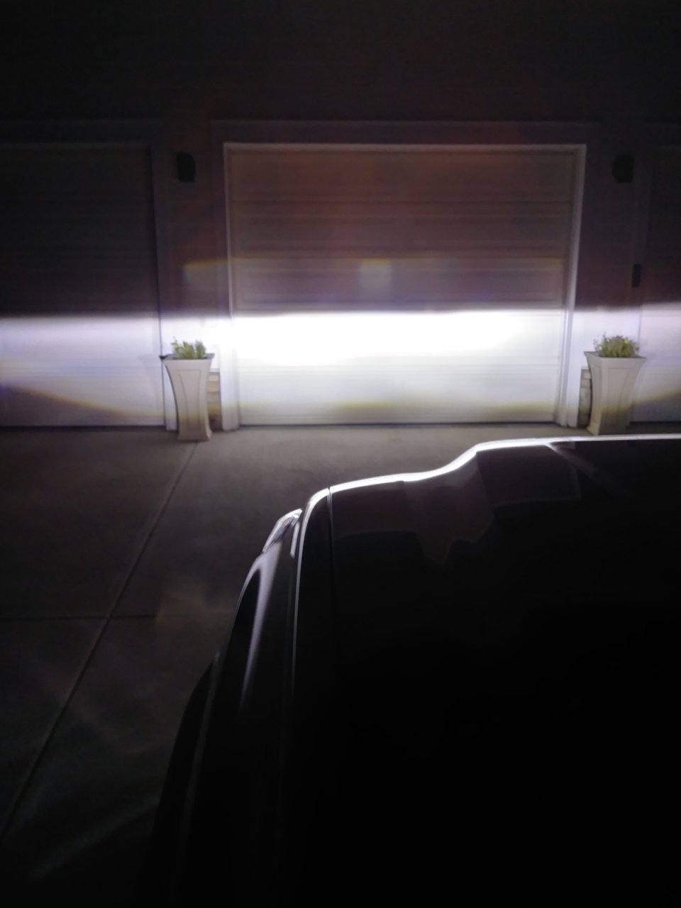

    I took the truck out for a short night drive and also took a couple of pictures for what they're worth. Low beam Led's seemed nice and bright to me.
    I noticed the cut off seemed clean to me and I could clearly see objects at 300 ft. I will talk to the dealer today to find out who put non-stock bulbs in my truck. Picture at 18 ft.
    20200817_204001_HDR.jpg I'm just curious why these Led's https://sbxparts.com/contents/en-us/p1701_H11-V10P-PerfectFit-LED-headlight-bulb-kit.html aren't street legal? 20200817_204142.jpg 50 ft distance on uneven driveway. The truck is sloping nose downward due to higher driveway behind.

    LEDs can be very bright, but they are usually not bright in the correct location. They typically shift the light intensity to foreground light which looks very impressive from the driver seat and people naturally favor foreground light, but that limits distance projection and night distance vision, it isn't how headlights are supposed to work. This makes it so that at highway speed at night it is possible to overdrive your headlights, meaning by the time an object is visible you will no longer have time to stop to avoid hitting it. This isn't noticeable in lighted urban areas or at slow speeds. There is a lot more that goes into headlights than just being bright. Scroll through post #3 for many examples, nearly every tested LED fails to match the low performance stock halogen bulb at a distance of 42'.
    As mentioned before, you can put any light source in there and the cut off will be clean. It has nothing to do with the LEDs, that is how projectors work due to the internal light shield that forces a cut off.
    All replacement LEDs in headlights are not legal, it has nothing to do with that specific LED bulb.
