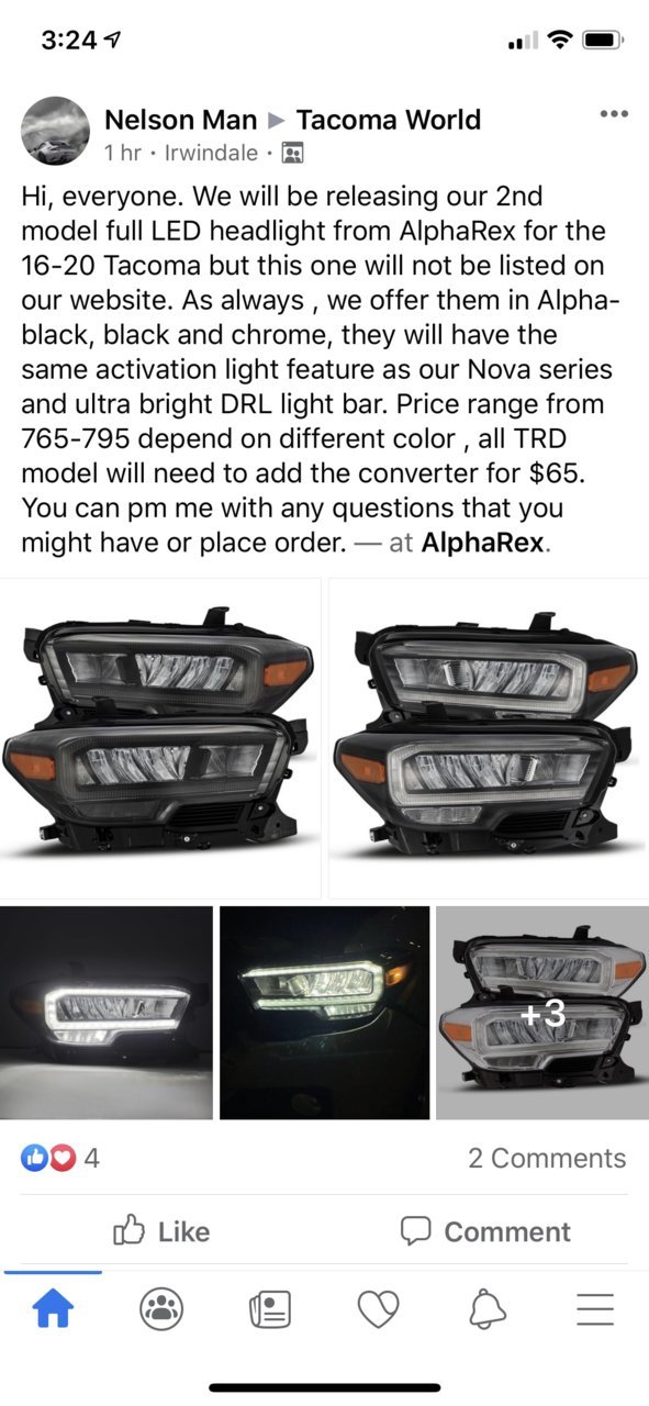

    I have not been impressed with what I’ve seen from AlphaRex so far. But looks like they are releasing some reflector based LED headlights.
    Boghog1 likes this.

    damn, those are even uglier than the projector nova
  14. Sep 11, 2020 at 3:33 PM
    #3134
    Kairide
    Kairide Well-Known Member
    May 20, 2020
    #328694
    1,177
    2020 White SR5
    A little shady that they won't be listing them on their website. I wonder if the new version is not DOT approved, maybe that's why they're not selling them on the website for liability reasons.
    xxTacocaTxx and RushT like this.

    Most likely because it is the same housing as the OEM LED Headlights or the DEPO version taken from the manufacturer in China/Taiwan.
    I also found what appears to be AlphaRex's headlight manufacturer when browsing through Alibaba.

    They look almost exactly like the OEM LED headlights, with different shades of smoke and chrome.
    Am I missing something?

    I actually suspect the design is too close to the OEM LED headlights, they look like they could be knock offs, which would land you in legal trouble with Toyota. Fortunately I have a channel for that.

    Ahhh makes sense, I’m not too familiar with the OEM LEDs so I never noticed that. It’ll be interesting to see how this plays out. Gives Morimoto the ethical advantage at least now with the competition, if that means anything.

    Just noticed TacomaBeast are the first to run these headlights. Easiest way to tell is the sidemarker. AlphaRex's knockoffs use the same side markers from the Halogen headlights, while the OEM LED have an angular look with a large reflector and light goes through the top and bottom.
    @crashnburn80 do you think these will have a similar output to OEM?
