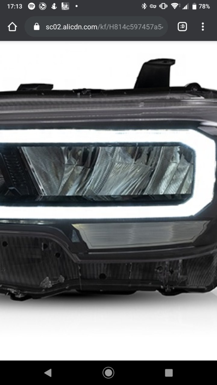

    That first one is the same one I found a couple months back! See how they even blur out the AlphaRex logo.
    The 2nd one isn't AlphaRex's version, but VLands version. Same housing though. But ye, China with insane markup.

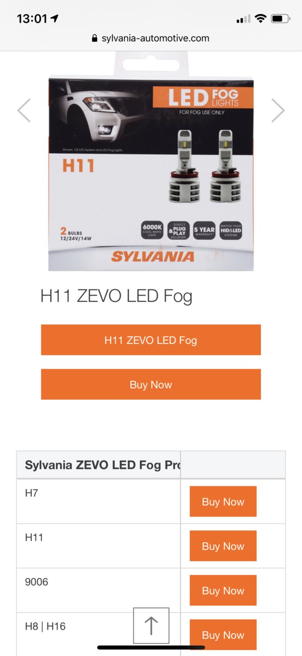

    Love my Sylvania Zevo's, they dont need the piggyback little box. A true plug and play LED's for your headlights, and 5 years replacement warranty. Made in Italy.

    Won’t end well. Just was looking at these and they call them H11 fog lights on their web site cause they legally aren’t plug and play for headlights like ours cause of people like crash using actual science. 33FA8402-99F9-41A0-8BC7-BC5F59A67A32.jpg

    Looks to me that the VLAND knockoff LED Headlights only have 3 Low Beam LED per side. Compared to the OEM's 5 LED per side.
    And from the looks of it, it uses the Halogen Headlight housing. Making these knockoff a "flatter" look.
    On the OEM LED headlights, the assembly is pushed inwards a little, more towards the sidemarkers, giving the lights an angled, longer and sharper look. Also allows for more LED space.

    Great observation. I'd agree that assuming that Alibaba light reflectors are placed in the correct location (might be a big assumption) they do look to only contain 3 low beam emitters. I'd bet my truck that performance is no where near the OEM LED headlights.

    So VLAND's manufacturer took a close up video for me.
    3 Low Beam LED Emitters vs OEM 5 Low Beam Emitters
    1 High Beam LED Emitter vs 2 High Beam LED Emitters
    They said the Turn Signal is in the parking light reflector. But can be configured to have the entire "C" as a switchback.
