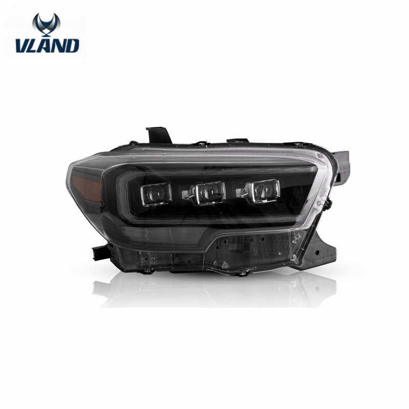

    VLAND's manufacturer sent me another version of their lights. Looks like a mash up of the OEM LED and Morimoto XB.
    These go for $400-500, and about $100 via UPS, for a set.

    Yeah, I’ve seen those on Alibaba. I’d avoid any Alibaba light specials. The AlphaRex Alibaba lights look to have abysmal beam pattern and were likely never actually compliance tested. I wouldn’t expect any better with other Alibaba headlight products.

    There is a now local AlphaRex distributor in my area also. Came across one of them at a stoplight, do not know if he just aimed it wrong, but there is a lot of light on the road right in front of him.
    Couldn't really compare light throw. OEM are brighter too, or seems like it. I was able to cast a shadow over his lights.

    Likely not aimed wrong. Everything I’ve seen with those lights is they have stupid excessive foreground light, the ‘hot spot’ is way too low in the pattern if you could even call it that, and they lack pattern intensity at the cut off, meaning little distance light.

    So VLAND's manufacturer sent me another video of the "Higher end" headlights. It has the signature AlphaRex startup, though the turn signals was not what I was expecting...
    There is also a short look at the beam pattern @0:35, looks "meh" at best.
    All projectors appear to be bi-LED.
    I kind of like the look of these though.
    Didn't think they had actually brought a Tacoma to China to test their stuff on.
