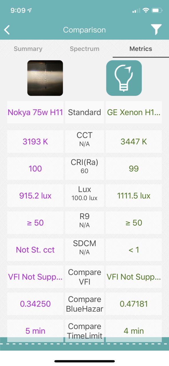

    @replica9000 sent me some Nokya bulbs for testing. One of the more interesting bulbs not included in this thread so far was the Nokya 75w H11. Interesting because Philips H9 is just shy of 75w, but in H11 form the Nokya is basic plug and play with no needing to trim plastic tabs or difficulty mounting in the bulb socket.

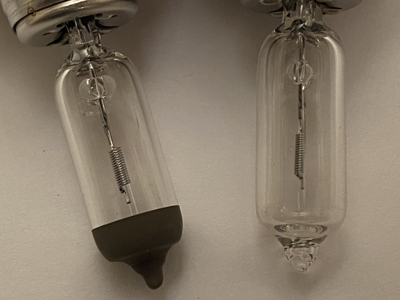

    When comparing the filament windings for the Nokya 75w H11 (left) vs the Philips H9 (right), the Philips bulb has tighter filament coil winding, which enhances focus and leads to higher intensity output.
    Comparing Nokya 75w H11 (left) vs GE Megalight +130 (right)
    The Nokya bulbs larger coils pay a price in focus intensity as indicated by the lux numbers.

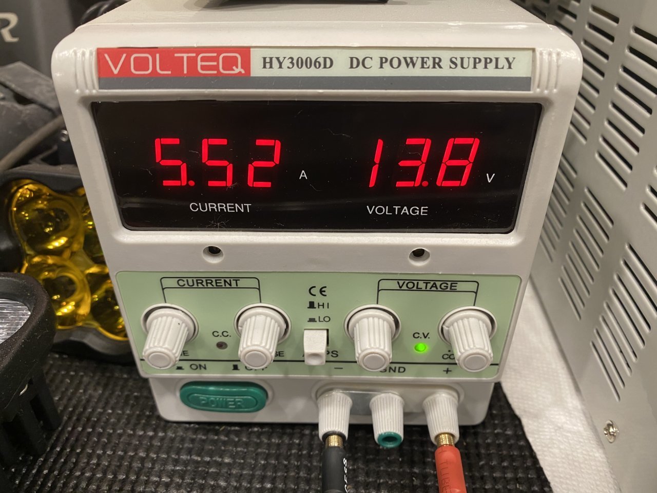

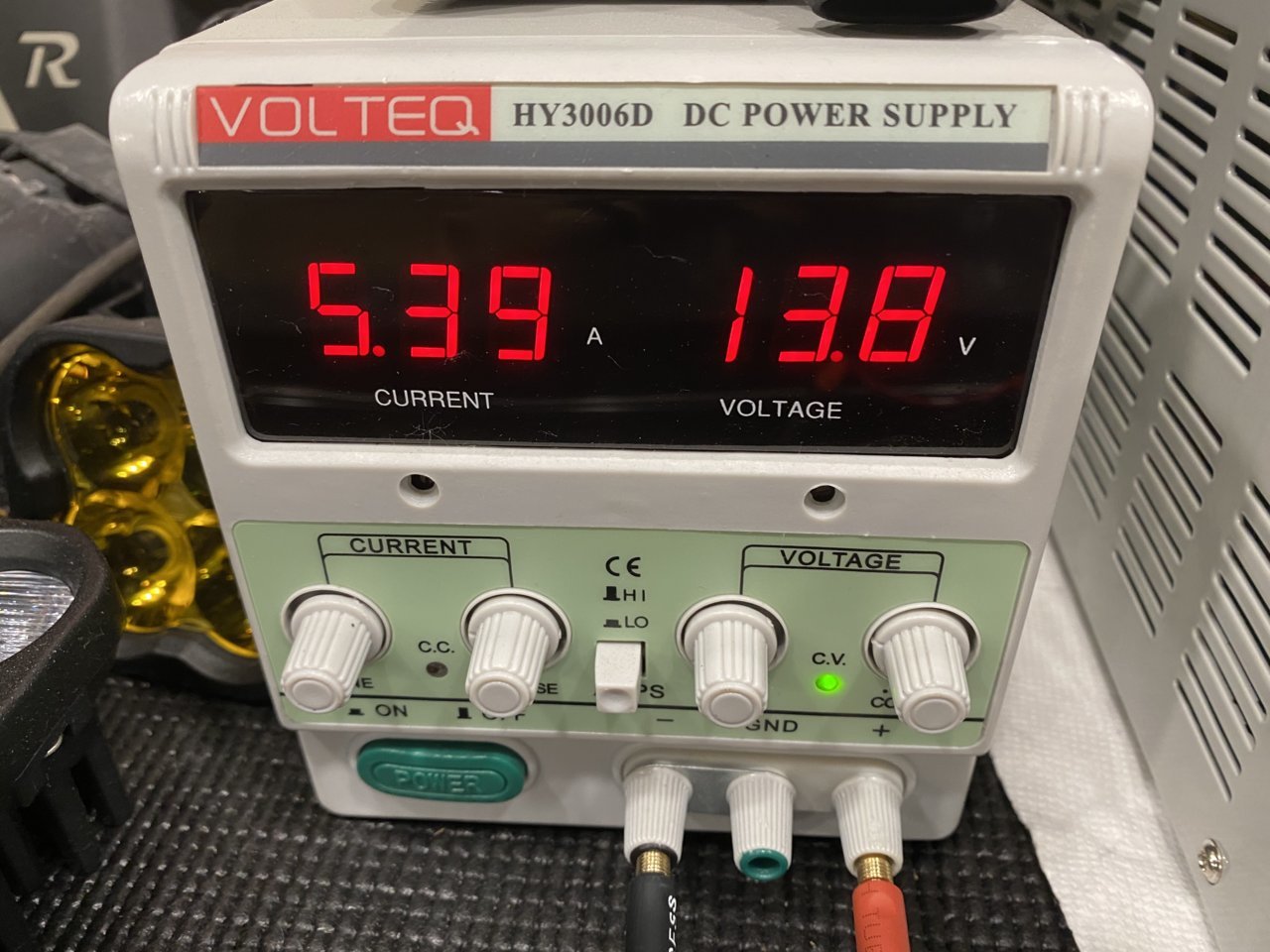

    The Nokyas draw 76.2w, which is slightly higher than the Philips H9.
    Nokya 75w H11 (left) vs Philips H9 (right)
    Nokya 75w H11 vs Philips H9
    Results are a bit disappointing. I was hoping Nokya would basically create a glare capped H9 with an H11 plug, but that isn't the case. The larger filament coil windings of the higher wattage H11 negatively affect focus and output intensity compared to other performance options. The Nokya 75w H11 bulbs are still a great improvement over stock, with almost +50% output intensity improvement compared to the stock Osram bulbs but the Philips H9 swap is 40%+ higher in output intensity over the Nokyas and cheaper. Being an H11, the Nokyas do have a glare cap which will reduce uplight/glare over the uncapped Philips H9, as the Philips bulbs fall just outside legal uplight levels. Nokya does not publish any lifespan specs that I am aware of, but I would also expect the heavier coil H11 filament to last longer than the finer filament of the Philips H9.

    Nokya H9 left vs Philips H9 right

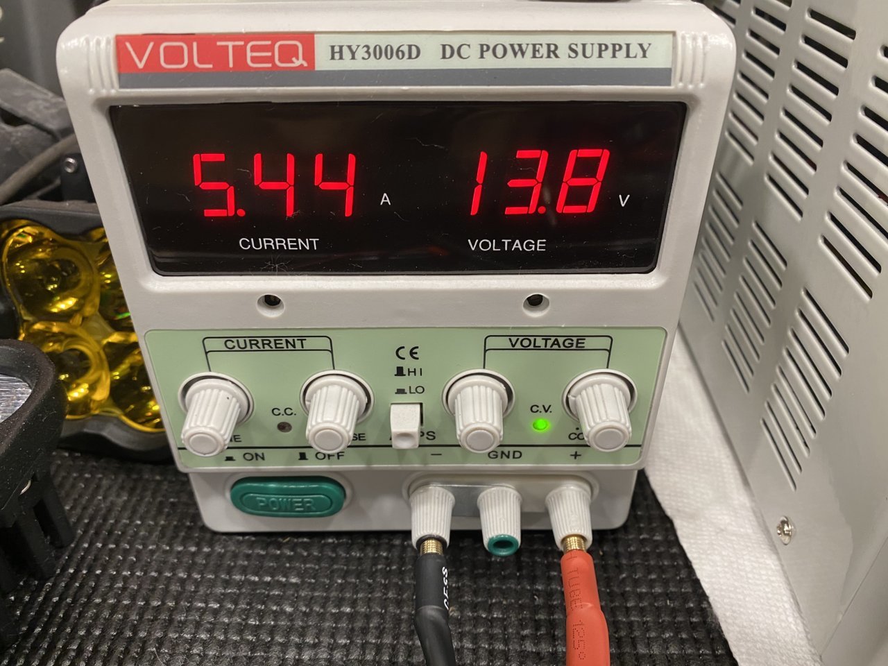

    Nokya H9 power draw, 74.4w.
    Philips H9 power draw, 75.1w.

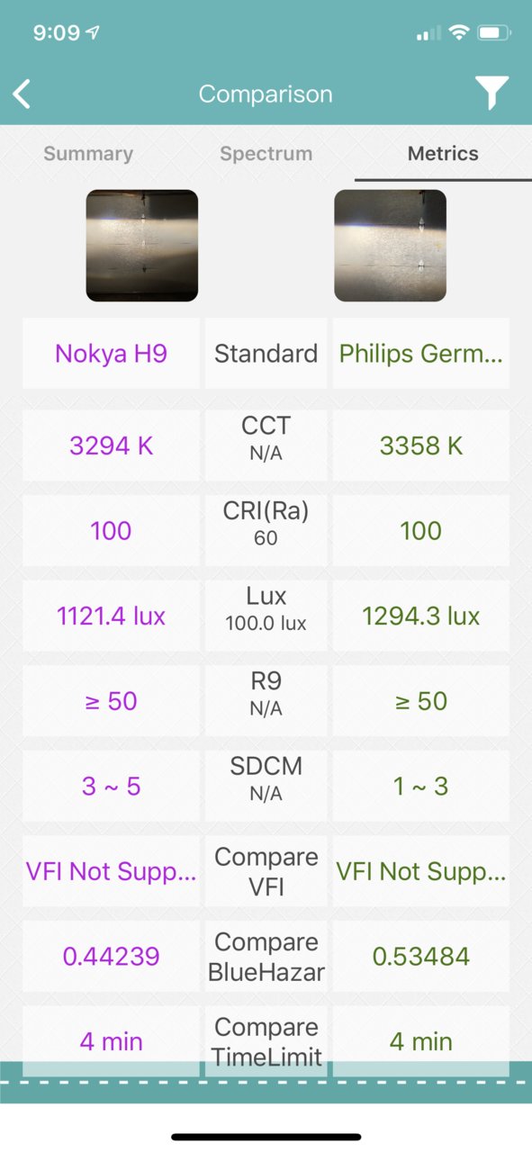

    Nokya H9 output vs Philips H9
    The Philips bulbs draw more power, have better focus and produce higher output intensity with slighting whiter light than the Nokya H9s, while also being cheaper. It is also worth noting that the Nokya H9 metal collar tabs are more challenging to mount in the 3rd Gen low beam socket than the Philips H9s.

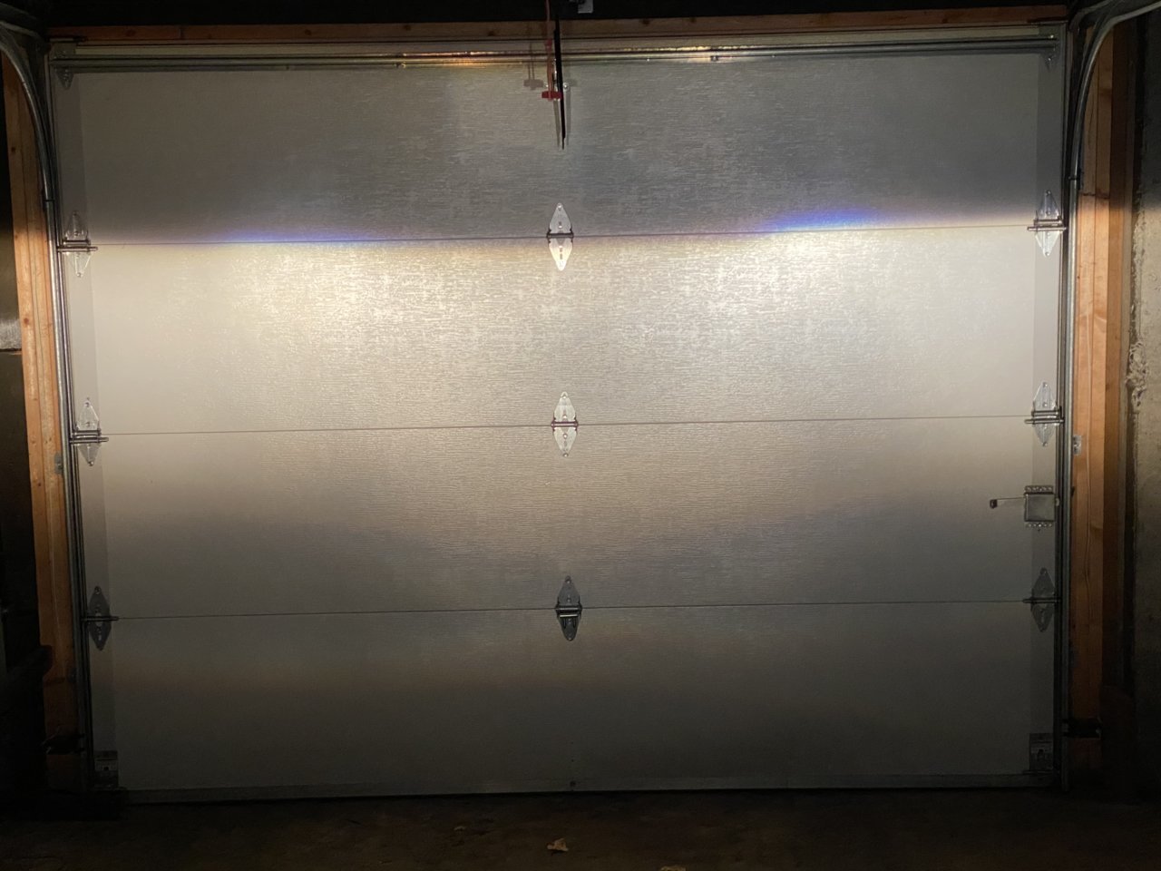

    HIDs are not recommended. The halogen projectors are designed to have uplight for overhead street signs, designed based on halogen output. By putting drastically higher output HIDs in the halogen projector, that uplight is massively magnified as significant glare to oncoming drivers. If you look at the original post the rebased Philips bulbs by Xenon Depot are significantly higher in output than their house brand bulbs that are supposed to be copies of the Philips product, which they advertise as about 'equivalent' (they are not). However, their ballasts were inconsistent in output and slightly overdriven, possibly to make up for the lower output house bulbs. There are no legitimate makers of HID products for halogen based lights. If you really want HID the appropriate thing to do is a full HID D2S projector retrofit to run proper D2S HID capsules from real lighting manufactures, and OEM grade ballasts that will actually meet their output spec.
    While the projector headlights have an internal light shield to minimize uplight, open reflector fogs do not. Putting HIDs in the fogs is the most egregious, asinine and dangerous lighting mods possible. The horrific amounts of glare to oncoming drivers is exceptionally dangerous and illegal. Unlike a reflector headlight, there is no glare cap in the lighting assembly, meaning oncoming drivers are in direct view of an uncovered ultra high output HID bulb. Under no circumstance should an HID be run in the fogs. If you want the highest output SAE fogs on the market, check out Diode Dynamics SS3.
    While the HID vs LED experiment was interesting to put an end to the focus and performance debate, HIDs are not a product that should be run in a halogen assembly. They should only be run in an HID assembly with the appropriate optics and cut offs. As such I have no intention of further testing any halogen replacement HID products.
