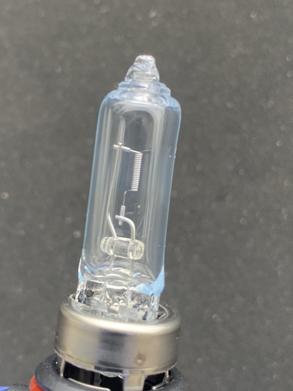

    Possibly the lightest blue tint I have ever seen? Hard to tell though, did you have anything blue near the bulb that could be casting a reflection?

    An HIR bulb doesn’t typically have a blue coating, it is an iridescent one to reflect IR light back to the filament to overdrive it for higher output without using more power. Typically has a slight rainbow look under a light. Not all HIR bulbs use an IR coating though, many have gone to more traditional methods to meet the output spec.

    I don't think there was anything blue when I took the picture. There was no blue coating on the bulb, it looks like a small hazy film on the glass just at the filament part. It didn't look like a "rainbow" either.

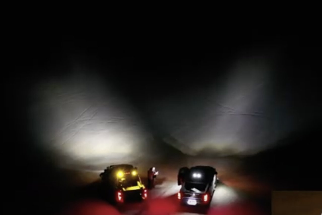

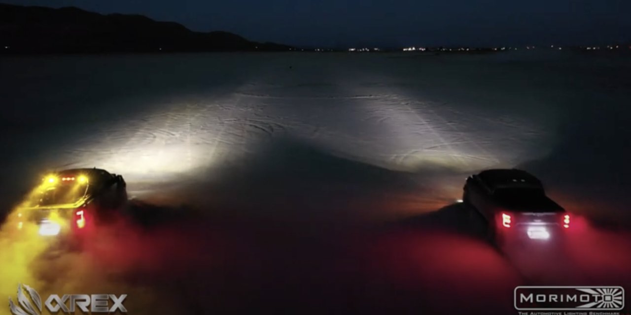

    Because the subject of excessive foreground light comes up so much, especially with switching to replacement LEDs in halogen projectors leading to increased foreground light and less distance light, I thought I would cross share this post comparing AlphaRex vs Morimoto on the topic:
