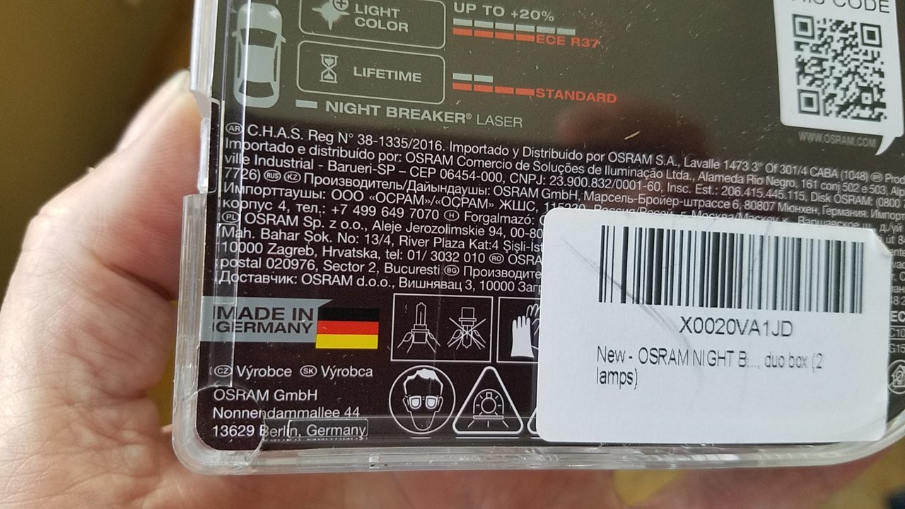

    So my bulbs just arrived today, and I was happy to see that both the Osram's and the Phillips I received were made in Germany. The harness did not arrive, but I am more inclined to trim the H9's to fit in the H11 spot now after reading more posts...
    Does anyone have any detailed pics on what/how to trim the H9's so they pit properly in the low beam spot?
    Heres some pics of the Nightbreakers and the Phillips H9's showing made in Germany...

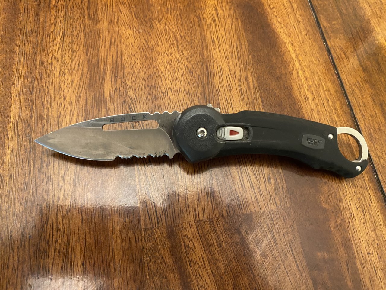

    How are you getting all the way down into the connector to trim the tab? Dremmel? File? Just curious the best method to remove the tab as clearly as possibly without damaging the actual connector terminals.

    #3271
    TheCochese
    TheCochese The Bronze T4R OG
    Apr 23, 2018
    #251472
    3,325
    Attempting to flee the south
    Cavalry Blue soccer machine
    Fine corinthian leather
    Xacto knife is ideal.
    You'll likely also have to trim the wide metal tab for it to fit in the housing. Tin snips, or a Dremel.

    I just use the small knife I carry. Takes only a minute to whittle it off. You’ll want to wear gloves to protect the bulb from oils on your skin, or clean it afterward with isopropyl alcohol.
