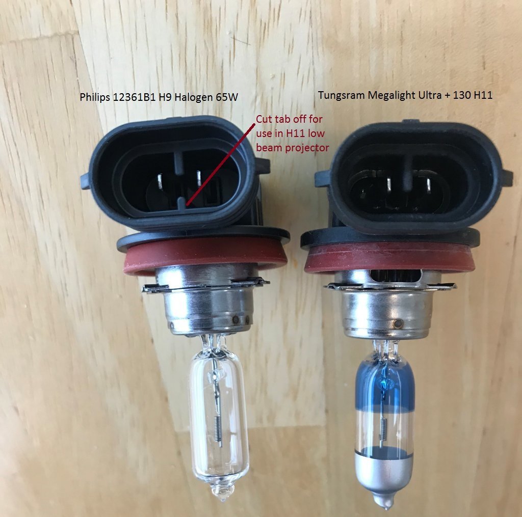

    Anxious to see if the glare cap on the new philips 150 is shorter than the GE/Tungsrams.

    The glare cap on the GE was the killer for me. Just not enough light to the sides (without also running fogs). The new Philips 150 cap looks to be nearly identical to that of the Philips 100. If that’s the case, and they’re even brighter, they’re gonna be a winner for sure.
    The GE glare caps rob a ton of light from the periphery in comparison to the Philips.

    They won’t in H9. The Racing Vision +150 have been available for years in other bulb types but not H11 and they are just now bringing the +150 Pro to H11. Seems unlikely we’ll see a GT200 in H11 anytime soon, but it would be nice to be wrong!
