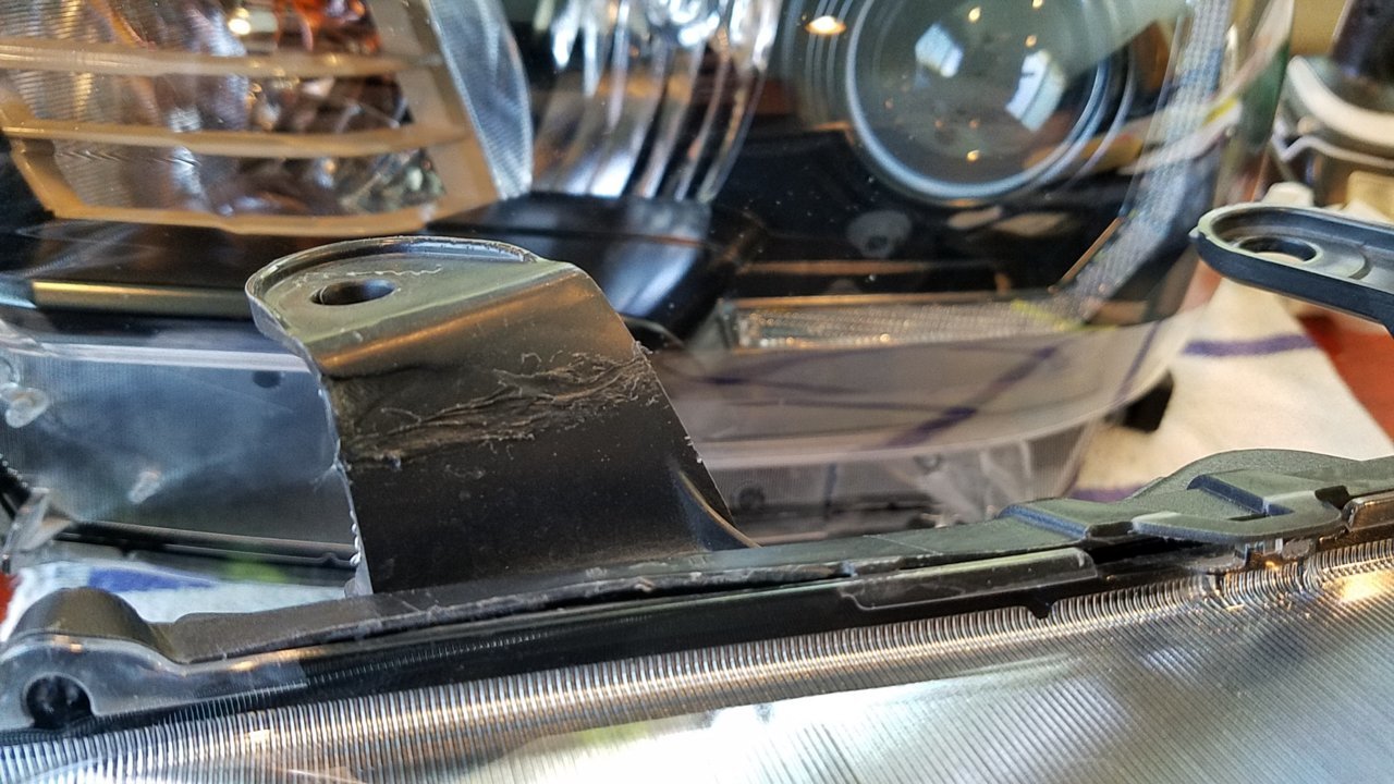

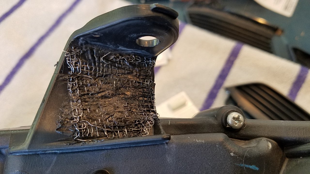

    I have, but you need a plastic welder to do it correctly.
    You can get a good plastic welder at Harbor freight for like $70.00 : You can get a cheap one for $17.00 that comes with screen and various plastic rods : It is a good idea to practice on some old parts of similar composition like an old car bumper for example because it is really easy to go too hot on the welder, and melt the rest of the tab in the process of trying to fix it, especially with the hot air ($70.00) plastic welder in the first link.
    I use aluminum screen material as reinforcement and just melt it in across the back/hidden side of the broken section to add additional support/strength. When done properly, the repaired section is stronger than the part was before it was broken because of the reinforcement.
    Here is a pic of the job partly done. When finished, the screen is almost completely melted into (submerged) into the part and it becomes bulletproof. I jsut failed to take pics of the finished product before I put the lights back on the truck.... This set of lights were shipped to me with a broken tab. The tab was broken completely off on this light.20200925_125606.jpg 20200925_125540.jpg

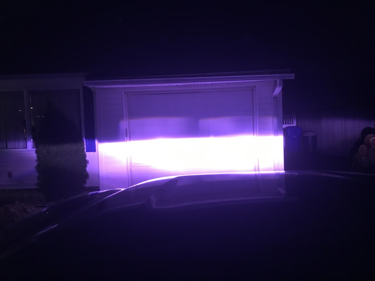

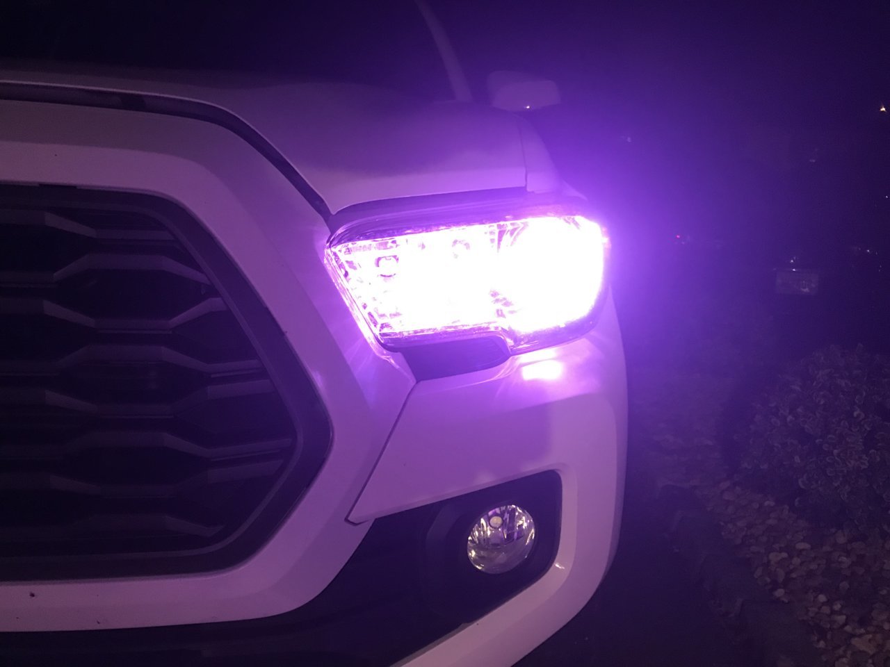

    So, I have HIDs in my 3rd gen projectors. I am currently running 6000k bulbs that came with the kit. For the winter I wanted to drop in some 3000k yellow bulbs. I bought some on Amazon and I have a feeling they sent the wrong ones.
    Purple.
    Question being, is it possible the bulbs are right and they SHOUKD be yellow and it’s my truck that’s the issue?
    I have the opt7 boltzen 35W ballasts. My 6000k lights are bang on though so I’m more leaning toward....they sent me purple ones.
    return already initiated and ordered a replacement set, just curious if anyone had a similar experience (I know about the green light, this is not green though).

    Notice those blocks of uplight above your cut off pattern? That is illegal blinding glare to oncoming drivers, caused by using HIDs in a projector meant for halogens. An HID projector does not have that issue.
    But to answer your question, bulb color is a function of the bulb, not ballast. They sent you the wrong ones.

    1. o_O today I learned. I’ve read the post before briefly but didn’t know it was that bad. Might nix the HIDs entirely then, there are yellow halogen low beams. I also haven’t secured the ballasts so they’re sort of bouncing around and a pain anyway. Thanks for the heads up.
    2. Glad I wasn’t doing something very dumb and somehow had yellow and thought it looked purple. It’s very purple and I don’t think I’m colorblind.
    it was groovy. But not the intention, it would probably make it worse in the snow.
