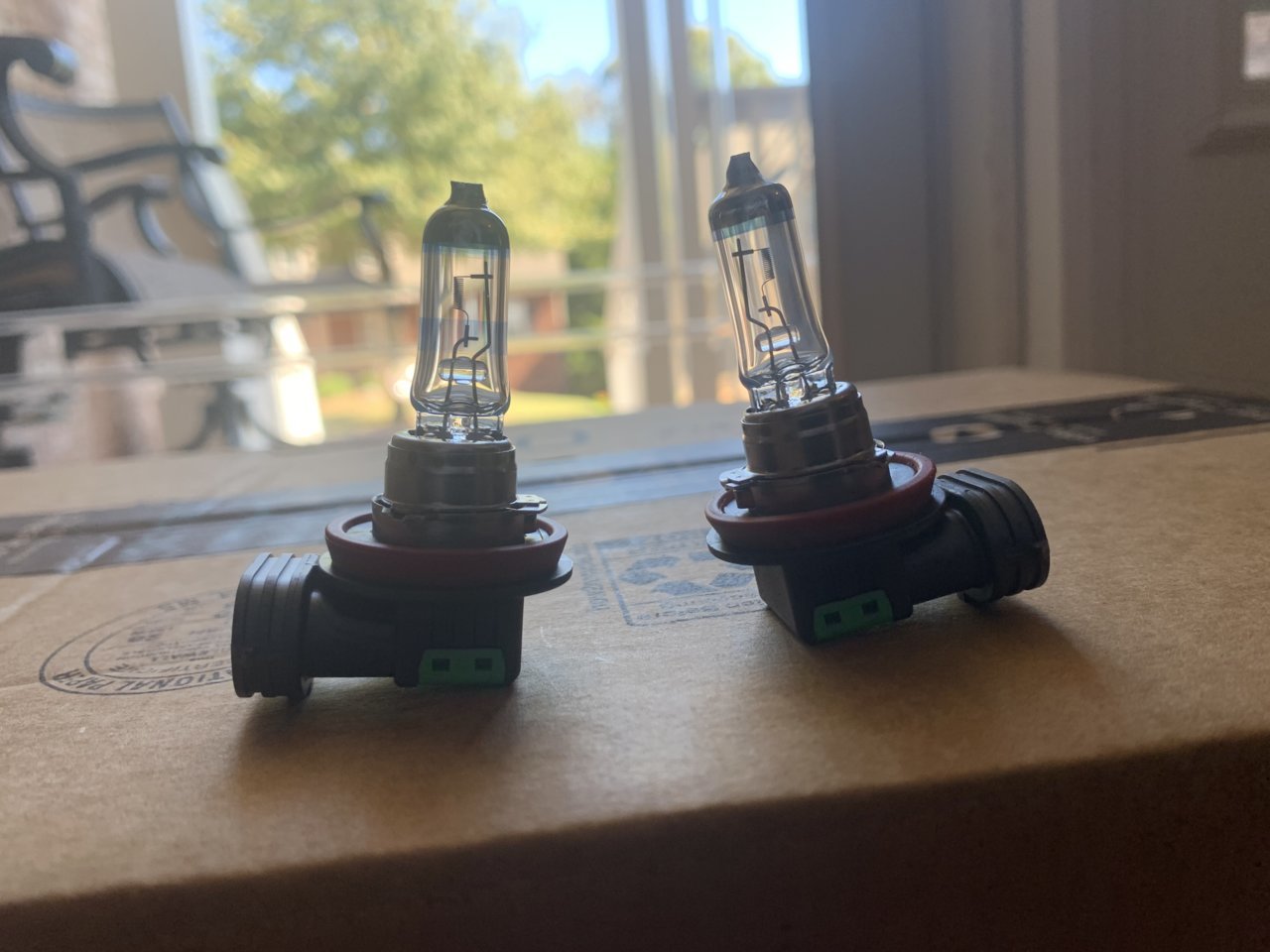

    Took less than a week to get these bad boys from the UK! Will install and report back my non-scientific impressions over the next few days!53C0CAB2-922A-42EE-87DA-E1FA7CE059B1.jpg

    G70
    Good Stuff! Mine are on the way. Currently running HIKARI Ultra LED. Looking forward to your review and looking forward to receiving mine.

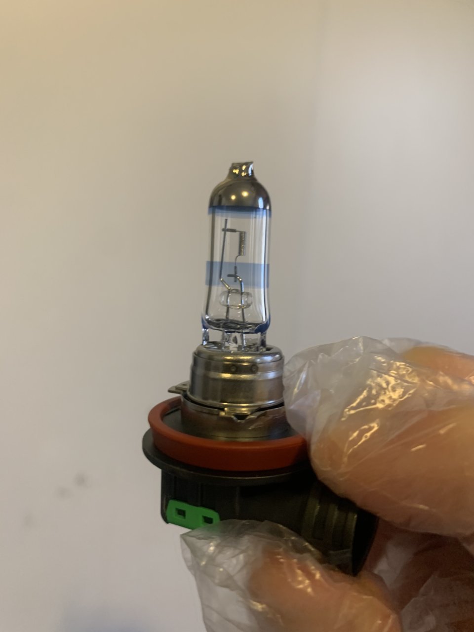

    Comparisons between the +100 Philips I’ve been a die hard fan of vs the new Pro150s. To me they look very similar aside from the narrow blue band in the center and a slightly larger glare cap...

    Is the blue band at the tip of the 100 darker than the 150?

    yes, it does appear a bit darker for sure. I’ve got my 3yr old who needs my attention tonight but will try to get some side by sides in the next couple of days to compare! Sounds like others here will soon have them as well including our resident mad scientist, Crash :)
    I still will be amazed if a 400hr light comes close to competing with some of the shorter lifespan bulbs but if this 400hr bulb outperforms the 300hr +100s that’s a nice upgrade in and of itself
