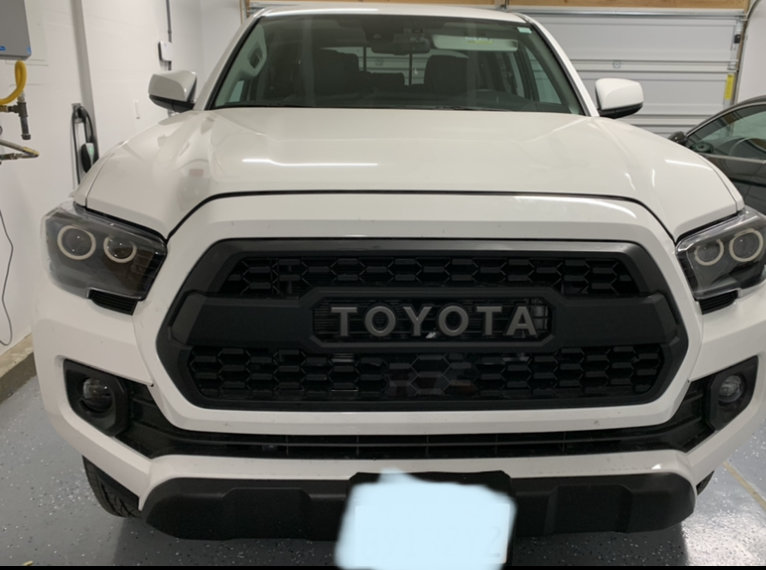

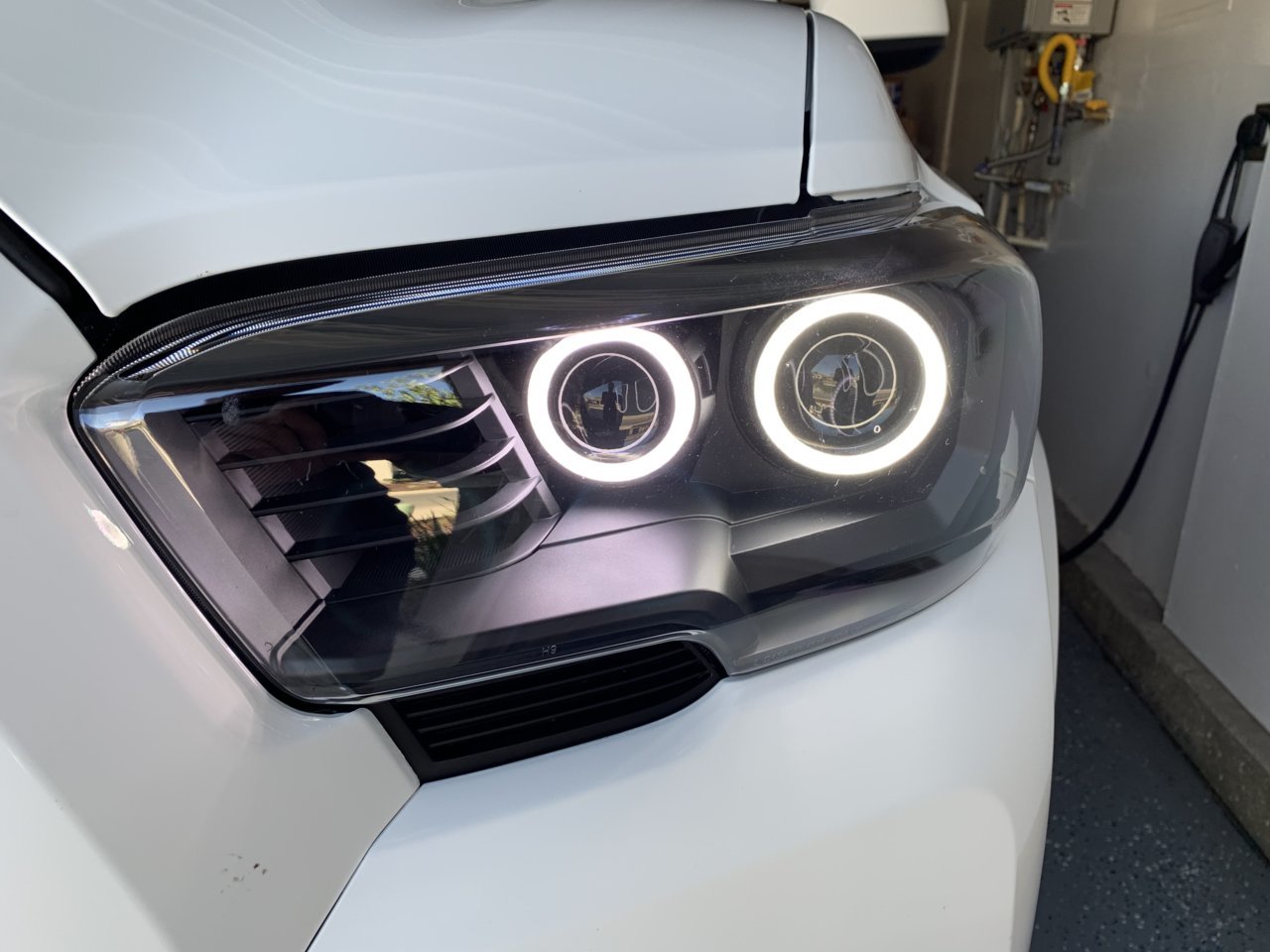

    I love halos.
    Pics just for you.

    Nice, this is the setup I just got done with.

    Gorgeous!
