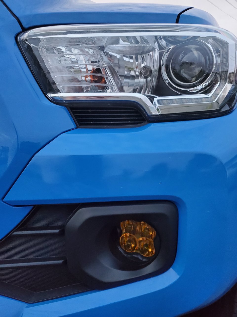

    I Replaced the factory H16/19W halogen bulb and chrome reflector fog lights. Tried to swap to a H11/55W yellow bulb but no go on the basic OEM fog assembly. Apparently you can on a US TRD Tacoma that has the better H11 halogen fog assembly. If you have the H16 fog assemblies I recommend going straight to The DDS3 sports in 2900K selective yellow and if you want to swap to white lenses to match the light bar you get a nice 3900K yellow when turned on. Fyi the white SS3 fogs are 5900K and both run 15 watts.

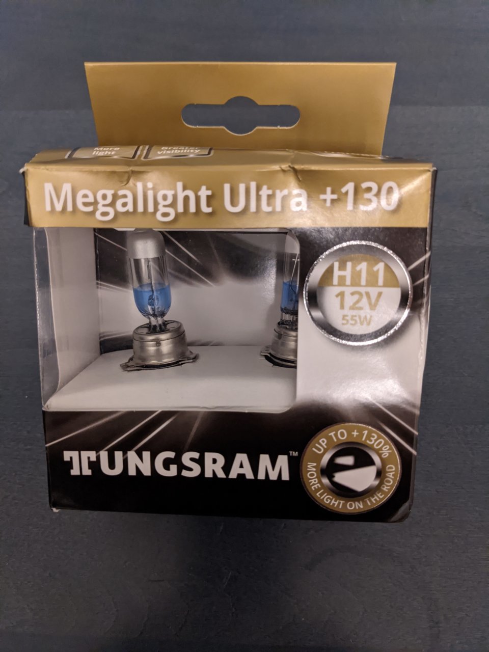

    My Tungsram headlight bulbs arrived. Less than 2 weeks via Ebay, shipped from Great Britain via post. Hope to get them installed later today.

    Bought the same bulbs but ordered 2 sets, 1 set are installed and the other 2 bulbs for backup. Mine came via ebay/Germany. I did not want to wait for another set to ship from overseas. Not sure how long they will last since the run brighter. Very easy to change.

    That's actually a sound plan, I should have done the same. I'll just tuck the OEM bulbs away for now as less desirable backups. I'm hoping to be able to find the Tungsram stuff locally at some point...

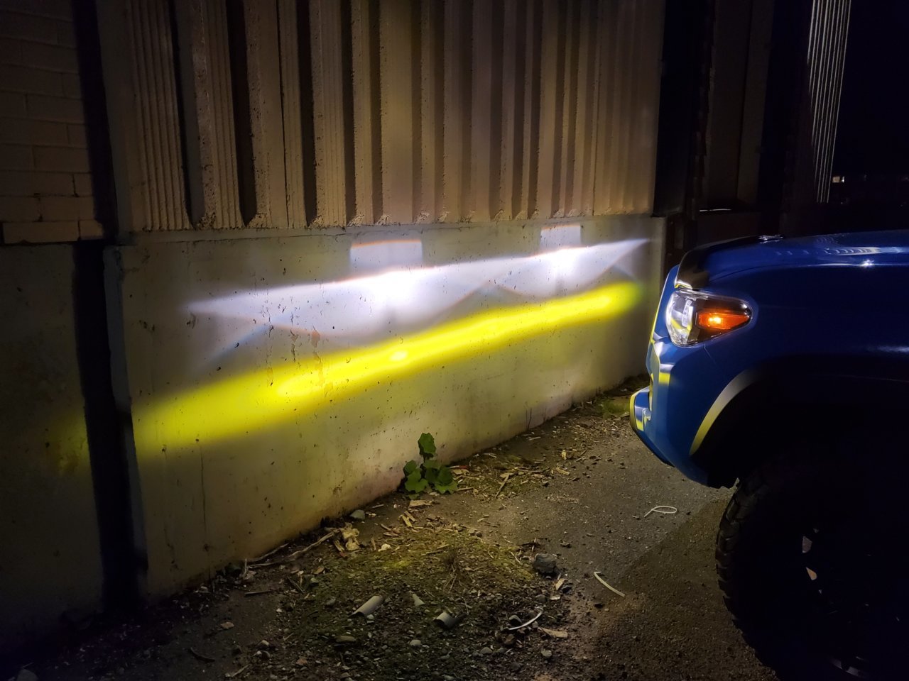

    Here is a picture of the light pattern against a wall. Hoping they are not pointed upwards.
    Diode Dynamics SS3 sports and Tungsram Megalight Ultra +130

    Looks decent from the picture, you can measure the top of your fog and the top of your fog beam cutoff and verify the top of the beam is lower indicating they are not aimed upward.

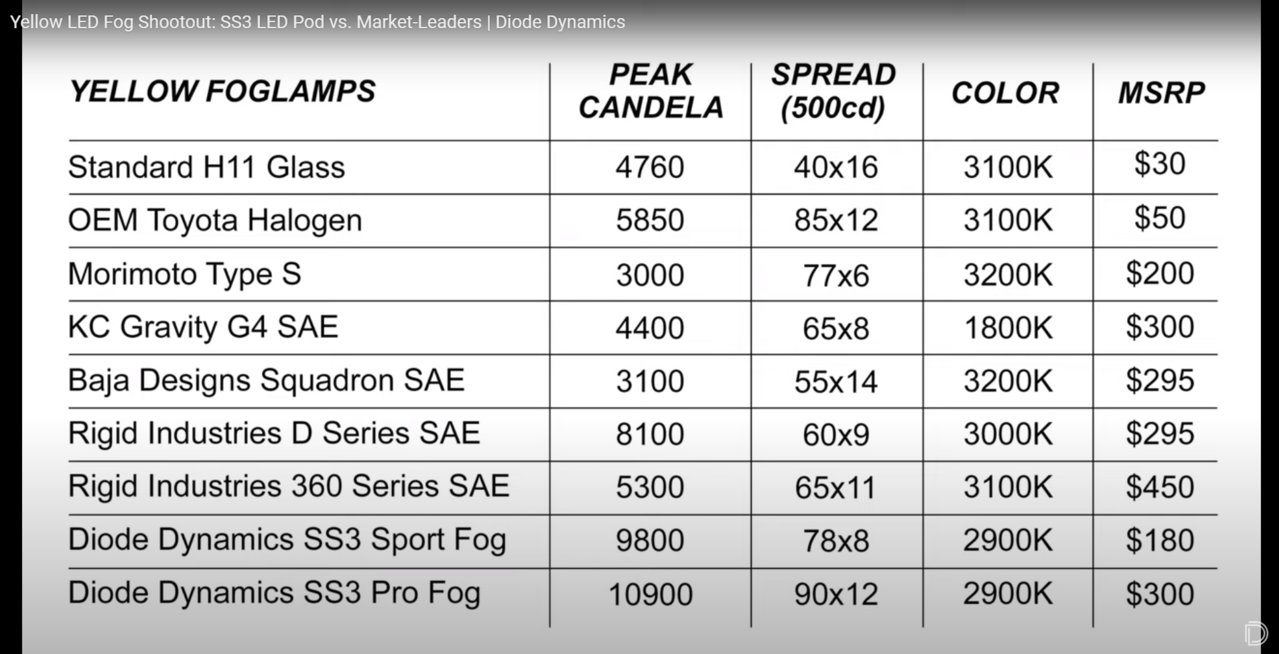

    All the posts cover color temp, in post #3 comparing the halogens there is a comparison color temp chart. If you were looking for a more yellow light though, you might consider the Hella Extreme Yellow 2900k H11s or Nokya's 2500k H9s. There are not really any performance options in yellow, so your best bet is a yellow H9, though Nokya's 2500k coating will be darker than Hellas 2900k coating.

    I saw the temp color charts, but didn't know if you had any sort of: "I tried 3 different yellows today" or something.
    Thank you! Yeah, I'm leaning toward the Hella's. They get yellow from a film over the regular bulb so the "deeper" yellow (2500k) is just a thicker film. I think.
