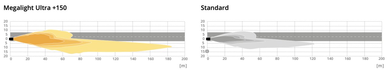

    Saw those on ebay also, a little more money than the +130's. The small lower right picture makes an example look 4x to 5x more light vs 150%.

    They will only be an incremental improvement at best over the +130, TBD. I wouldn't put any stock in that graphic. Here is an output chart from the +150 product brochure.
