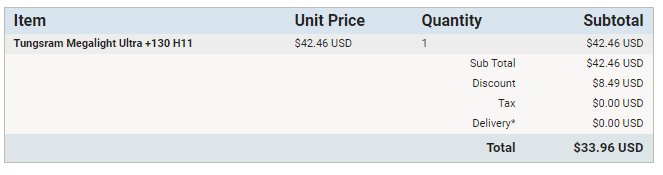

    Not trying to pick a fight, but perhaps you aren't factoring the powerbulbs discount or you consider that unfair to consider? They have a banner for 20% off through the month of October, right on their home page. It seems very much like their regular prices are MSRP - 20%.
    I'd give you nearly 1.5x for sure but nearly double feels a bit like hyperbole to me unless the powerbulbs discount becomes something which is difficult to get? Shipping seemed fast too (for me).
    The +130 is a whiter light due to the blue coating, more LED-like than the yellower H9. I believe it is also 55w vs 65w for the H9 which might translate into pennies in gas which could add up? Really hard to do the math on that one.
    I've run them side by side in L and R sides and the only thing I notice is the color of the light, I can't tell any difference in terms of real world performance. With all that said, I'm a fan of H9's too, definitely not trying to sound anti-H9.
    Below are my orders for bulbs from June 2020.
    Tungsram +130 order (one pair == 2 bulbs) comes to 16.98/bulb
    Philips H9 order (two pair == 4 bulbs) comes to $12.01/bulb
