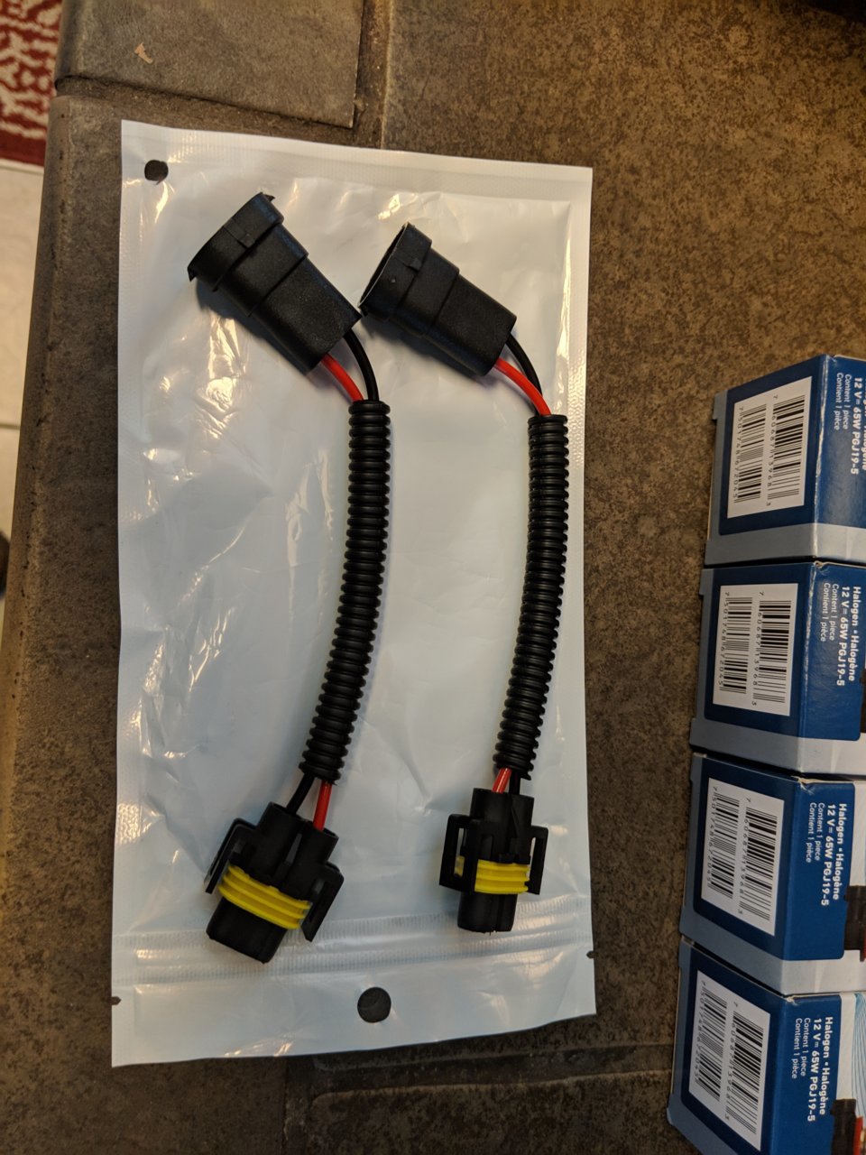

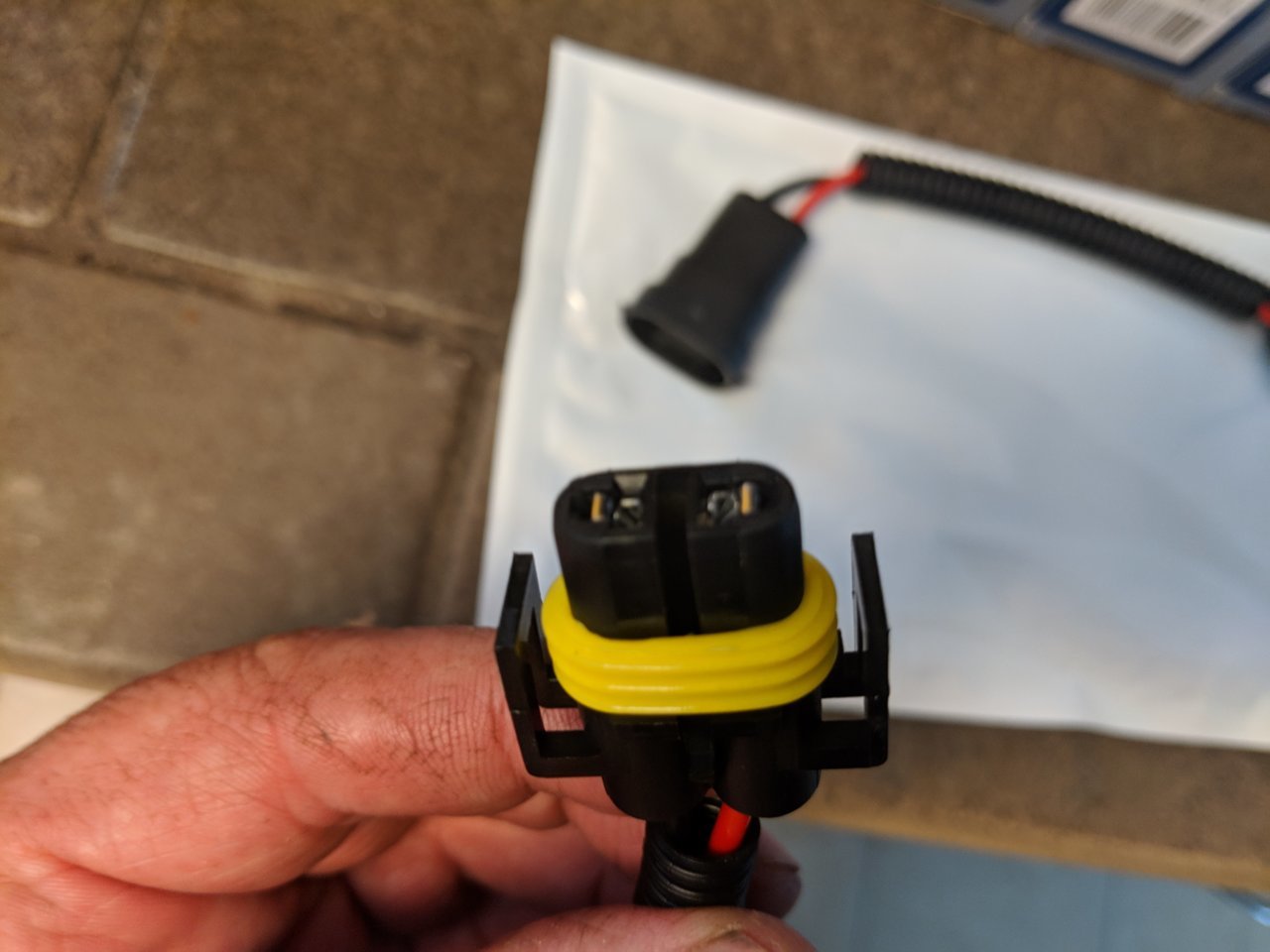

    Arrived. So. Boxed Bulbs. Took the harness and cut a notch for the bulb. That way you never have to notch the bulb again. installed all 4. Waiting for dark. I can already tell there is going to be an improvement. No glare caps and no bulb coatings.
