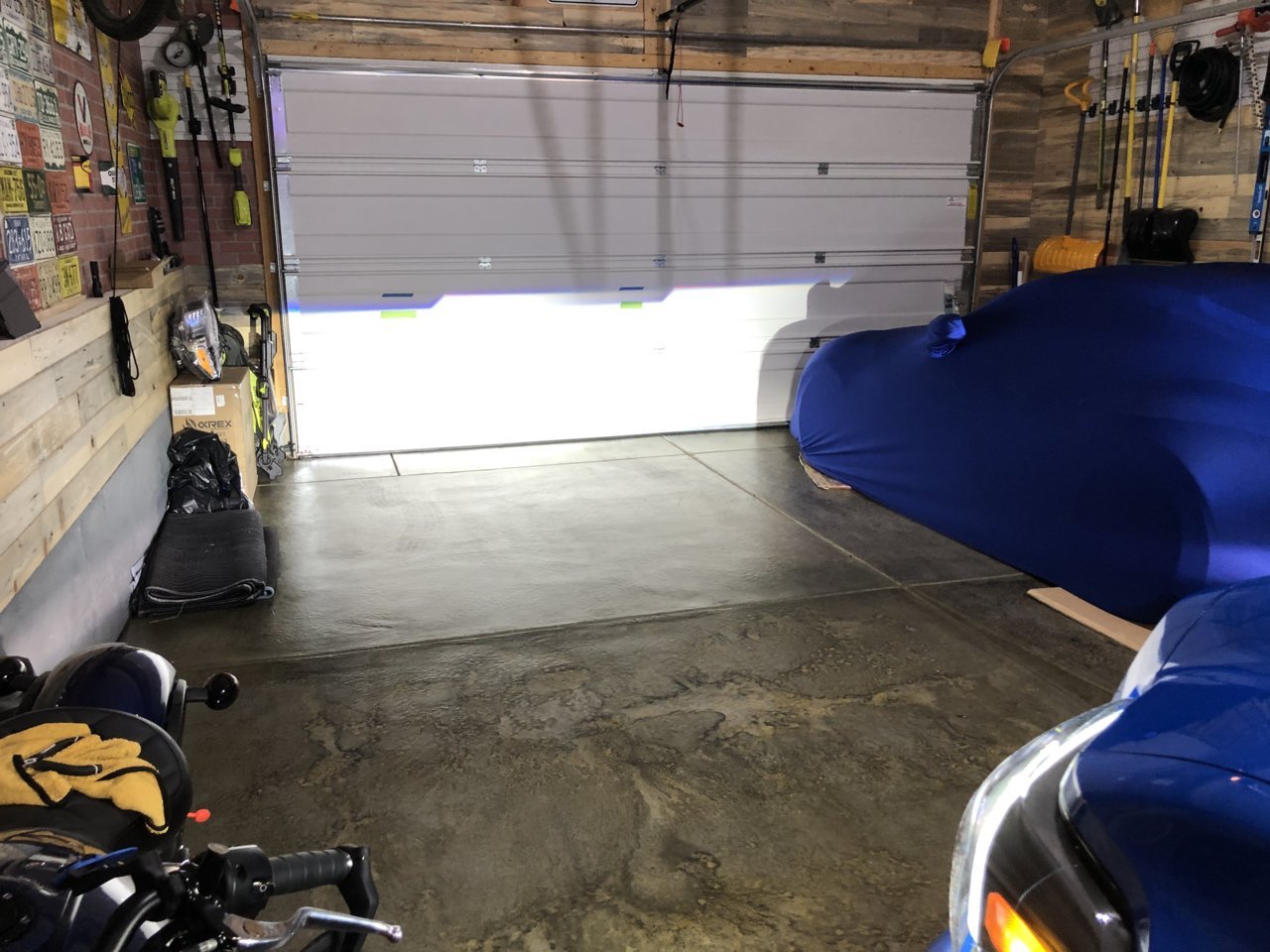

    I disagree...installed the Nova today, different light output from oem 2021 halogens to alpharex led

    Did you read the post crash linked to?
    If so, could you clarify exactly what you are disagreeing with?

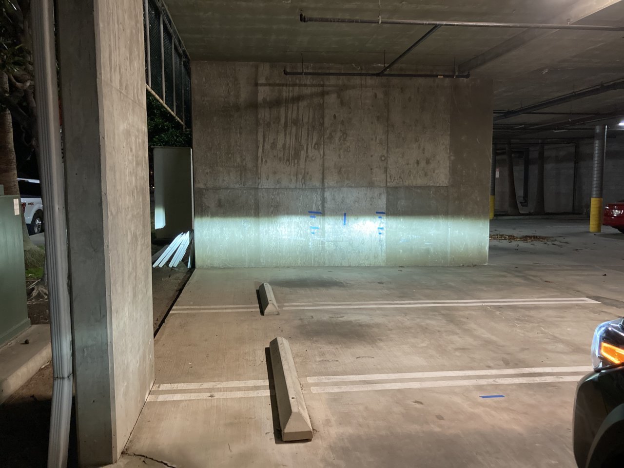

    Your photos, to my untrained eye, appear to back up the “excessive foreground light” problem with AlphaRex. This is easiest to observe on the far right side where your other vehicle blocks much of the light but you see more spill lower down than near the cutoff.
    For reference, this is what my OEM LED’s look like.
  19. Nov 21, 2020 at 7:26 PM

    Your photos are too washed out to draw a conclusive conclusion but do appear to reinforce exactly what I was saying as to why those are not a legitimate headlight. Peak beam intensity is supposed to be right up at the cut off, and reduced down through the beam just like your stock lights. High output intensity low in the beam pattern leads to a flood light effect, increasing foreground light and reducing distance vision. This appears to be exactly what your photo shows and as @daveeasa points out with the shadows cast by the adjacent vehicle. What is often difficult to get past is brighter isn't better unless it is brighter in the right spot. The right spot is concentrated hot spots at the cut off, with a smooth blend reducing intensity down thought the pattern to minimize foreground light. Unfortunately humans naturally favor foreground light, so people instinctively favor 'the wrong light' because it makes them feel like they can see better, but what you want is a focused distance light to project further. Which means focused hot spots at the cut off and a smooth blended beam reducing in intensity lower in the pattern. If you have crazy high foreground light low in the pattern as appears to be shown in your photo, that is exactly what makes an illegitimate poor performing headlight.

    The LED fogs are on as well. In the coming weeks, as I move cars around, I’ll compare this photo to the light output from the Supra, which are factory LED, the light dispersion top to bottom is nearly identical.
    of note, fogs were on with halogen picture as well.
    I just disagree with your claim that they are illegitimate. I find them of high quality, excellent visibility for driving, and saw clearly at night just now. And I live in the sticks out of town. I’ve had Benz LED, BMW LED, the Supra LED, and even Jeep LED, all those were OEM. These Alpharex out perform the Benz and Jeep by far, and are comparable to the M2 and Supra for night visibility.
    So, I’ll continue to disagree with your hard lined protests against them, my review is that they are an excellent option. I’m thrilled with them, as I’m sure you’re thrilled with what you have.
