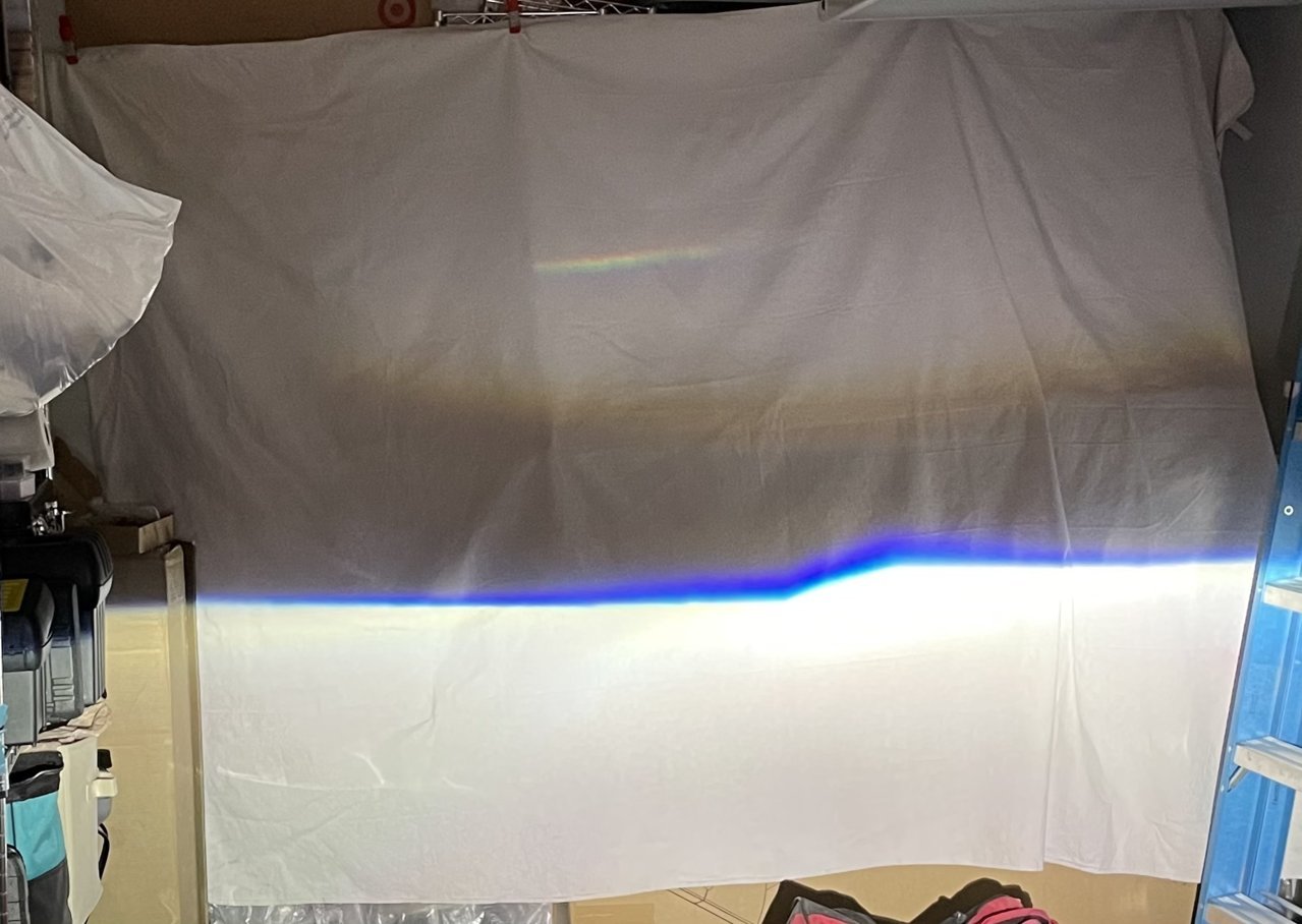

    As reference I’m working on a set of RX350 retrofits. Here’s just the left projector with a 5500k bulb. The headlights aren’t actually installed so it’s tough to get an accurate height representation. But you can see the hot spot near the cutoff and the light diminishes evenly as it gets lower.
    The Alpharex are just bright everywhere and have no hotspot near the cutoff. Hence the fore-light flood light nomenclature.
    crashnburn80[OP] likes this.
