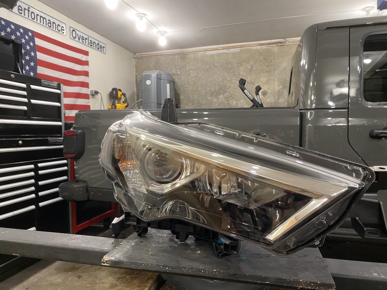

    Something new dropped off by @Spike Spiegel today.
    Also, thanks for the beers! :cheers:

    Cheers good sir. Knock yourself out with the headlights. It'll be awesome to have numbers in the fine print for us foreigners in 4Runners lol.

    Halogen. The 4runner uses very odd side entry projectors. While I don't expect anything too exciting in the halogen test results, what will be extremely interesting is to see how using an LED affects performance, since it will have the LED blade partially obstructing the projector bowl unlike the normal rear entry projectors where the LED blade does not obstruct light output.
