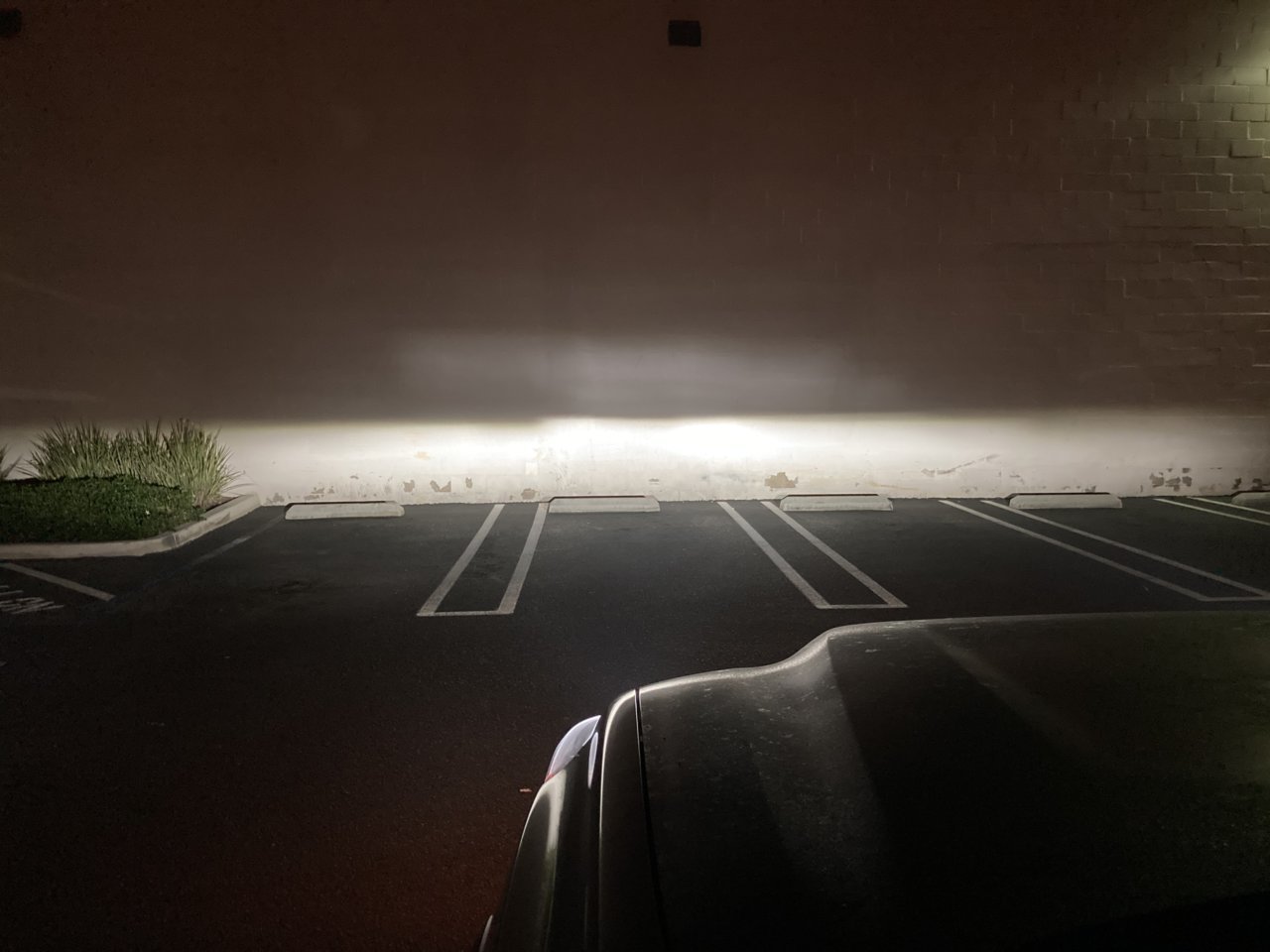

    Harder to take a picture than to see when driving. Also more apparent at moderate distance. The left side has a more apparent step-off while the right is more of a gentle curve. I took this at lower exposure to try to illustrate it.

    That is a quality shot, nicely done. Photographing headlight output can be tricky. I’d say that is intended for the reasons discussed earlier.
    I was just reevaluating the Gladiator LED lights, and the step actually occurs on both sides. The cut off is nowhere as good as Toyota. I think in the Gladiator case it is just a crappy pattern design. I really haven’t driven much with it at night working from home now.

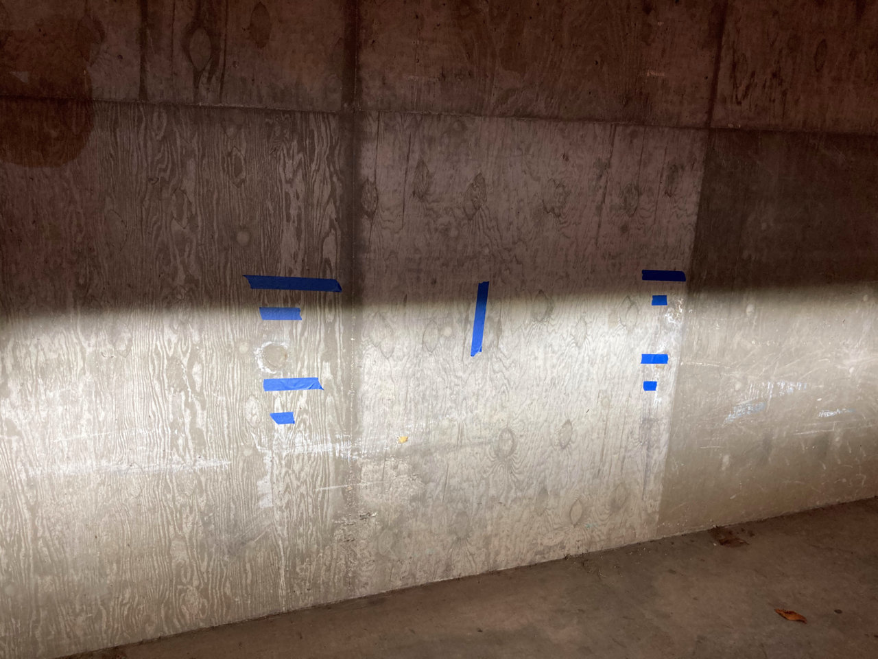

    So when following Stern’s aiming guidelines, we would pretend the notch doesn’t exist? And go off height of hot spot?

    Correct. Otherwise your hot spot would end up above the beam cut off guideline.

    I know you've posted these photos but I don't recall a ton of description on what you actually did in terms of playing with them What adjustments did you end up making? I've been driving with mine for a few months now and with the shorter days I'm finally driving in the dark with some regularity. Maybe I'm asking too much for distance out of these lamps, but I'm finding wanting more distance throw, so I'm wondering if I need to aim up, but of course the risk of blinding other motorists in play (and I've got high beams and a 30" bar if I need OMG light). The actual light output is excellent, but maybe I've got a bad perspective on what I can get out of these.

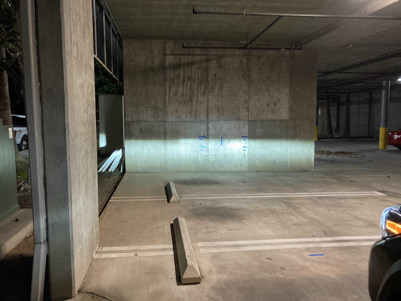

    Photo from the location where I noticed the notch. Thanks for bringing it to my attention. It’s comforting to know it’s an expected feature vs something I messed up on with the install.
    Distance is more than 25 feet, rough estimate of 30-40 range and slight uphill.

    Solid investment on those lights. That is a great pattern that checks all the boxes.

    I know what you're thinking. "Did he fire six shots or only five?" Well, to tell you the truth, in all this excitement I kind of lost track myself. But being as this is a .44 Magnum, the most powerful handgun in the world, and would blow your head clean off, you've got to ask yourself one question: "Do I feel lucky?" Well, do ya, punk?
    So, I apologize in advance but I did not document the number of clicks on each side. If I had, I would probably hesitate to share them as I suspect they aren’t perfect.
    I also didn’t use blue painters tape for the install and put the driver side inside the metal vs outside the first time. So I have a bigger scratch than yours.
    I want to redo the alignment. Perhaps if I do so I can count the clicks from max down angle? Still not sure I know what I’m doing though.
    TLDR: I followed the Daniel Stern article on headlight and fog light alignment and assumed the configuration of downward trajectory is based on headlight height from the ground since it makes sense to have lower vehicles with less downward angle and higher vehicles with more. IIRC that boiled down to the cutoff at 39” above grade from 25’ away for the headlights. I forget the fog light number but the cutoffs there aren’t as tight and adjustment isn’t as controlled.

    I emphasize this all the time. The easiest way by far for alignment is to install one light at a time, then match the alignment of the existing OEM light. Then swap the 2nd light and match the alignment of the already aligned light. Takes all the guess work out and doesn't even require a level surface. Starting from scratch with 2 new lights installed is far more difficult to dial in the aim.

    Let me rephrase. Compared to how they were aimed as-installed, did you go up or down in terms of the cutoff? I'm curious if out of the box they're aimed high or low relative to what I'm seeing on the truck unaimed. Or did you ultimately not drive the truck at night without them aimed.

    Yes, agreed, provided you trust the existing lights. Which I didn’t since I bought used. The Stern article indicates that manufacturers aren’t required to align headlights nor are dealers. I don’t trust the minivan either, though I haven’t touched the headlight alignment and we bought that new. And of course things change based on payload, tire pressure, suspension, etc.
    Auto leveling headlights sound like a fantastic solution. Even better would be terrain auto adjustment on the fly.
    So the Dirty Harry quote was intentional. I simply don’t remember in all the excitement. I fidgeted with the adjustment trying to find the best screwdriver. Then I did the alignment. I should have paid more attention to whether I went up or down. Instead I was in Dirty Harry mode.
