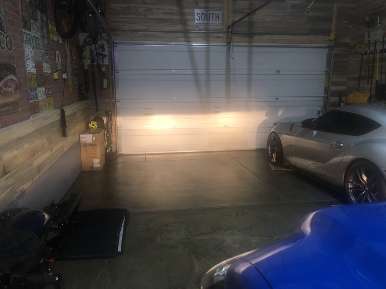

    IS THAT A SUPRA

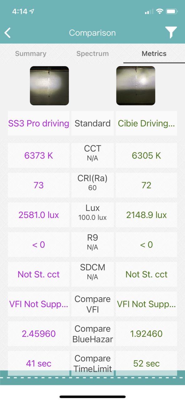

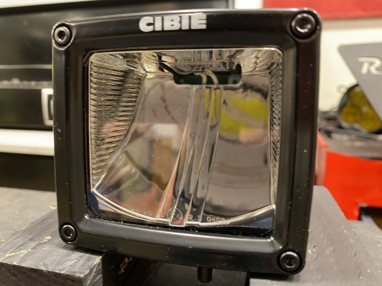

    A bit of a teaser post on the Valeo/Cibie/PIAA J581 aux high beam pods
    These pods are manufactured by Valeo, the same lighting manufacture as the Toyota Tacoma fogs, both LED and halogen. Valeo owns portions of both Cibie and PIAAs parent company, making sense why they are marketed under these other labels. These pods use 2 down firing LEDs into a sloped reflector, just like the OEM Toyota LED high beam headlights, which is an extremely efficient and performant design.
    The pattern offers a very large area coverage with a very smooth beam distribution and a center focused hotspot for maximum distance projection. This pattern distribution is very different than other SAE J581 lights I've tested on the market and far more like what you'd see in an OEM application.
    Compared to the SAE J581 SS3 Pro, you can see this is a far more focused driving high beam. This similar style circular focus is what is found in KCs Pro6 lights as well. While it does offer higher intensity in the case of the Pros, you can see the area of coverage is smaller.
    By price point the SS3 Sports would be a more appropriate comparison. By spec the Cebie/PIAA lights are higher in intensity than the SS3 Sport Driving, but lower than the Pros. I had a Pro in driving handy so that is what I used for the comparison in this post. Measured output below.
    A more detailed analysis will follow in the upcoming SAE J581 thread, with a more appropriate comparison to the Sports. But I was pleasantly surprised at the unique element of performance that these pods bring to the table.

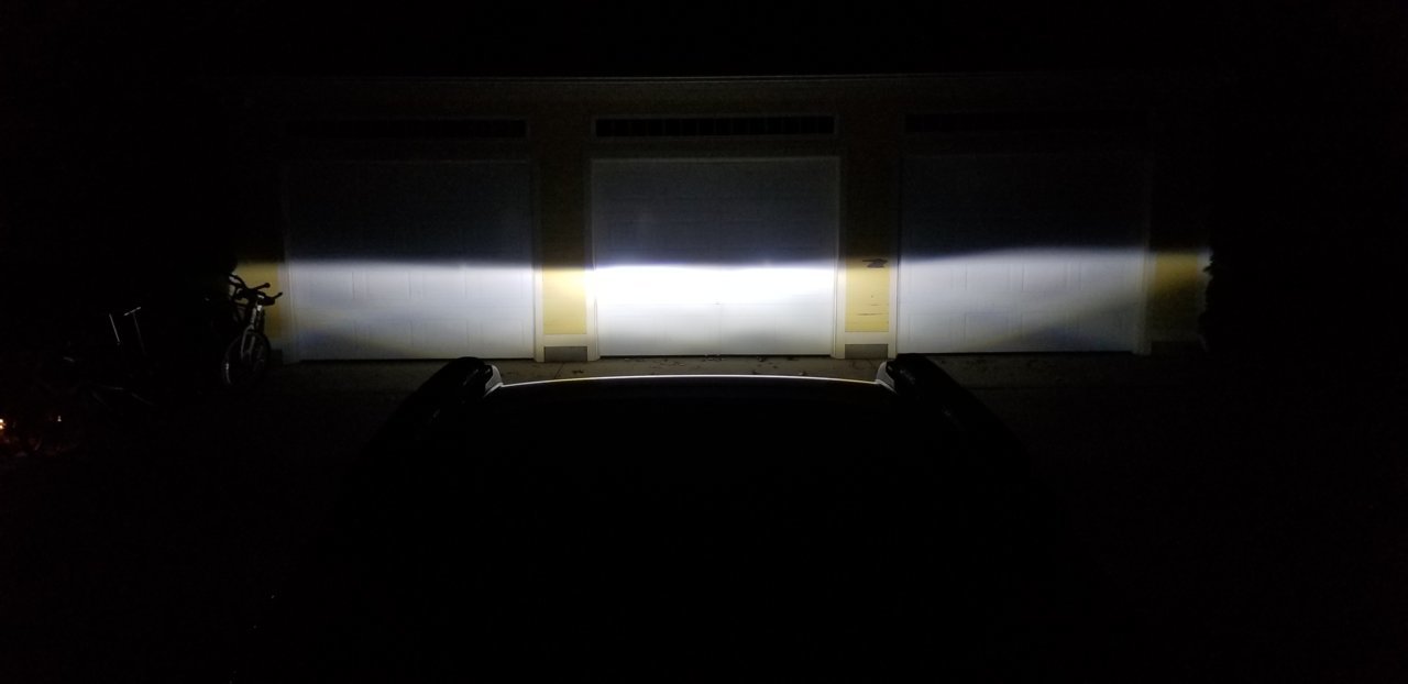

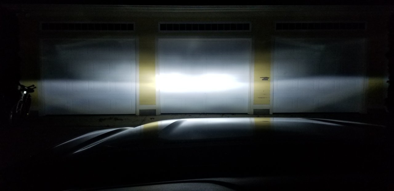

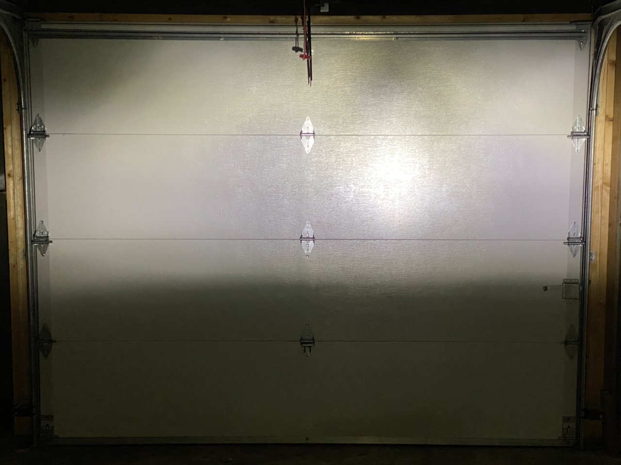

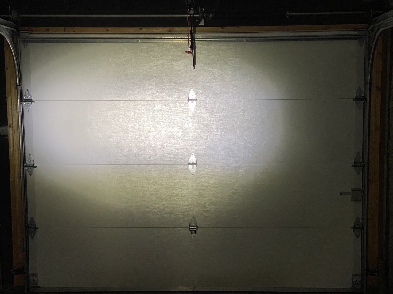

    I love my Hikari Ultras. Did both high and low beam for around $110 total shipped on the sale. Dropped right in. Great cutoff and pattern. I figured with free returns on Amazon 'till the end of Jan now I'll run them for a month or so no risk. So far no plans to return though.
    Low
    High

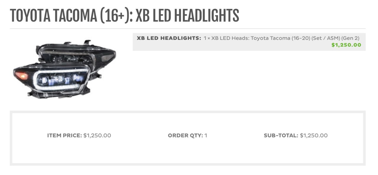

    The things I do for you guys. Gen2 coming soon:

    I want these to be better than the Gen 1, and I think they might perform slightly better... but at $1250, you can almost get OEM LEDs for that money.
    Edit: Just realized these won't even work for my Canadian truck as I can't turn off the DRLs... looks like OEM is my best bet.

    The Gen2 Morimotos should be interesting. I wouldn’t be surprised if peak low beam intensity surpasses OEM with the addition of a 3rd low beam projector. Curious on the high beam changes since the originals where quite poor. Hard to say though without measured data.

    That pricing shown above was before the full cart of lighting stuff and coupon codes, they were $1000 after all said and done from TRS, with free shipping.
    EDIT: Based on my experiences with that specific linked vendor, I would definitely not recommend them.
