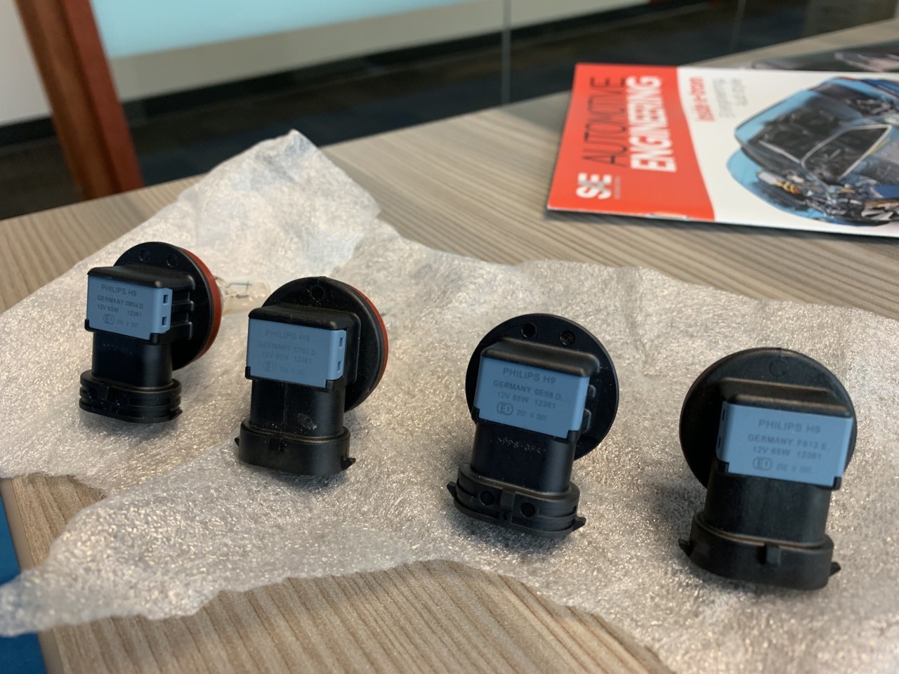

    I sometimes cannot stand eBay. I bought German Philips H9 Vision +30 bulbs out of the UK, the Vision series H9s are pretty hard to come by, and this is what showed up.
    No boxes, no official packaging. Loose bulbs wrapped in padded packaging in an unmarked box. I’ll test them this evening to see if they are the real deal and can challenge the output of the Hellas (Osram Hypers) and GE Megalights, but I’m not even certain I got the Vision bulbs or the standard bulbs. Annoyed.

    The Philips Vision H9s do not have a glare cap. Did you see some photo of this? You sure it wasn’t an H11?
    It depends on the connector used, the H11s have a larger single tab designed so that an H11 will not fit on an H9 plug.
    H11 left vs H9 right
