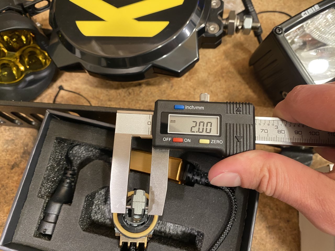

    These showed up today. Along with some other lighting candy.9D5194B1-E76D-4BB4-A4BE-E3B0B682568A.jpg

    Yes! Can't wait to see the results

    Those look pretty thin, thinnest I’ve seen from pictures...should be more on the right track.

    Confirmed accuracy of 2.0mm emitter face to emitter face width. Remarkably thin, far superior to the Hikaris 2.64mm width.
