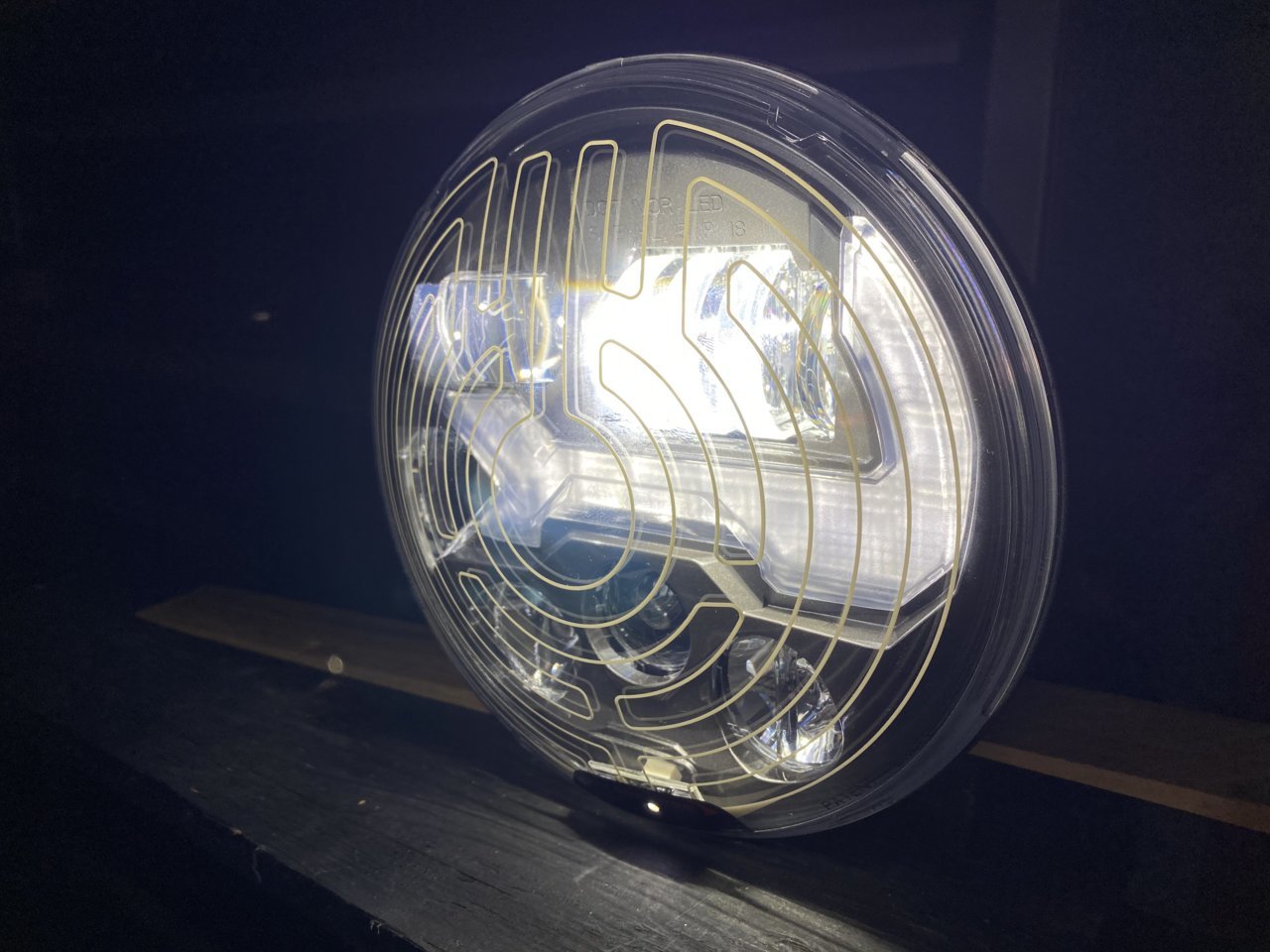

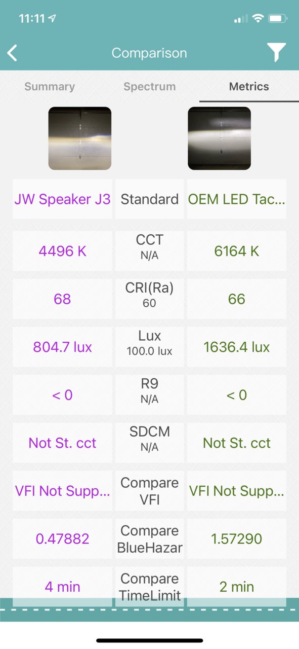

    This hurts. The heated JW Speaker J3. Color output and technology is amazing. Output intensity not so much.
    Ultra high end 7" LED headlight vs Tacoma OEM LED

    There is a lot going on in that assembly

    Multiple low beam projectors and multiple high beam projectors, DRL and signal, plus a dedicated off road use wide angle foreground light, lens heaters, blue tooth control for adjusting off road mode beam patterns and intensities, the lights can receive updates via bluetooth plus some other smartphone enabled features. So yeah, they definitely have a lot going on. Love the 4500k color, just wish output intensity was significantly better.

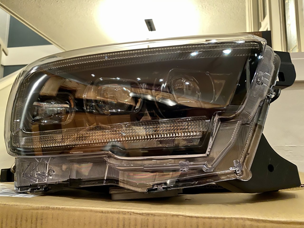

    Gen2
    My kitchen is starting to look more like a lighting products display room.

    Nah, that's a Morimoto XB LED headlight. @crashnburn80 tested them previously, but they just launched a Gen 2 with some improvements (or so we will find out)

    oh, i didnt realize it was coming out so soon. will be interesting to see if it will come anywhere close to oem

    I'm just guessing, but I think the low-beam output will be similar, but the XB's historically suck at high beam projection. Plus in The Retrofit Source's promo video, they mention "increased foreground light" which is something you don't want when it comes to distance projection. A lot of users on the site say they have the "brightest lights" but it's just because of more light being projected onto the road directly in front of the vehicle with no real distance projection. AlphaRex is notoriously bad for this.
    I'd rather have quantitative data than subjective data/qualitative data from various photos and people's eyes.

    Gen 2 Morimotos. The design uses 3 low beam projectors vs Gen 1s 2 low beam projectors. And rather than a single dedicated high beam projector, the Gen 2 runs two bi-projector high beams. Gen 2 claims improved performance over Gen 1. Morimoto said based on feedback they decided to improve the output. Curious who else pointed out the performance of Gen 1 needed improvement... I anticipate they targeted out performing the OEM LEDs, which were released after the original Gen 1s and took some of the appeal out of the Morimoto units, being OEM performed better. I ordered the first set of Gen2s once they were available, just like I did with Gen1.

    Yeah that foreground light comment is very concerning. The Gen1 had a good low beam, it would be a terrible decision to increase foreground light to “compete” with an illegitimate product like AlphaRex. This is what you get when youtubers do lighting reviews and point out how much brighter the foreground light looks, so the headlight with more perceived light (foreground) must be better.

    I’m betting on disappointing numbers from both Morimoto products, continuing a general theme of other recent product disappointments.

    Less certain on the XBs, but focus is the single most important factor in a replacement LED and the new Morimoto design looks more promising than anything else on the market. Of course, measured data is the real determining decider so TBD.
