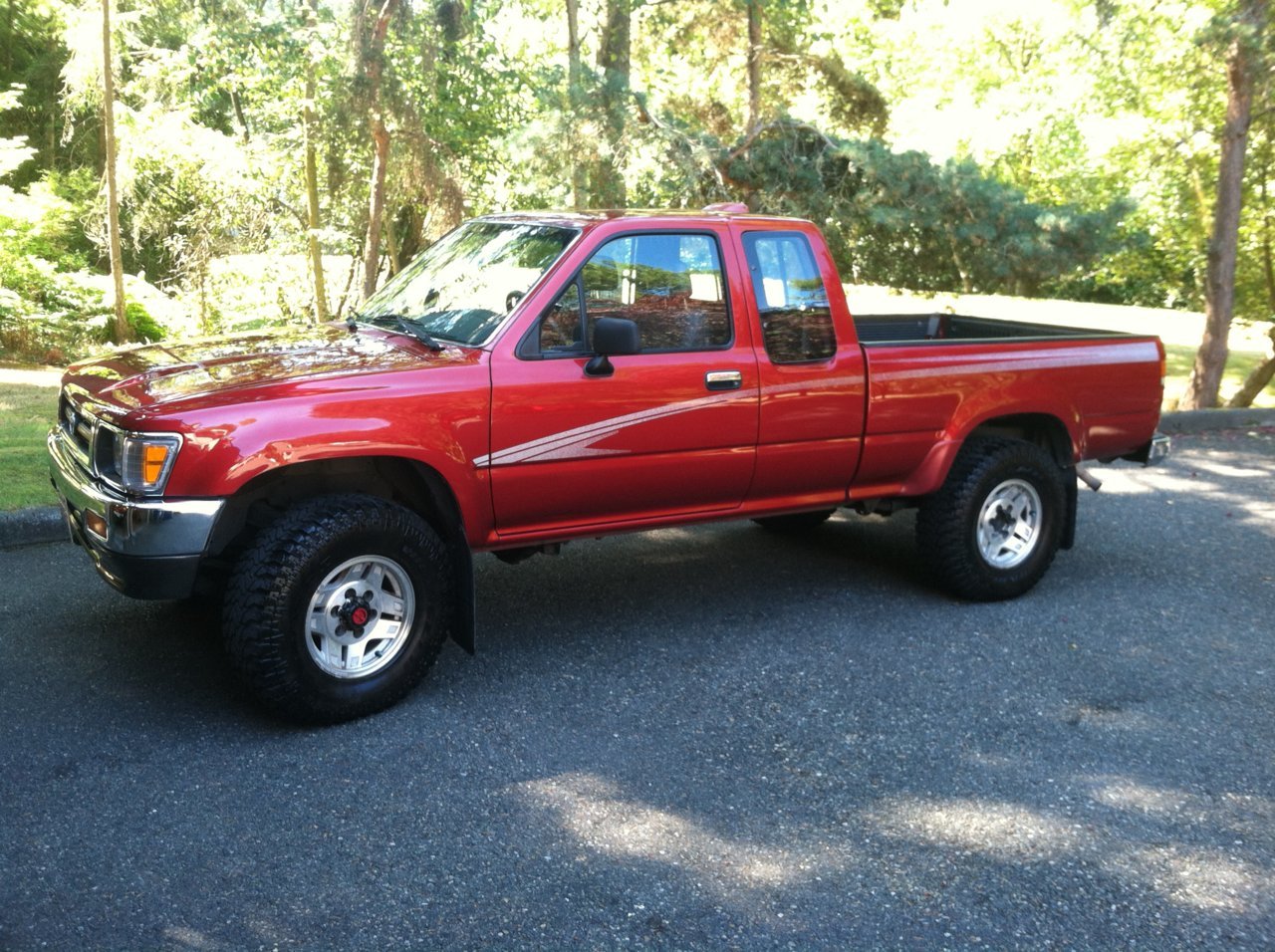

    Yes, though back in the days of my early 89 and 94 Toyota pickups I wasn't logging data for posterity. Recommended replacement for the 6054 is the Hella 200mm E-code ECE H4 conversion. These were superior in build quality, output intensity and durability than other brands I experimented with at the time. Output with the new assemblies will be a drastic upgrade with substantially more light on the ground and better cut offs. From there improve the output further by using bulbs recommended from the H4 headlight thread, such as the Tungsram Nighthawk Xenon +120, Philips Racing Vision +200 or the Osram Superbrights with standalone harness for extreme output. Note that the early Toyota trucks running 6054s/200mm lights use a ground switched electrical system, and require the ground switched harness linked in the headlight thread for use of high power bulbs, unlike the 2nd Gen which is power switched. All the info is covered in the thread.
    For fun here is the pic of my 94 running that upgrade. My avatar pic is from when I built a performance 22RE and was doing the swap on this truck.
