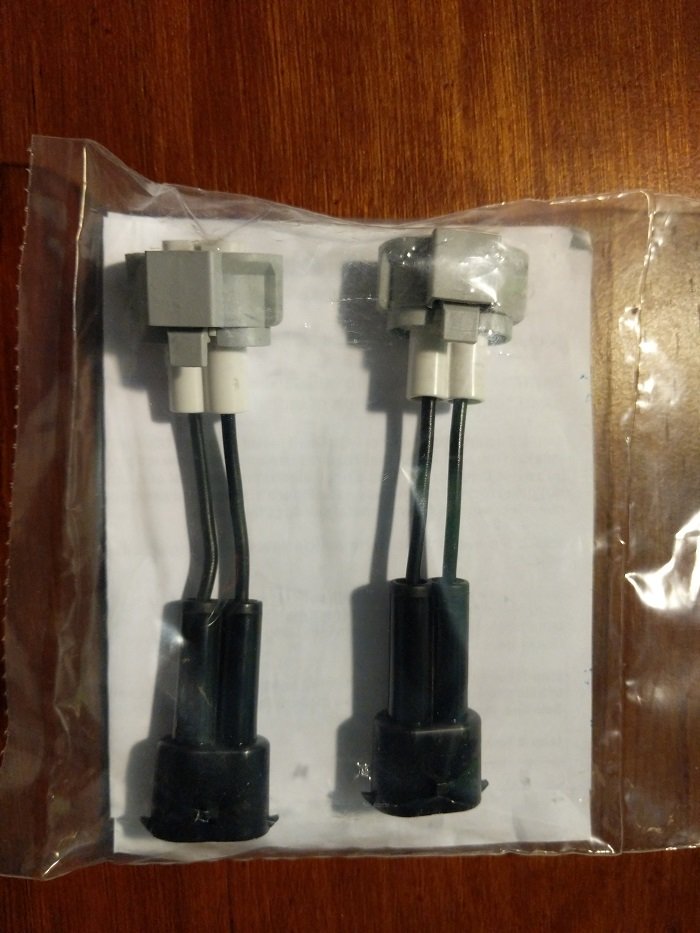

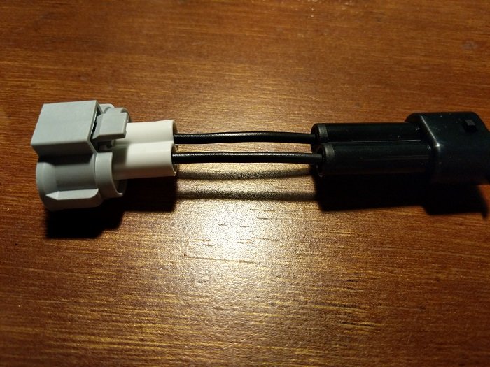

    I ordered a harness from Aspire after following @tclavell 's link. Didn't use it, however, since I became impatient waiting for the postal service to catch up and deliver it (delayed 4 days on top of the original 5 it was taking). Just trimmed the internal plastic tab on the bulbs instead.
    Will probably use it next time. Looks like an okay harness.

    Exactly the same reason I ordered the harness, ease of use. I'll keep the harness in the truck for when the time comes.

    I spent more on my harness and then didn’t use it. It was ok for the Tacoma but since I’m running H9’s in the minivan it’s so cramped that the harness adds unnecessary bulk. Once I improve my crimping skills I will try to make it shorter.
