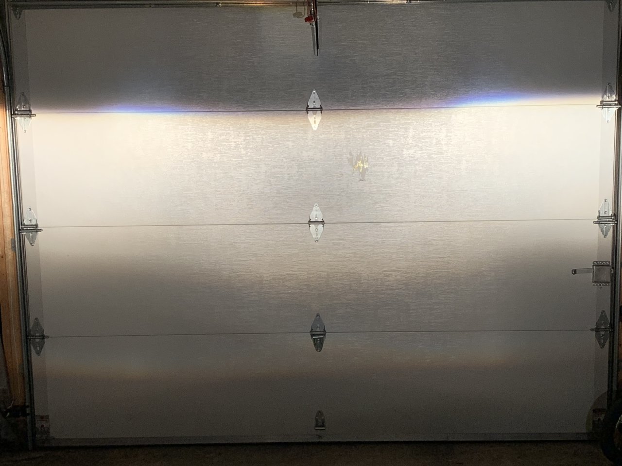

    This is so close.
    Hella (Osram Hyper +30) left vs Philips Vision +30 right:

    Philips Vision +30 is about 10% brighter than the Hellas at the hotspot.
    Philips (left) pulls more power at 74.7w compared to Hella (right) at 72.2w.
    The Philips bulbs typically go for ~$25/ea and must be purchased out of Europe. It can be difficult to find the real Vision +30 series bulbs vs the Standard series ones being sold as the Vision series. This also typically includes long slow shipping from overseas. I have not yet found a reputable source for Philips Vision H9s, I bought mine off eBay and they arrived without official product packaging.
    The Hellas are available domestically, from high quality sources at $10/ea with much quicker ship times. Compared to the Hellas the Philips are 2.5x the price for about a 10% increase in performance.
    Worth it? Up to you. I obsess over this stuff, so I’d pay more for the Philips, but it does start to reach a point of diminishing returns.

    Wow. 25 each. I'll stay with the Hellas . About 50 for Four shipped. Do the Phillips have as good of coverage as the Hellas ? That's one thing I really like about them. And thanks.

    Yes they do have as good of coverage. The very full beam pattern is due to utilizing an H9 bulb vs ultra high efficiency H11s, and both the Hellas (Osram Hyper) and Philips Vision are competing +30 H9s.
    The Philips bulbs are still manufactured in Germany vs the Hella Osram Hypers that have moved manufacturing of that bulb for Hella to Korea, which I bet in part was likely due to Hella's price point target vs Osram's manufacturing decisions. I still have 2 more performance H9 bulbs to test that I am waiting on, a Xencn (Osram China) H9 +100 and a Xencn 70w 'Off Road' H9. I honestly do not expect a Chinese manufactured product (even from a German parent company) to challenge an ultra high quality performance German manufactured one. But in the interest of the unbiased scientific process, I ordered them anyway to compare, so that I would literally have tested every single non-fully-coated performance H9 on the market that I could find, and my Google skills are beyond Sensei level.
    I expect the German made Philips Vision +30 H9s to be the best bulb on the market. But this really isn't surprising. Philips is one of the worlds largest most advanced and most experienced automotive lighting corperations and a high quality OEM supplier to many automotive manufactures including Ford. Philips is manufacturing their Vision performance lighting products in Germany, the country with a well established long history of building the best high precision automotive lighting products on the market. Philips outperforming the competition in building a performance H9 when the competition is either off shoring production to Asia or a startup status company with limited experience is no surprise.
