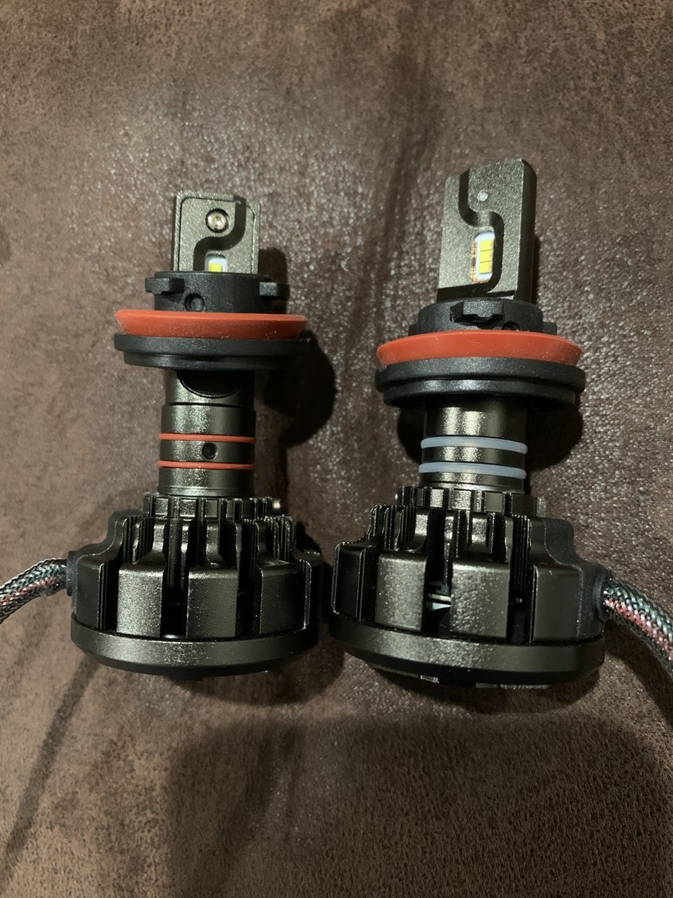

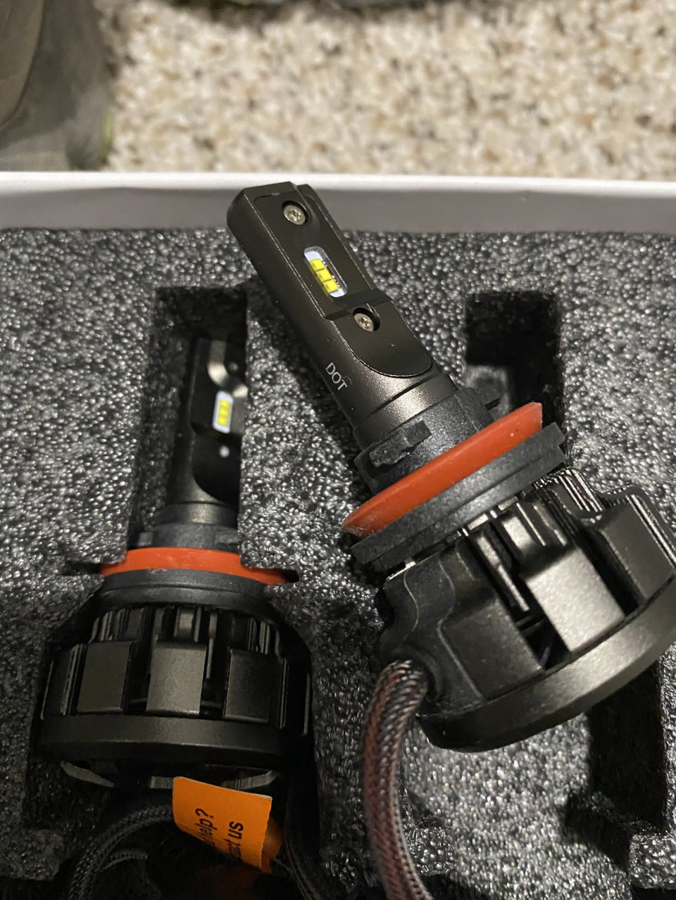

    Need some help with some Hikari Ultras I bought off of ebay. When I was installing them, I noticed one of the light’s base was looser than the other and when installed, I can take the led out without that much force. Im worried it will fall out with time.
    When I took the base off, I noticed one light had red o-rings and they are set slightly higher on the bulb. The other has clear o-rings that are a little thicker and set lower on the light.
    The light with the red o rings is the one with the looser base. Probably because of the thinner o-ring not applying that much pressure.
    Is there anyone with a set in hand that can show a pic of both lights with their o rings and in what position the base should be installed in.

    Um, they don't even look like matching bulbs ... I think you have two different part numbers there.

    As you’re turning the base, push slightly down and they should slide right back in place.

    Thanks, I can see how the base goes on. Im just worried about one being looser than the other and the potential of it sliding out from the base.

    Mine slide up and down too, if I move them. However, when the red O ring is flat against the heat sink and attached to the projector, they don’t move and attach pretty solid. At least mine did. I love these lights but went back to halogen for a bit

    Mine have the clear o-rings and sit snuggly. Does it look like you could possibly swap a red and clear o-ring, to seat better on the loose bulb? (If they are the same diameter)
    LOL! Curious when Hikari started stamping their bulbs with DOT as that is clearly a lie.

    I saw the DOT stamp and thought it was funny. Ill see if I can swap an o ring from side to side if not, possible at something between the base and o ring to make it it fit tighter.
