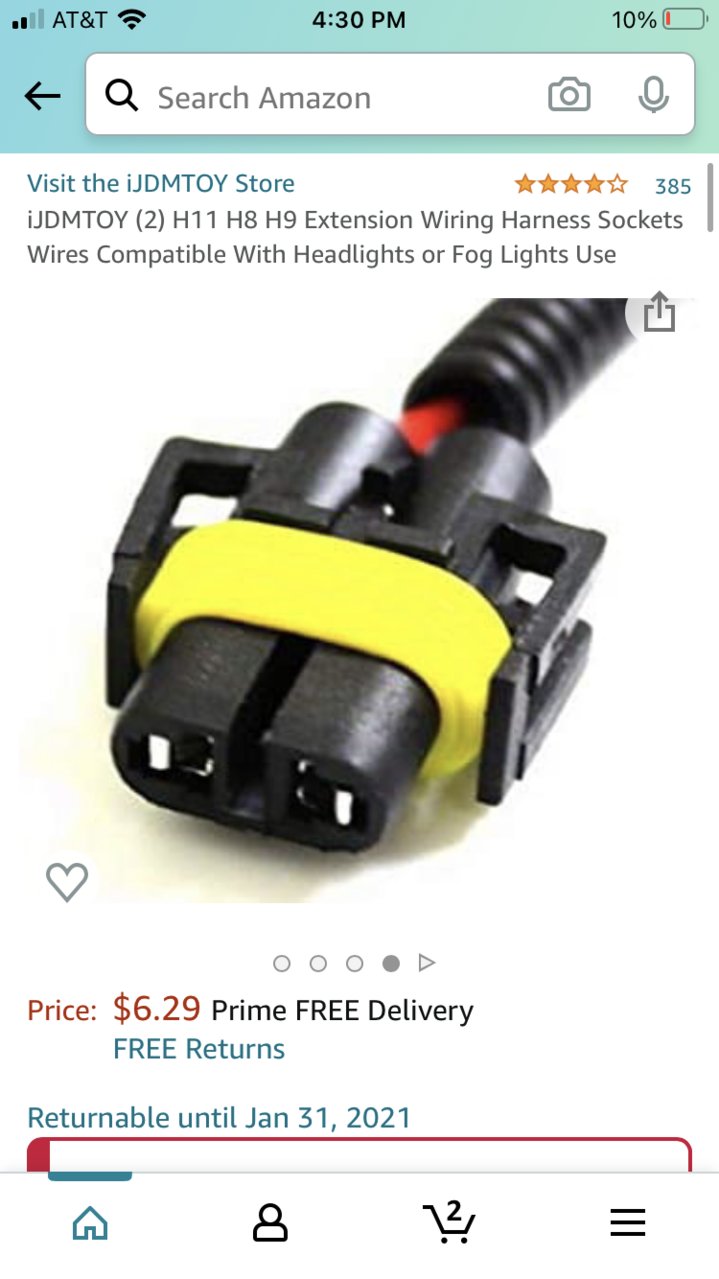

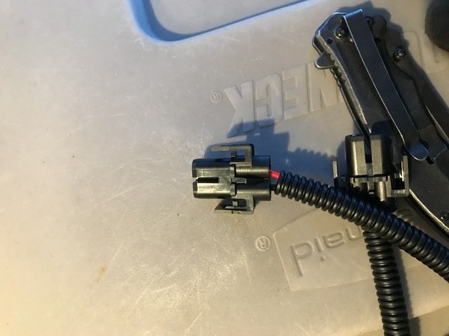

    Okay y’all. Buckle up!
    I got these.
    I figured they are H9 extensions so they’ll work on an H9 bulb. How wrong I was. That notch doesn’t carry all the way through. So, I had to take a utility knife and score the channel and then slice into it to make it look like this.
    Long of the short, the extensions are not PNP, they’ll need to be cut. However, now I can swing by any store and get any H9 and they’ll drop right in. No modifications needed on a continuous basis, just one, today. In the cold because I didn’t know it would be needed and didn’t want to deal with returns and whatnot so I figured F it. It’s going in.
    Fogs are the cheap o H11s, lows are the hella H9 yellows.
    waiting for the sun to go down and then I’ll take it for a spin. But as far as initial impressions, I am very happy!

    See my post about modifications. I got the pig tail so that I wouldn't have to mod. Then I did have to mod, BUT I modded the connector instead of the bulb. Now, I can go to any walmart auto zone oreilly whatever and get a set of H9s and pop them in no fuss, since I have a modified connector instead of the bulbs each time.

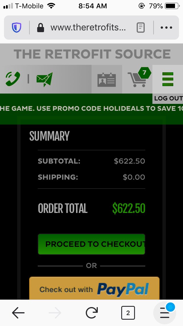

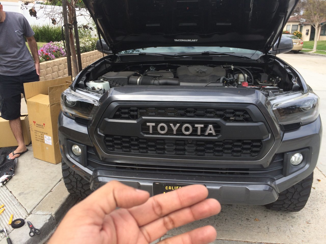

    Hi there,
    Can you kindly take a look at my shopping cart and tell me if everything looks good?
    1. Bi-Xenon: Lexus RX350 STi Lens
    Lexus RX350 Bi-Xenon Projectors: 2 X Bi-Xenon: Lexus RX350 (Non-AFS) (LHD) $290.00
    Clear Lens Upgrade: 2 X Lens: STi-R
    2. D2S: Osram Xenarc 66240 Cool Blue
    Bulbs (CBH = CLOSEOUT): 2 X D2S: Osram 66240 CBA (6500K) (Duobox) $160
    (Your opinion on this one? I have MESO switchback side markers. When driving, the side LED's are white. )
    3. H11: Pass-Through Harnesses with Grommet
    Adapters: 1 X Harness: H-Series housing pass-through cables w/ grommet (H11)(2x) $10.00
    4. Rubber Housing Caps
    Housing Caps: 2 X Housing Cap: Cylinder (75mm)
    5. AMP to D2S Ballast Adapters (Straight)
    AMP to D2S Ballast Adapters (Straight): 2 X AMP > D2S Ballast Adapters (Straight)
    6. HD Relay: H11
    2x Relay Harness: 1 X HD Relay: H11/H9/H8/880
    7. AMP: Hylux A0050
    Ballasts: 2 X 45W / AMP: Hylux A0050 Ballast
    I need to place the order today! My local guy who did my lights gave me this list. Please advice based on everyone's best advice here.
    Note:
    I have a 270V aftermarket alternator from DC Power Inc in my truck.
    And a regular Interstate Battery.
    Also have Diode Dynamics White (Driving) Sport lights as fogs.

    Looks like your trying to do an RX-350 retrofit, correct?
    You can simply buy the D2S: Morimoto Elite bundle from TRS which is $175. It includes the H11 relay harness, ballasts, igniters and bulbs. You shouldn’t need the AMP to D2S ballast adapters. Just buy the D2S ballasts and igniters from the start. The RX-350 projectors use D2S bulbs.
    There is a seller on eBay selling the RX-350 projectors, clear lens and tuned for $275 obo. I bought mine from him a couple of months ago for under $250, they look good.
