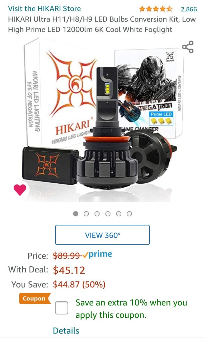

    Just ordered a set for the Highs

    They would not be ideal for highs

    I think you're going to find that the Hikari's are more of an upgrade for the low beams and less so for the high beams. In fact the H9 Halogen (low beam) swap will actually net you more light.
