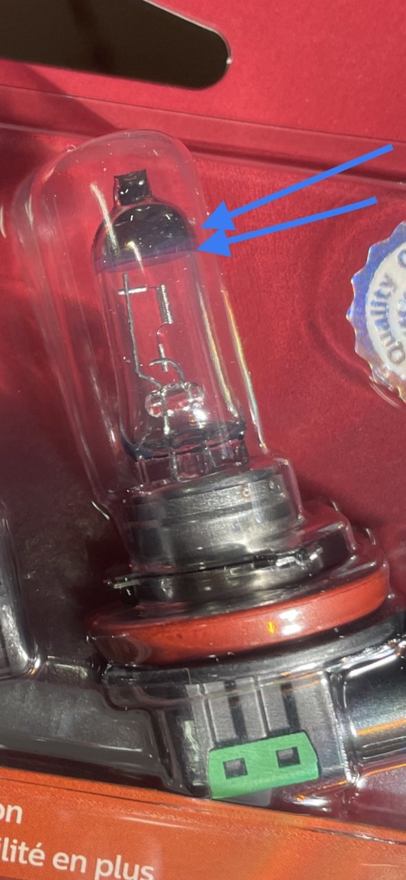

    I just wanted to show you guys how much shorter the glare cap is on the Philips +100’s vs. the GE/Tungsram series. Upper arrow is bottom of the silver glare cap. Bottom arrow is the bottom of the blue band.
    I’m no expert, but anecdotally speaking, I do think this gives you a much wider beam pattern than the GE/Tungsram bulbs. The difference in blocked light is huge.
