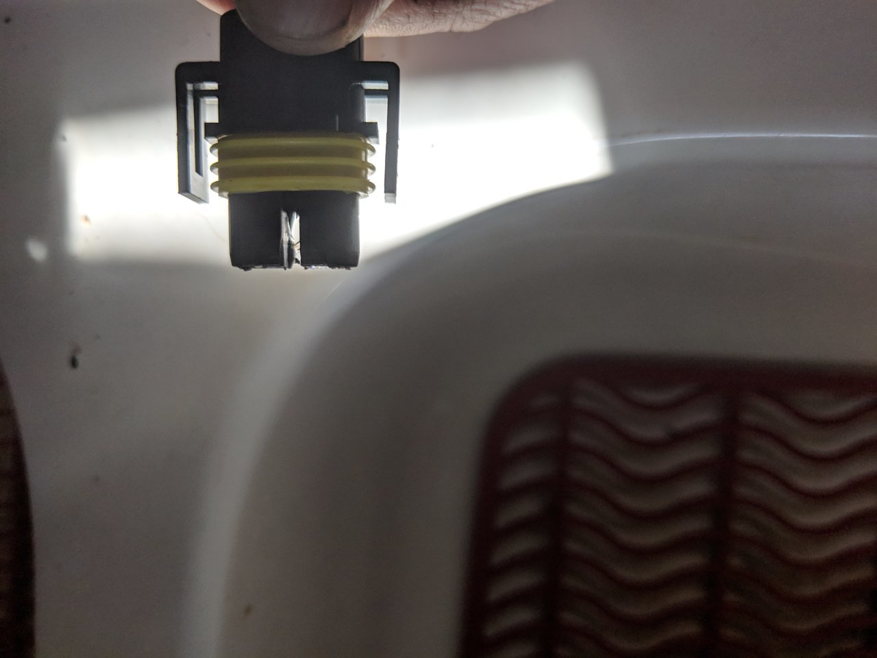

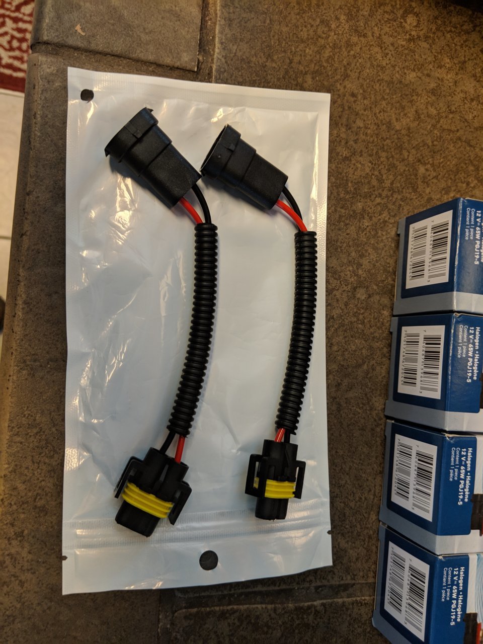

    You can buy the IJDM extensions off eBay or Amazon and make a small cut in them. Then it's plug n play. Use Hella H9s for all four. That's what I did. One bulb for all four. And they are cheap. IMG_20190218_142227.jpg

    -Is this somehow the same kind of mod that is needed by "shaving" the tab on the H9's to make them fit the harness, tacosrus?
    The idea of being able to buy just one kind of bulb×4 is freaking awesome.

    Fairbanks, AK
