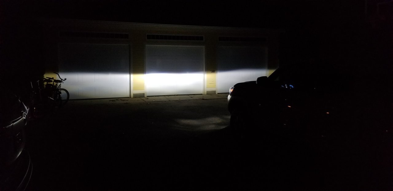

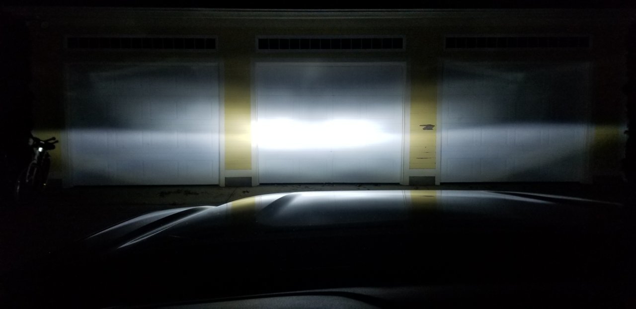

    They're usually out of stock after a sale (which they recently ran). I got 2 sets for high/low beams for $85 delivered (then bought another 2 pairs for my Highlander). I love them in both vehicles. I'm sure replacement lenses are better but $85 vs $1,500?...not enough difference for me.
    Here are low and high beam pics.
    Low

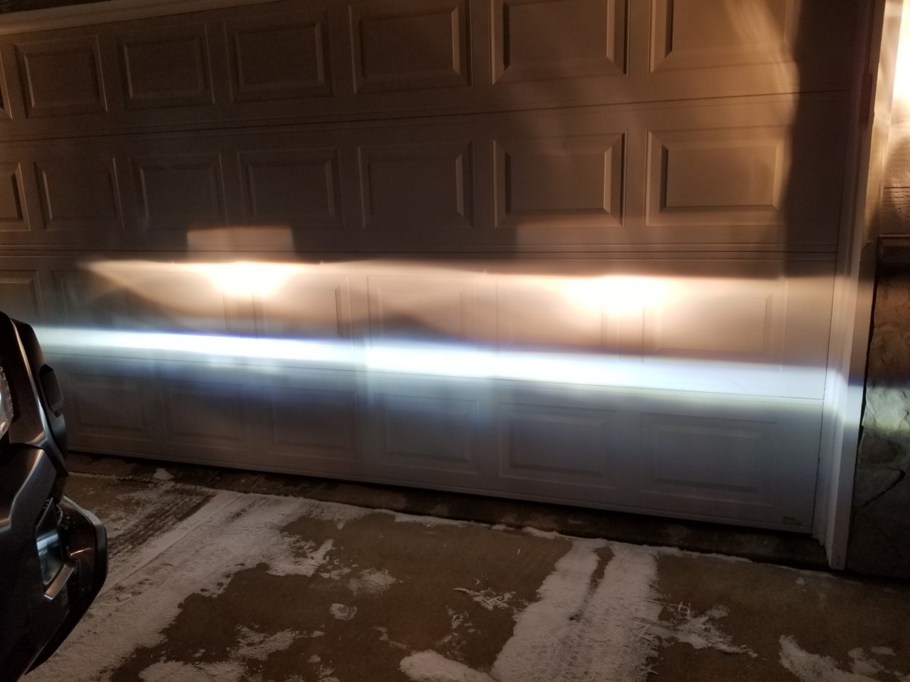

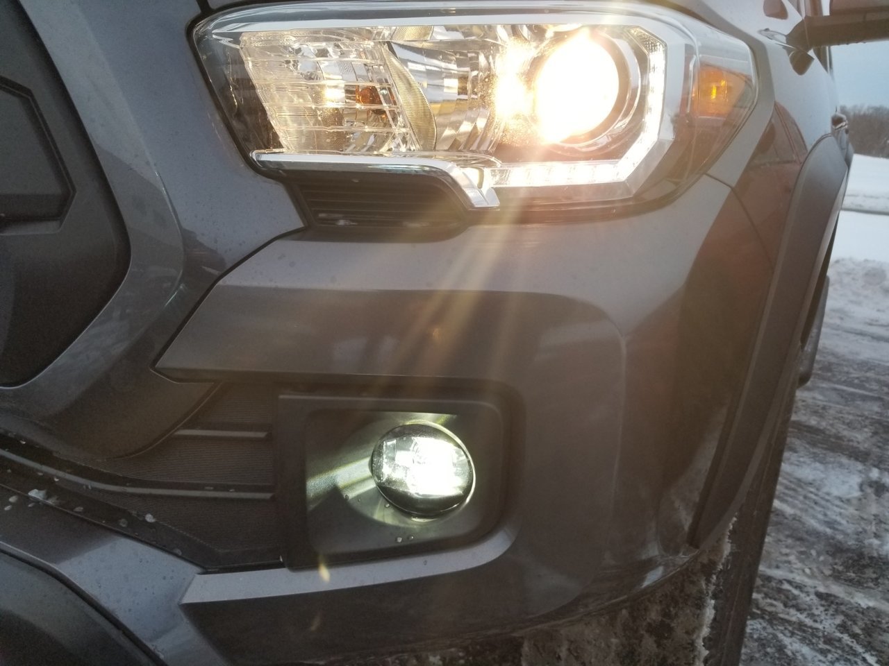

    Been wanting to upgrade my fogs for a while now but never got around to it. Finally pulled the trigger on a set of OEM black LED fogs. Love the cleaner look and output. I snapped a quick pic because I wanted to see if the brains here could let me know how my alignment looks. The OEM fogs have an alignment knob that allows for up/down movements

    Hard to say from a close wall shot. The cut off should have a 4" drop at 25', or alternatively if a flat location of the length isn't available, a 2" drop at 12.5'. For aiming longer is better though.
    Correct, the emitters should be at 3 and 9 o'clock. I believe the LED power wire comes out of the 6 o'clock position on the back of the LED, so gif you have that aimed directly down you should have the alignment correct. Double check by pulling the LED to confirm the power wire position.
