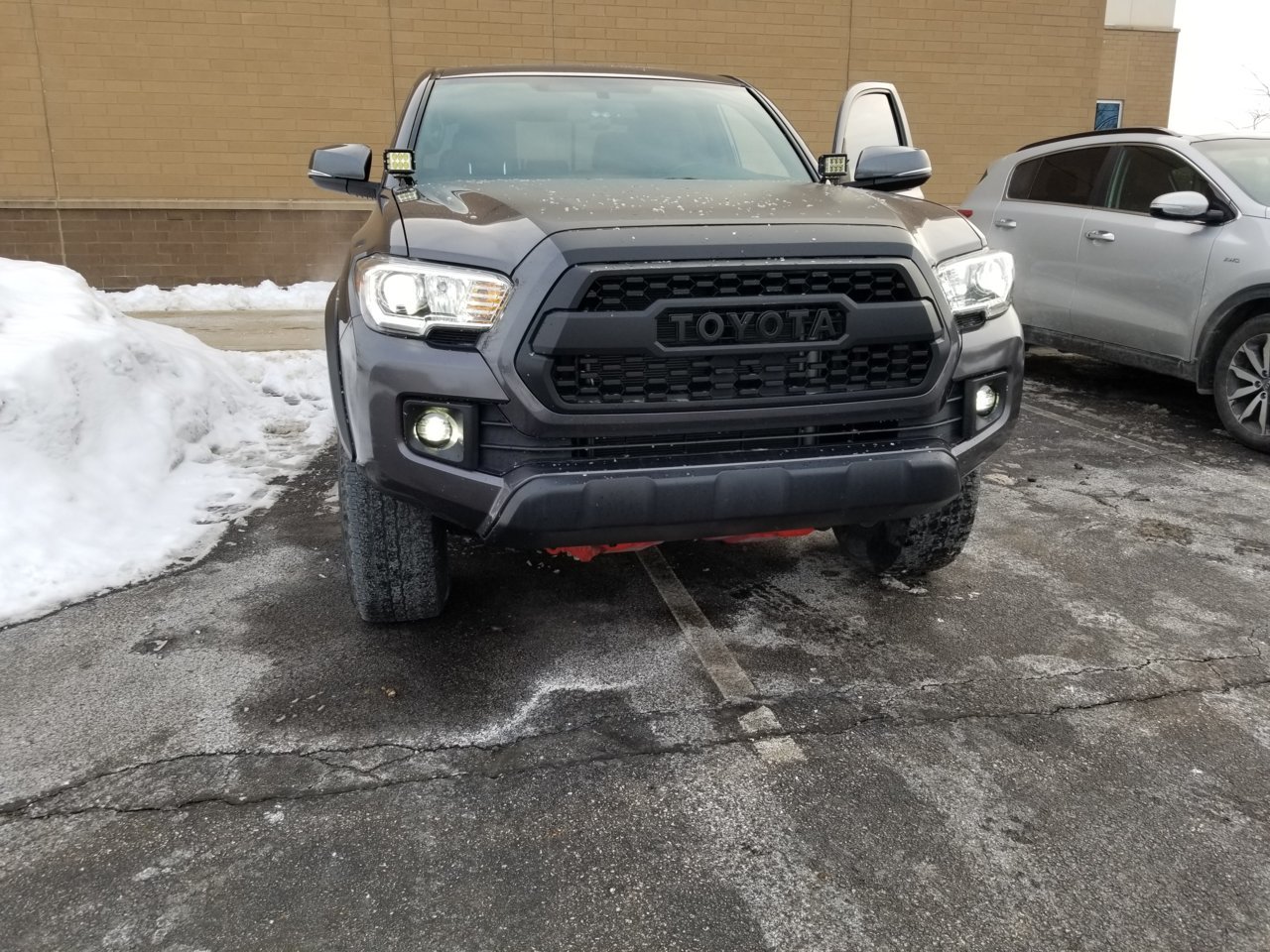

    As requested... Snapped some pics this morning... Throw isn't improved much but I knew that, but it's definitely brighter. Love the look of the OEM black fogs with the Hikari ultras
    ryanvar42, Burns and tclavell[QUOTED] like this.
