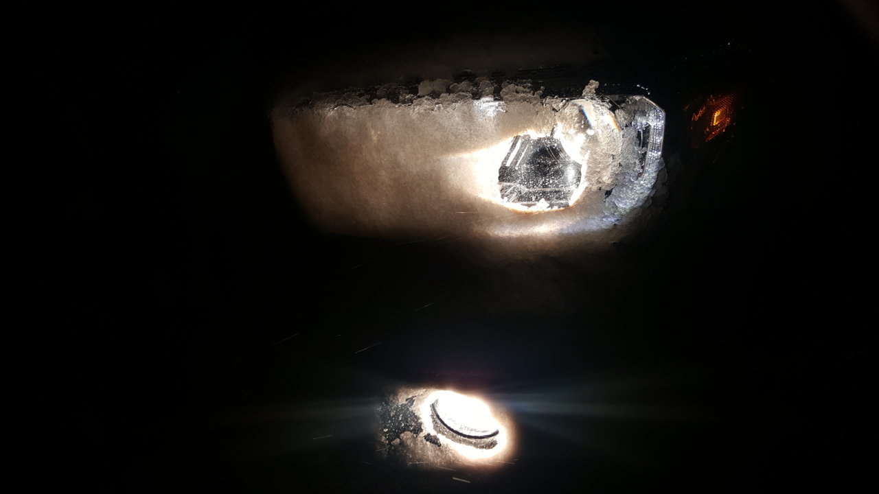

    Been following this thread for a while and I gotta say, heat from the bulbs to melt the snow is a thing. I just drove through some nasty shit.20190222_183945.jpg
    xxTacocaTxx, Boghog1 and Tacosrus like this.

    Just had the same thing happen last week. Drove around with lights on. Cleared em off....
    Burqueboy505[QUOTED] likes this.
