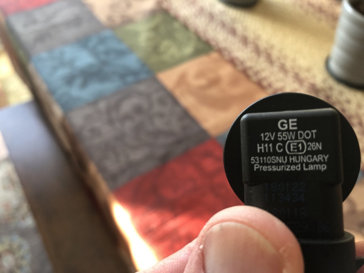

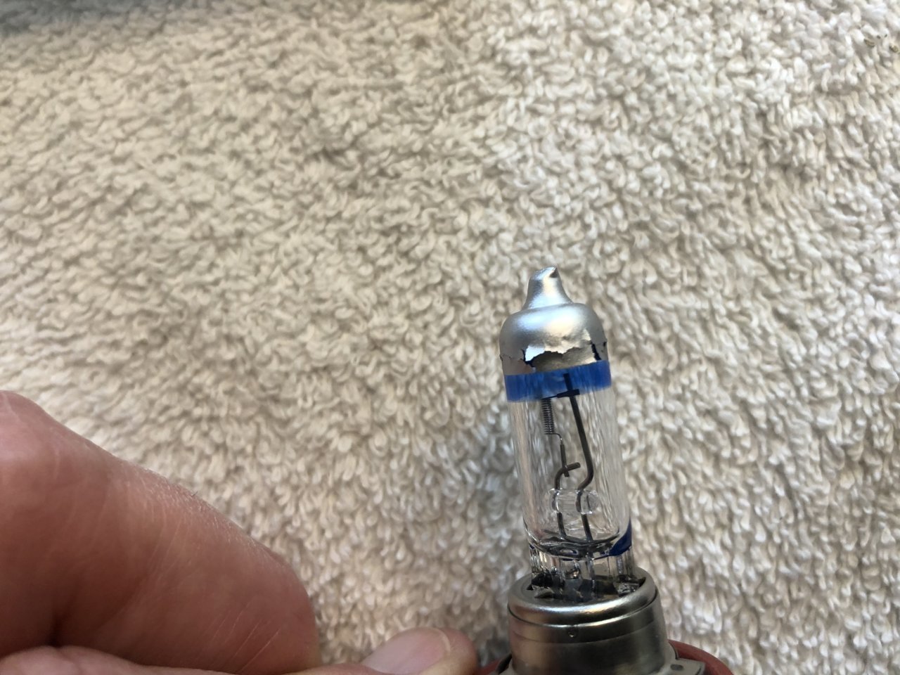

    so several weeks ago I ordered from Walmart online a set of Tungsram Xenon Nighthawks, pulled my OEM bulbs and installed the Nighthawks. My wife and I went for a short drive and decided that while they were better than the OEM it wasn’t a drastic change. We drove for about 10-15 minutes, that part becomes important to this story in a bit.

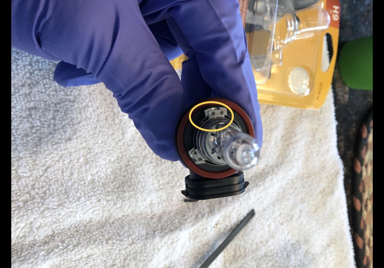

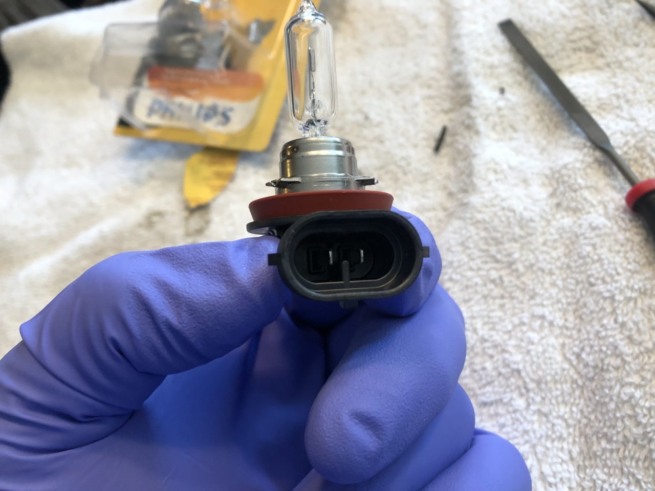

    I’ve been hesitant to do the H-9 lights because of a concern of excess heat over a long time. I pulled the trigger several days ago and today 2 Phillips made in Germany H-9’s arrived. I did the needed snip to the plug and the tab as well, I think that they turned out great. See pics...
    B41CC1C0-8E12-4D6C-A987-4BEC2209A47A.jpg 78F054A7-1268-40FC-8AC4-79E4A1E1A450.jpg 28F44BC8-B18E-494F-868E-EDA35830E473.jpg

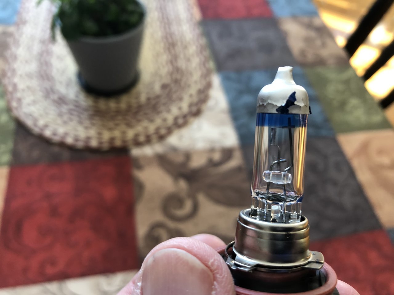

    So this is where things get interesting, I pull the Nighthawk from the passenger side and see that glare cap is pretty much destroyed. I can’t believe it because they were in use for a total of 15 minutes tops. It doesn’t seem that anything has dropped into the housing as far as I can tell. The other bulb appears fine.
    I’d advise that if you’re running these please pull and check them. I don’t know if this is from overheating or it’s just a defective bulb. I thought that by staying with the H-11 I was being prudent, now I’m not so sure.
    I put a H-9 in one side and an OEM H-11 in the other side and am waiting for dark to arrive to see how things look.
    I can’t see myself buying another Tungsram product after this incident, maybe very isolated but I’m not taking the chance on them.
    As I said above if you’re using these you probably want to pull them and have a look.
    I’ve already left a review on Walmart with a picture of the bulb. I was very careful to not touch the bulb in any way during the install and the packaging was intact and sealed when I received them.

    I was unaware you could even get them on Amazon. The only place I’ve seen them in quite some time is Walmart
    these are the ones you got?
    https://www.walmart.com/ip/Tungsram-H11-Nighthawk-Xenon-Halogen-Bulb-2-pack/313412664
    good catch!!! I’m going to go check mine now

    They updated the design to 4 low beam emitters + 1 emitter high beam? The one I have seen was 3 low beam emitters + 1 high beam. Interesting. Fair point on the data, though my time is limited and I try to spend it finding the best products rather than proving the worst. I don't recall anyone saying they were going to send them my way. I'd take a look if someone did, but am already behind on getting the Morimotos done, plus some 4runner assembly testing, plus some upcoming products and a few other side projects.
    I've summed up a few posts regarding their products in post #176 here. (See content in the quotes)
    Strange. Mine definitely have some burn off of the glare cap after years of testing with them, but nothing like the major flaking of the glare cap shown in your photos.

    Yea, the thing that has me scratching my head is they were only used for 10-15 minutes. I did drive around a bit with the
    H-9’s tonight and they’re definitely better. Any idea on the lifespan on the H-9 running them this way? I figure that if I stay this route I’ll replace them annually.
  12. Feb 17, 2021 at 5:47 PM
    #4392
    crashnburn80
    crashnburn80 [OP] Vehicle Design Engineer
    Jun 6, 2015
    #156893
    14,772
    Kirkland, WA
    2003 DCSB TRD OR
    Philips lists them at 400hrs. Based on my personal pre-Covid driving that would be about 2 years.

    Same thing happend to me with the bosch gigalight 120 after a week of use (which is said to be identical to the ge). I then peeled the cap with a napkin as much as I could before reinstalling it and hoped that the residue did not damaged the projector. I have used a lot of high performance bulbs from philips and osram and never had this issue.
