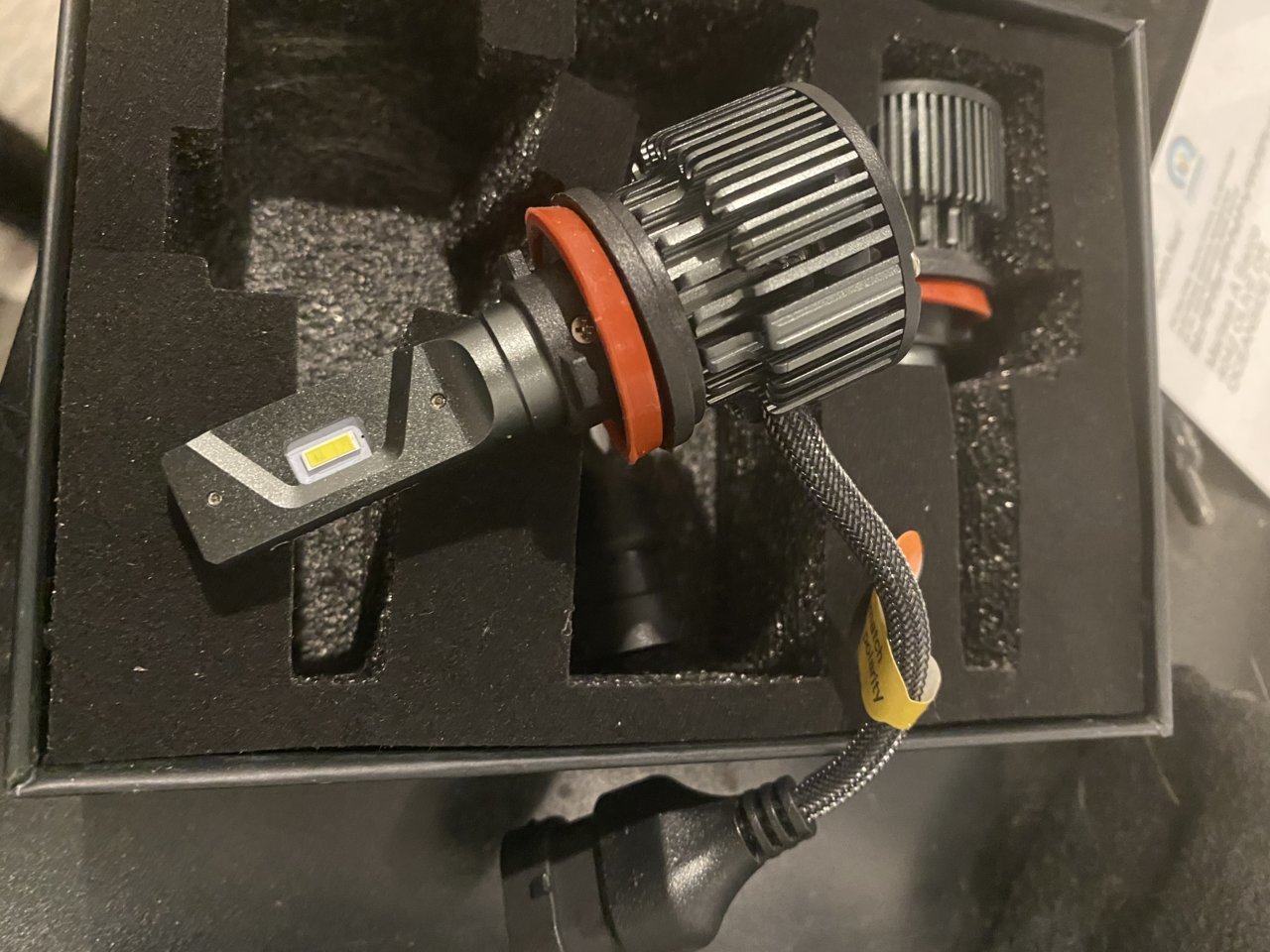

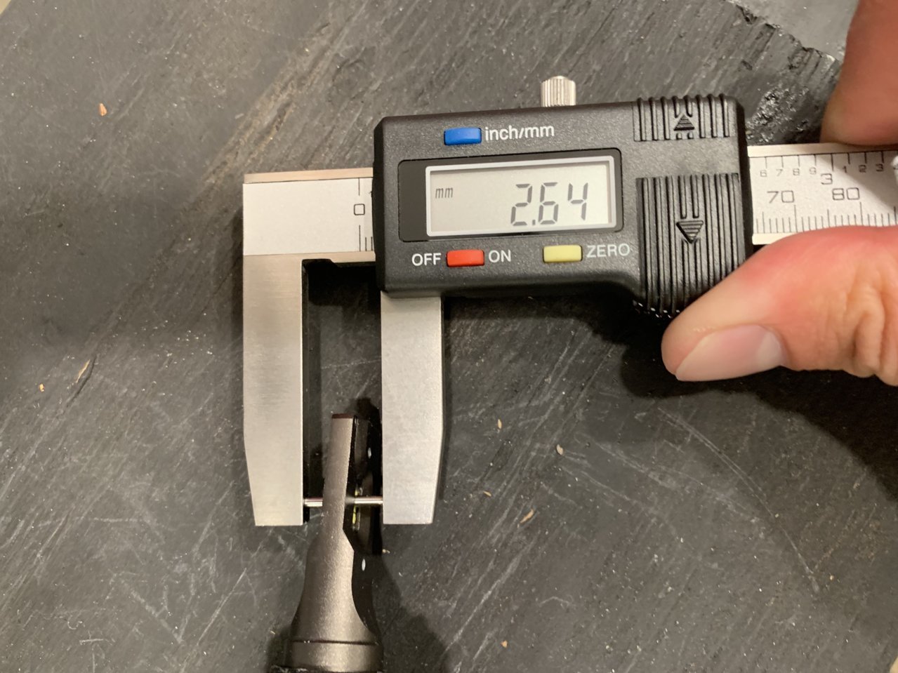

    LOL, No. Not even close. You cannot have an integrated driver into the LED and have high output. Drivers get extremely hot and heat reduces LED output, which is why all high performance LEDs use an external driver box to separate the heat from the LED so you can have higher output. The $29 price tag should also be a dead giveaway you are buying a toy trinket and not a headlight product.
    Also not the same at all. 3.45mm cross section is up with the worst in this thread, meaning lack of focus, lack of intensity and no distance projection while shifting the pattern to foreground light. It is not at all comparable to the Hikari Ultra product.
    Vs Hikari
    Vs OEM halogen.
    Science matters. You cannot just go off the looks of the design and say it looks similar to another product. Dimensions, build design and construction all matter. 99.5% of the stuff out there is cheap China garbage with misleading marketing, especially on Amazon. And unfortunately the signs of a bad LED with significant increases of foreground light and loss of distance light naturally look better to the untrained eye, since people favor foreground light, even though that isn't how a headlight is supposed to work.
