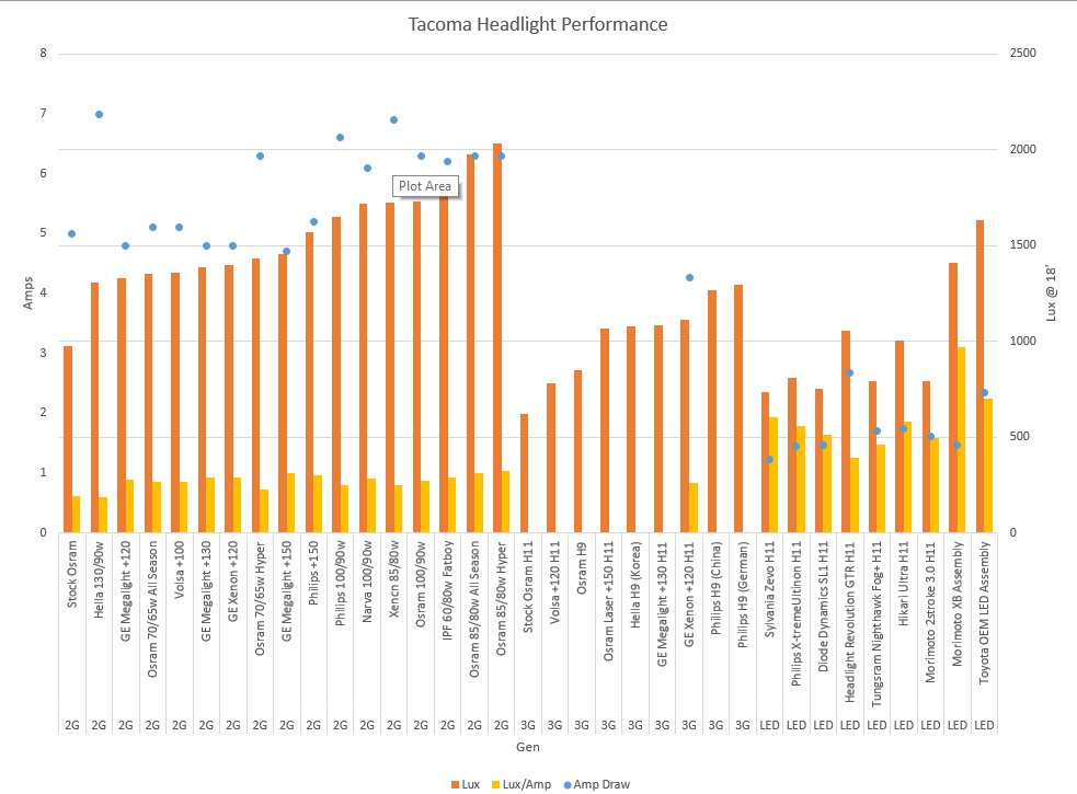

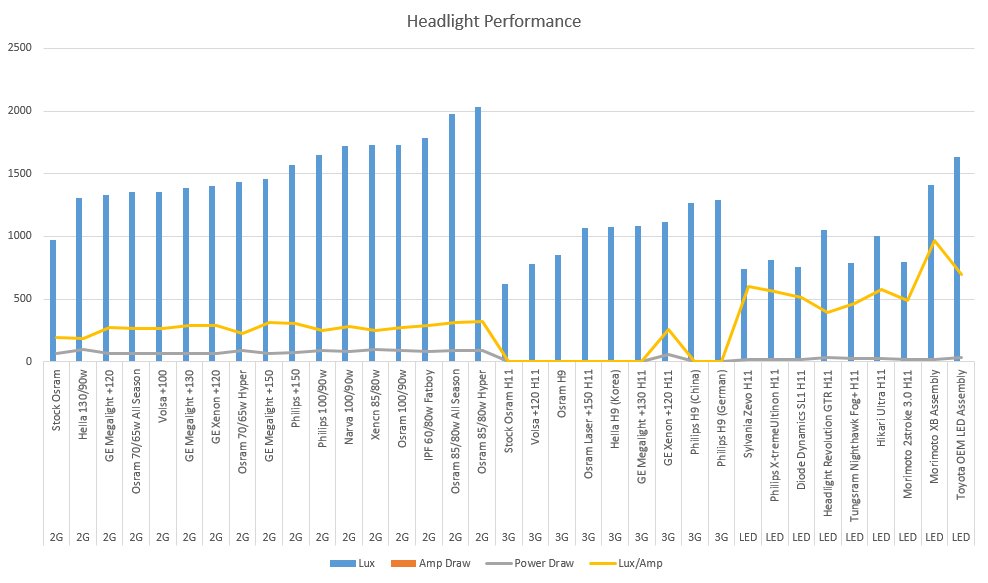

    Graphy graphertons below: ***
    TLDR from this is, buy 2nd gen :)
    As to snow melt, I have yet to get within 100 miles of snow with my truck so I have nothing helpful to add there yet.
    *** LED measurements are either taken from measurements made at 18' or interpolated from measurements made at 42' to 18' (I believe for the Hikari's specifically). Crash has explained how LED light output should be measured at distance, his practical limit is 42'. Diode Dynamics has a 50' test environment which is even better. The bottom line, though, is that for LED measurements, 18' is insufficient and does not tell the full story. However, I don't believe crash has halogen measurements at 42' so there isn't any better way to compare everything all one one graph than using the 18' numbers. Also note that the Headlight Revolution GTR is not recommended (for reasons why read the first few posts) meanwhile the Morimoto 2stroke 3.0 is recommended (again please read the first few posts). So, while this graph is not meant to be misleading, it has some misleading characteristics. Still, it is somewhat helpful to see everything mixed together in one big pot.
