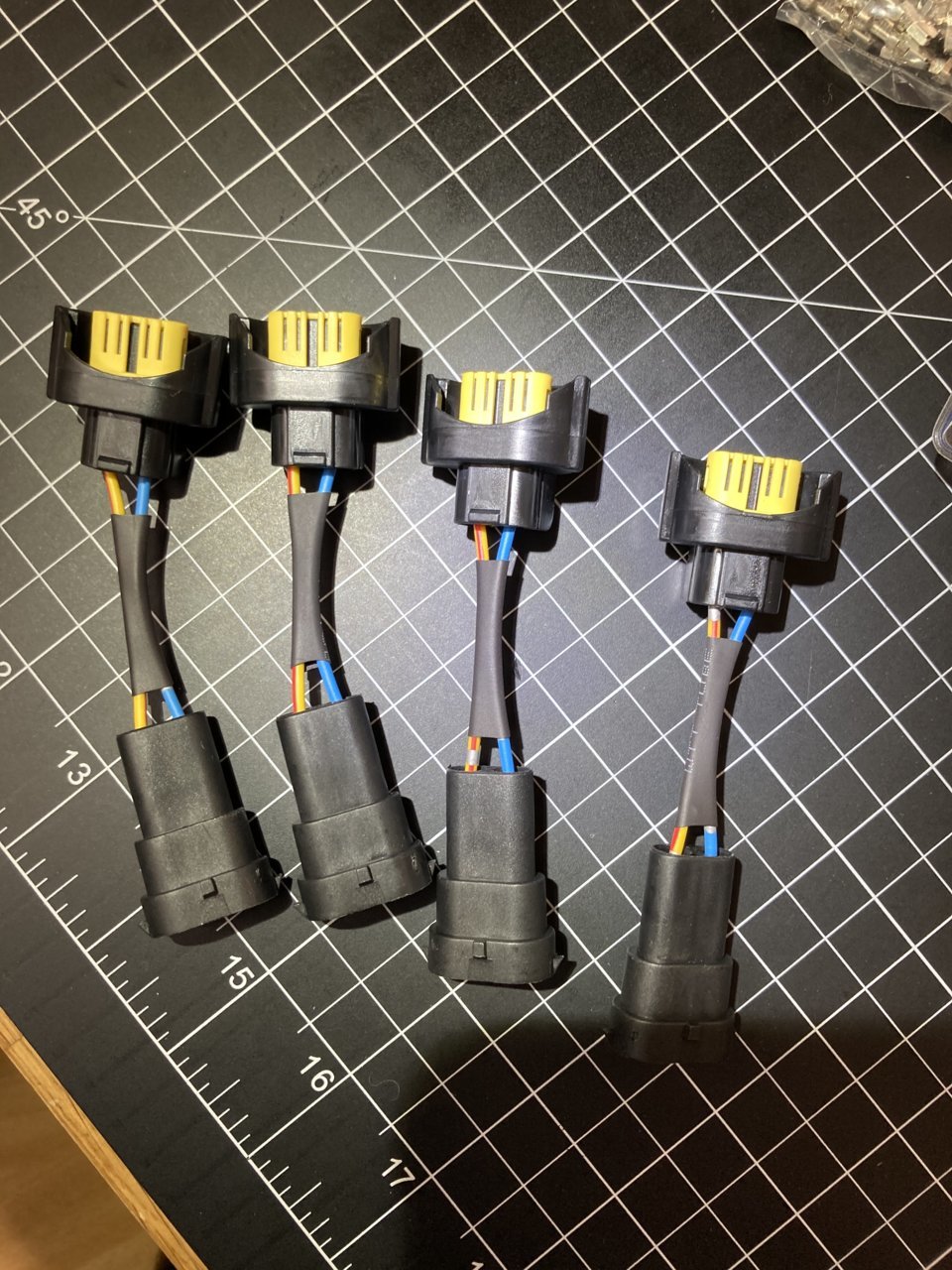

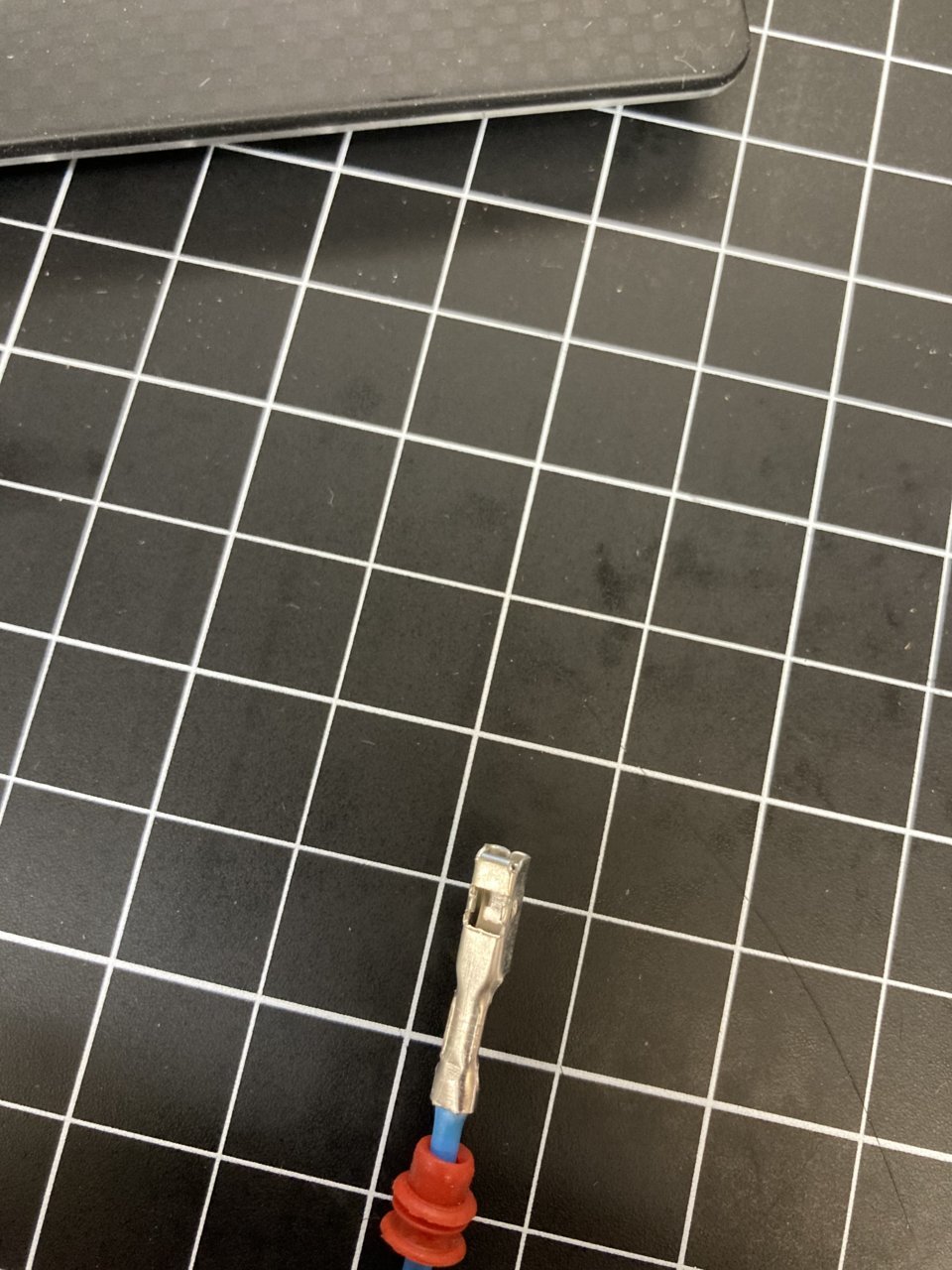

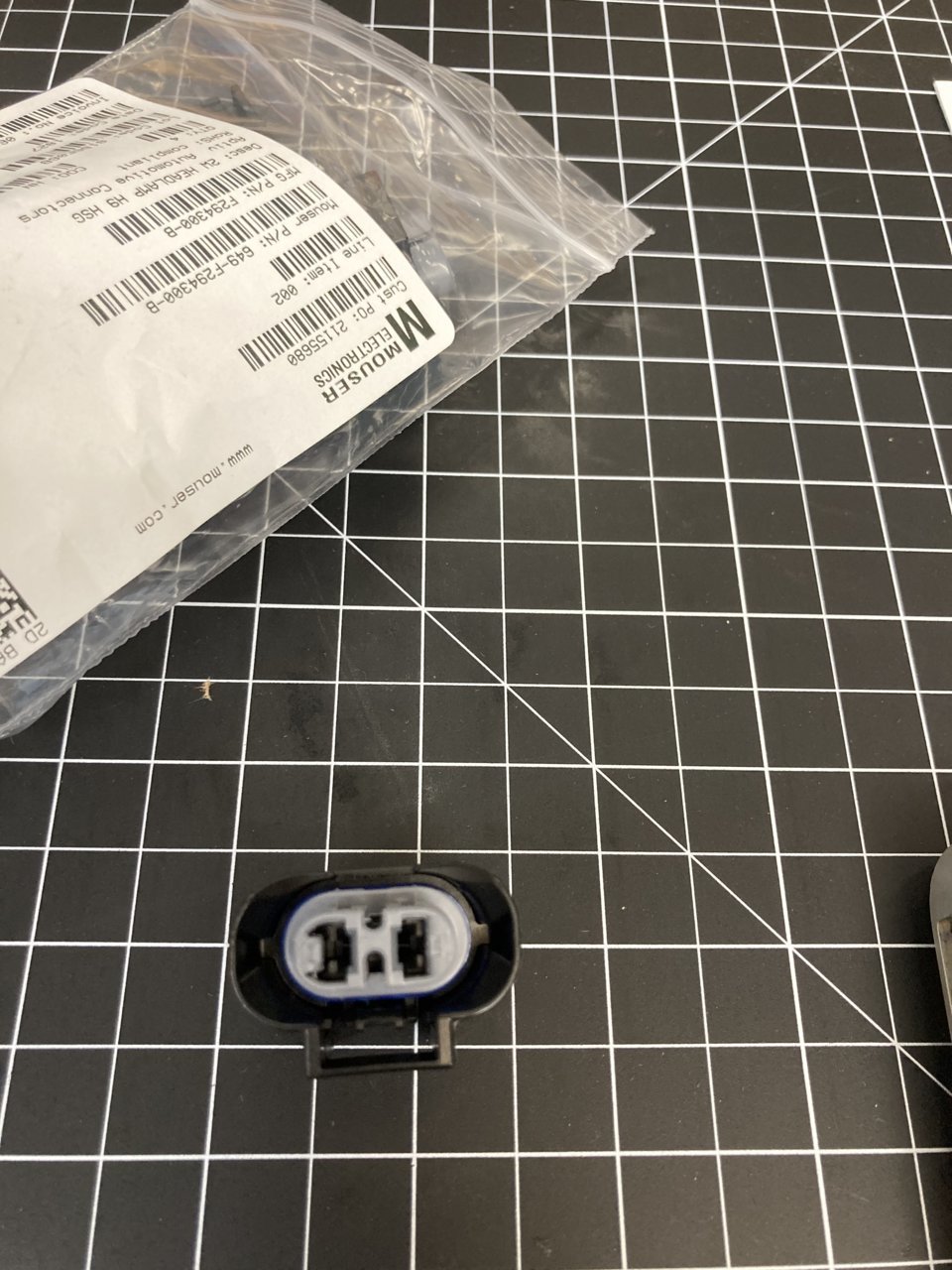

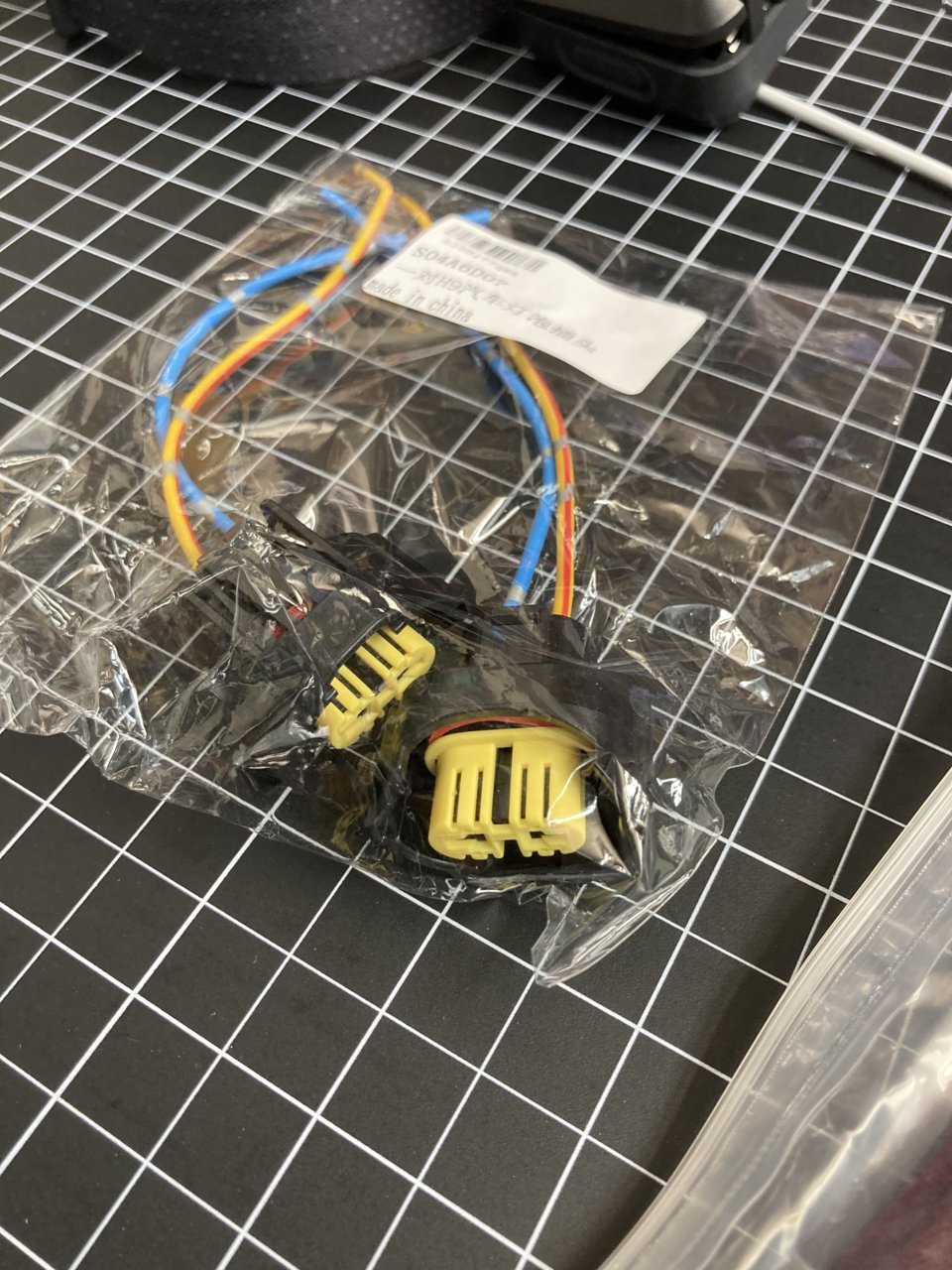

    I got some female H9’s yesterday and got all excited. Got the male side done. Went to do the females and realized neither of the sockets I have fit that one. Hah! Cruel irony.
    I’m still waiting on the OEM looking ones to show up from Hong Kong / mainland China. And still hunting for terminals for the Delphi ones.
    299DF9E4-E4B4-4FFE-89DC-4D7BC0C83A1B.jpg 77EF5704-218F-4057-920A-AD032023517F.jpg

    :thumbsup: Mouser. Ordered a ton of stuff from there.

    These don’t look half bad. They also don’t look at all OEM.

    Says "made in china" on the label. I can't read the Hanzi stuff. Got 'em on fleabay but I saw similar on aliexpress, just took the easy way out purchase-wise as no ali account (yet).
    Going to whip up a test harness, anyone got a preference on length? I was thinking short and sweet myself...

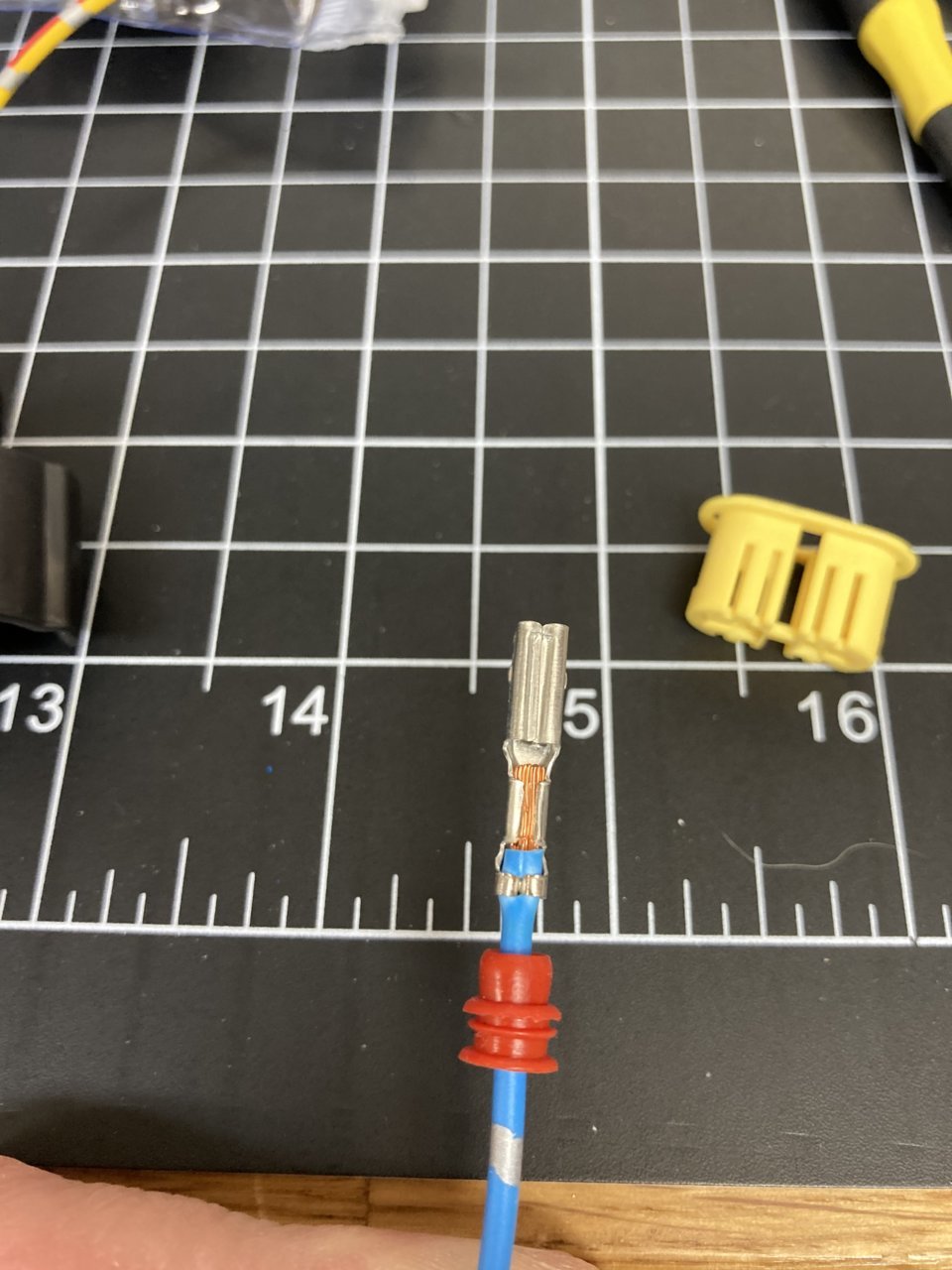

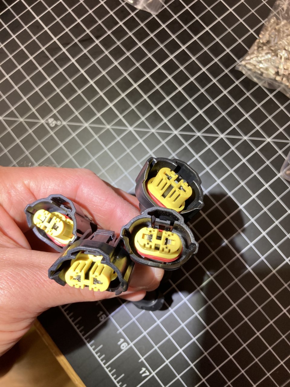

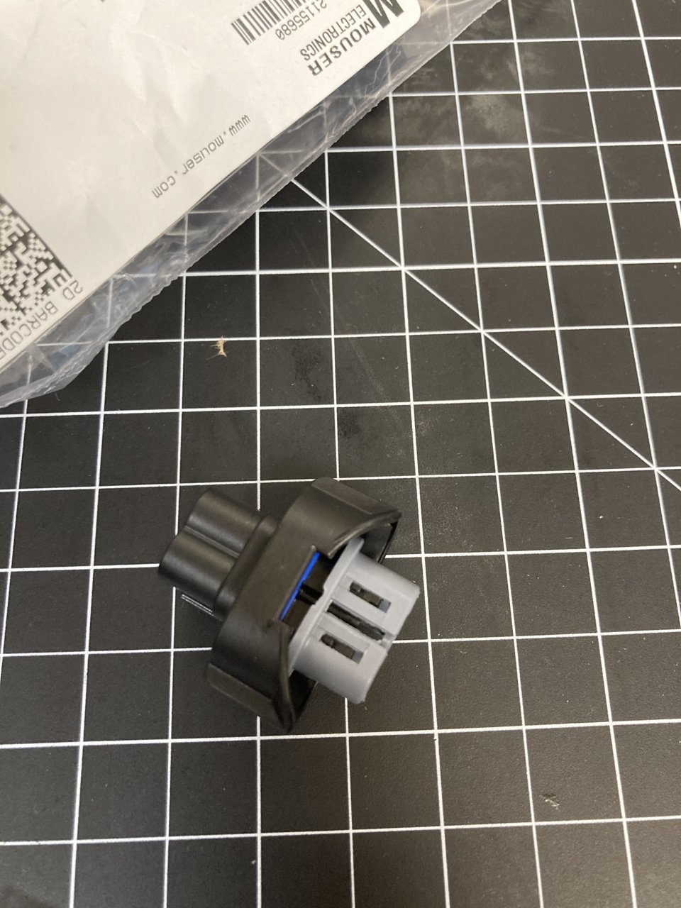

    Ok, so, I don’t think this is it either.
    Pro: female fits H9 snug as a bug. No wiggle, no play, strong and solid connection.
    Con: weatherproof rubber seal is not very tight tolerance. Loose and looks like it easily bunches up. Also the female terminals it came with were unsealed with seals placed on top. Overall, not superb.
    The search continues.
    552AE8E2-1148-4488-8504-58AB778C0D6E.jpg 1CAFD6AF-9783-4263-837B-E1A54621CEF1.jpg D6A6FD80-27CE-49AB-AF4F-27C4B858E1D9.jpg 1E954BB8-1328-4E12-85AB-D83772BE68CA.jpg

    And if you trim one of the H9 tabs, then it fits in the H11. Even though H11 has a longer slot in the female, the shorter tab from the H9 poses no problem.
    Power-wise it’s 10/55 so < 20% difference. Though there are reports of cheap female H9 extension harnesses melting. It’s assumed that OEM connectors are high quality. A ceramic female might be ideal insurance but I have yet to find one I truly love.
    TLDR, you will be fine. Many of us run this setup with zero trouble.
