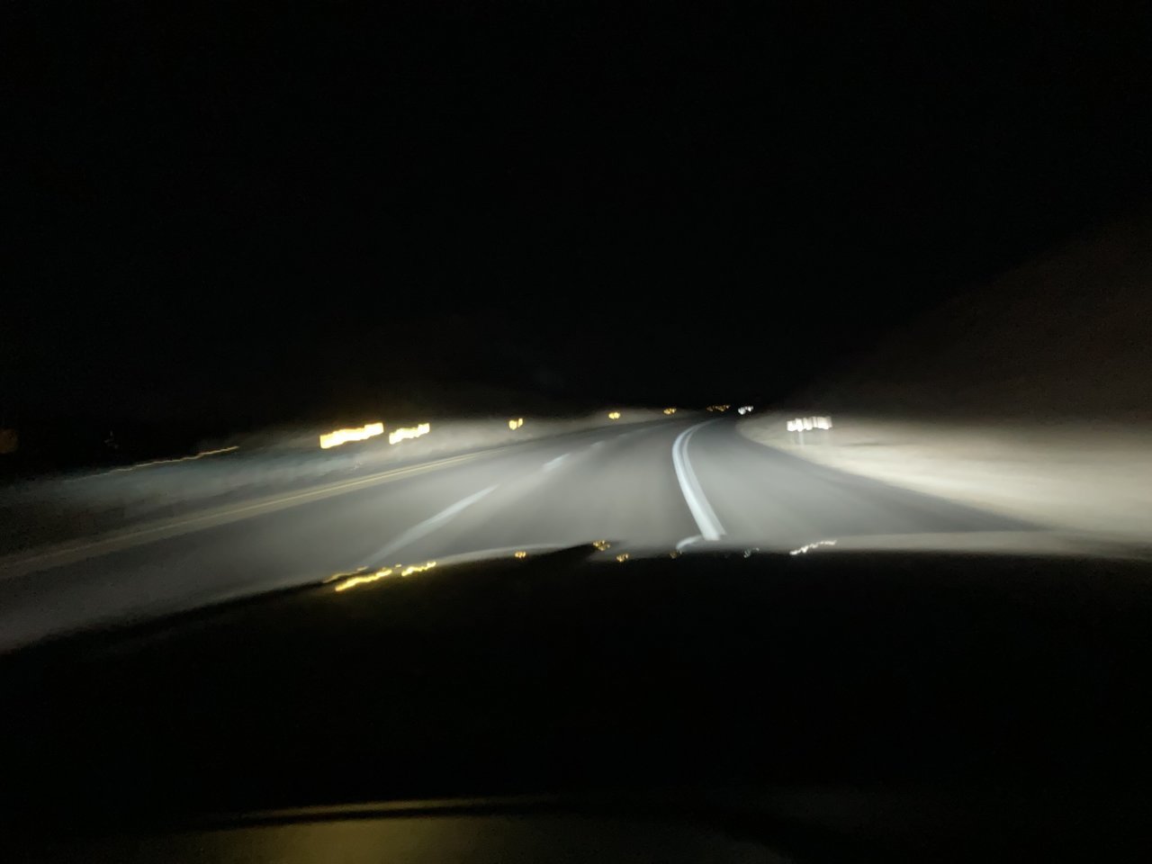

    Man, I need to fix my aim because your throw is MUCH better than mine. Now that it's not 10 degrees out all the time I'll find a level spot and use your guide to set them up because that looks SO much better to me. Granted, if I truly need ALL THE LIGHT, I throw my 30" KC bar on, but then I'm just "that guy".

    Shout out to @crashnburn80 for helping me out with the lights, the man has put in the work for the Tacoma community. Just stuck the H9s into my tacoma. Had to do a little filing to the metal tabs but oh boy do they make a difference!

    Follow up by reading posts #2 and #3. The Philips H9 swap covered in post #2 is the highest performing recommended option for the halogen 3rd Gen light assemblies. If you want slightly whiter light, go with the Hella H9 Performance 2.0s, which are a little lower in output than the Philips bulbs. LEDs do not perform as well as halogens in a halogen assembly and HIDs produce excessive uplight due to the halogen uplight allowance causing excessive glare, not to mention bulb bounce issues and the complexity of ballasts. If interested in HID a retrofit with a proper HID projector using a legitimate HID capsule such as D2S to run quality made capsules instead of cheap china rebased HID products like H11 or H1 HIDs would be in order. If wanting higher output than the H9s provide, the best performing recommended option is the OEM LED assembly swap.

    i did the h9 swap a few weeks ago and didn't notice how much better it is until i pulled up to another tacoma with the stock bulbs.

    In urban environments with lots of light it may not be very noticeable as the light color is the same. But get out on some dark backroads and the improvement should be very apparent.
