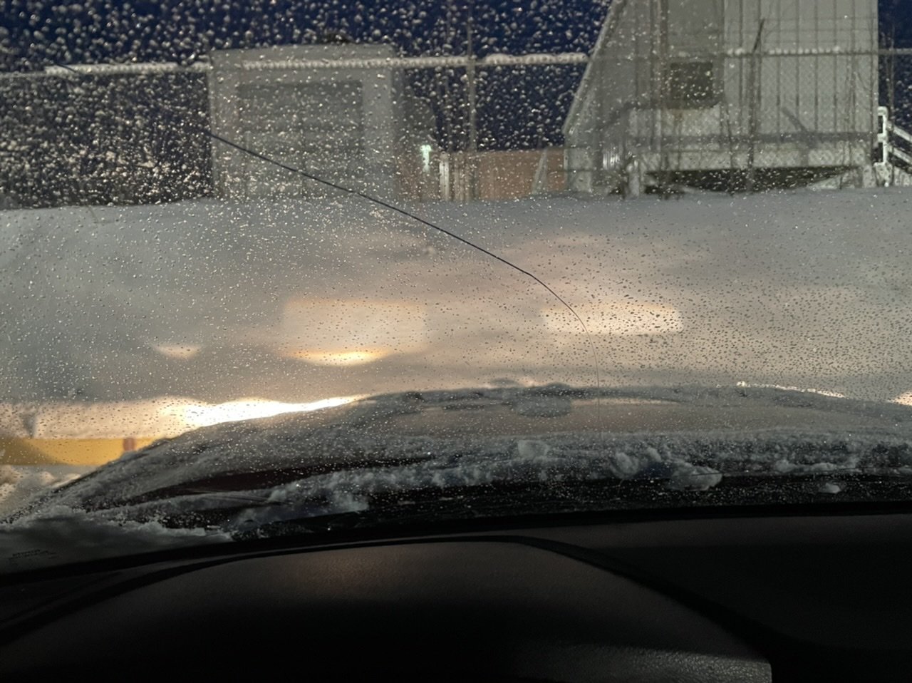

    Speaking of uplight, a couple weeks ago I got a good view of the OEM squirrel spotters before leaving work:

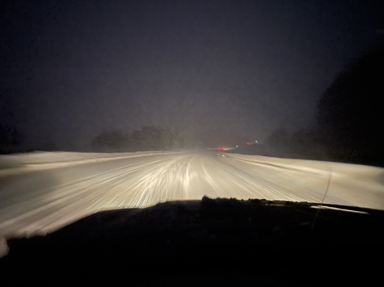

    What does excessive uplight mean for you on the road? Glare in bad weather:
    H9’s in oem projectors, lows only no fogs. Glare sucks for you, glare sucks for others.

    You might mildly hate it in the snow, but on a dark road in clear weather not being able to see beyond your cut off (due to no uplight) poses a significant driving hazard, where one can only see what their headlights illuminate and nothing else.

    Indeed! I’ve had or driven cars with headlights that don’t have the uplight and it’s like a black wall at the end of the beam pattern in all conditions. We’re coming to the end of headlight season here in Alaska, I think I’m going with better H11’s next winter over h9’s and SS3 sport fogs to get the glare and uplight situation under control.
