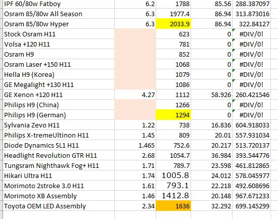

    While we're looking up current draw for things, anyone want to help me fill in the numbers in the unified graph for the H11's and H9's?

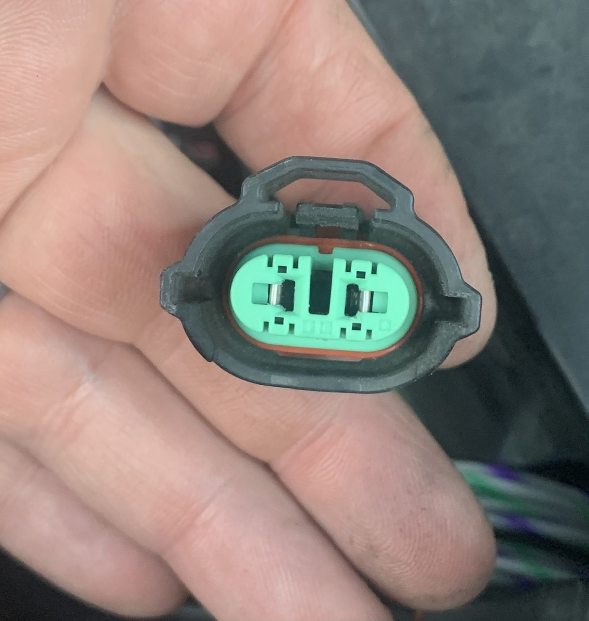

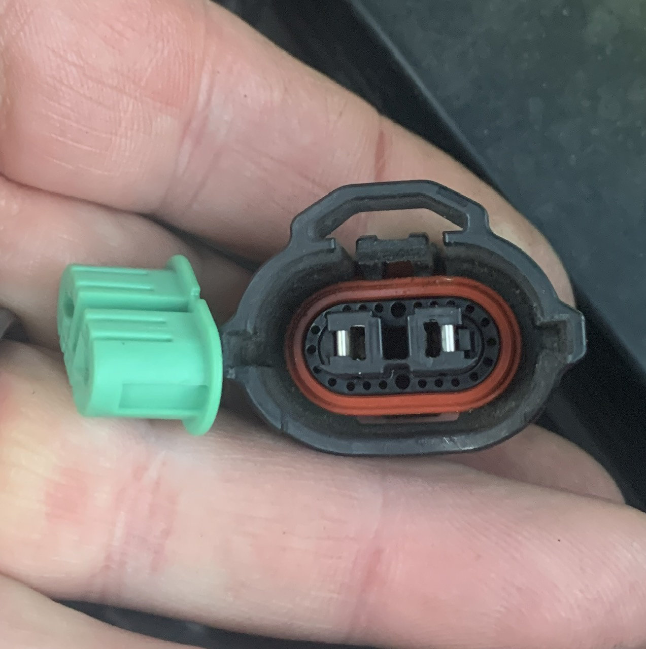

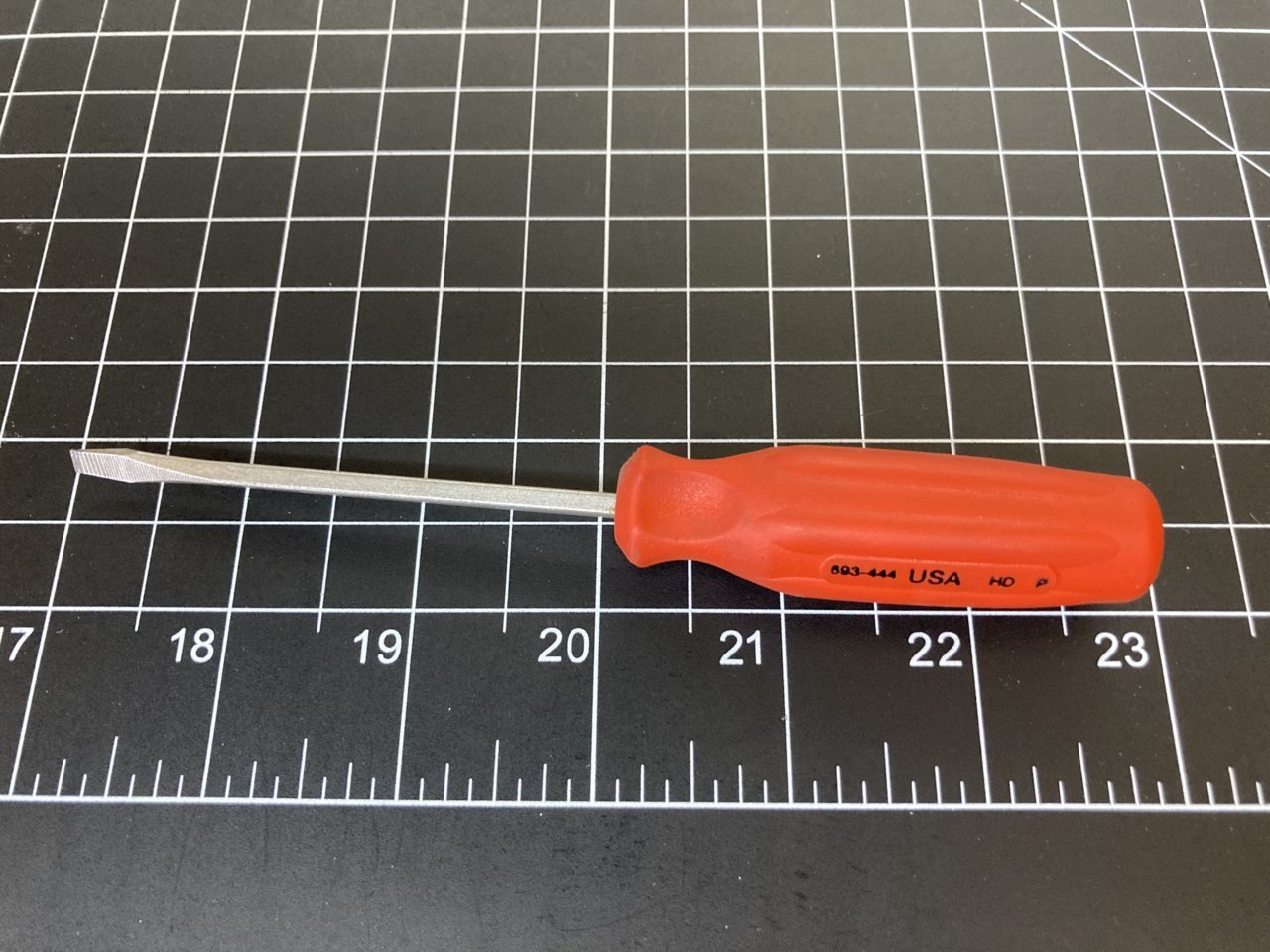

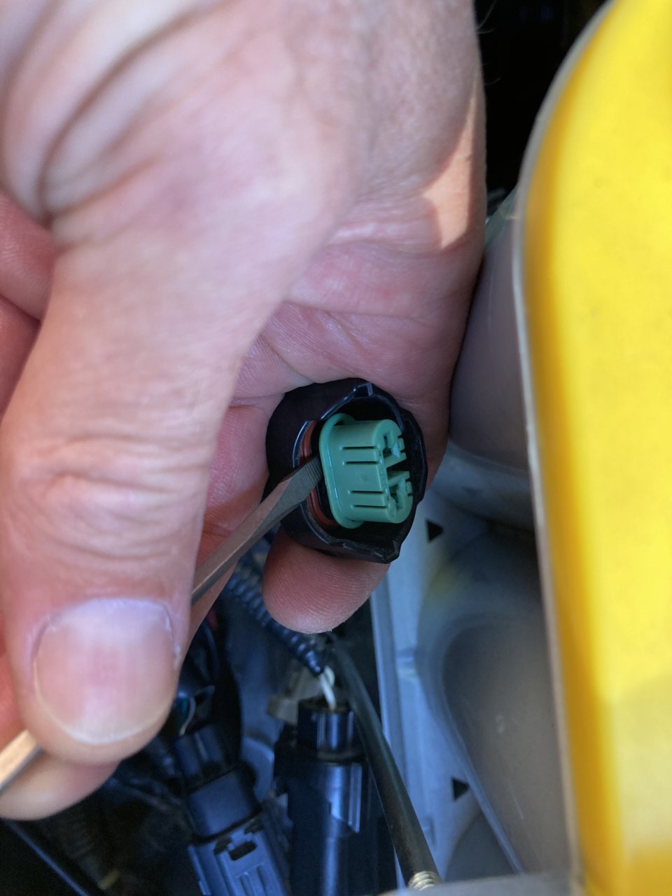

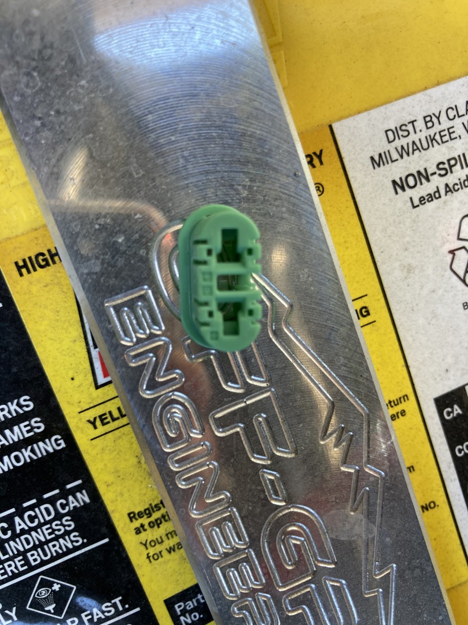

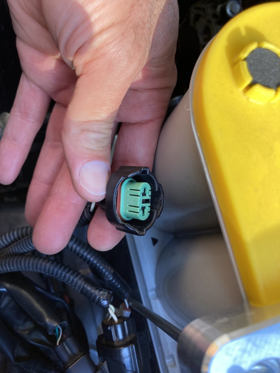

    Not sure I have the right one here, I can never remember which is H9 and which is H11. But the process is the same. Just take a small screwdriver and pry up on the green (or yellow?) plastic piece. It won’t take much force to pop off.
    EEDAE06B-7980-4505-BB6F-FE6CD010B7CF.jpg 8BA66C75-88FA-4722-8CFA-79F396A78A70.jpg

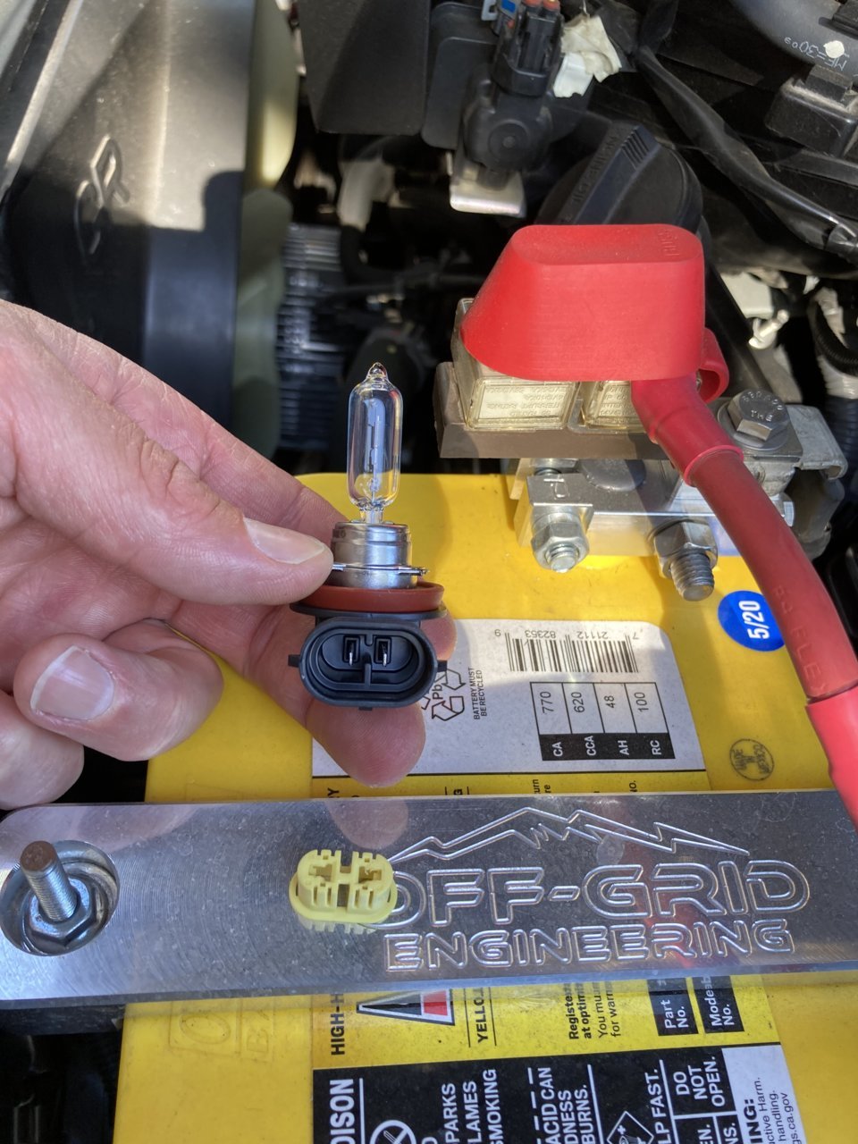

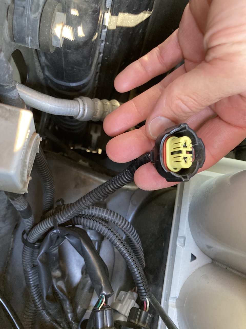

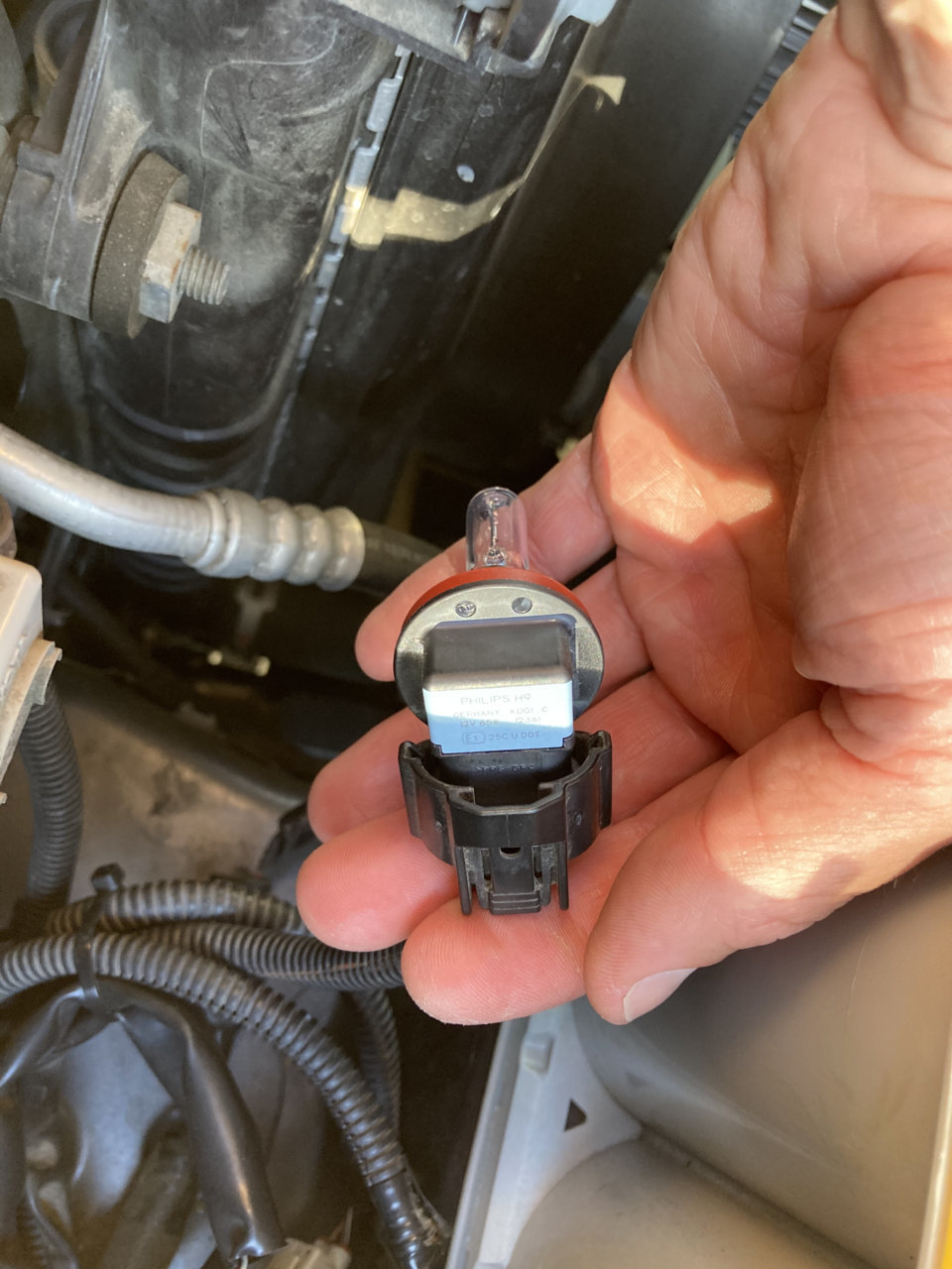

    Or if you prefer the EP:
    Tools:
    1. Small screwdriver, ideally made in the USA
    2. Beer, preferably green
    Steps:
    1. Identify H11 low beam connector. Hint, it is green and not yellow / beige
    2. Using small screwdriver, gently wiggle until the green plastic pice pops out. Cup your hand around the back of the connector while doing this so the cap does not launch into a dark corner of the engine bay.
    3. Locate green plastic piece and save for later
    4. Install unmodified H9 bulb (trim metal tabs prior to installing if you feel you need to or refer to @crashnburn80 ’s video of how to install an H9 bulb inside an H11 housing without metal tab trim using magician hand trick skills.
    5. Open beer and toast @Puppypunter.
    6. If for some reason you crush 12 green beers and pop all of the beige and green plastic pieces off in a rare moment of total euphoria and then realize you don’t know which is which, refer to the color codes below:
      1. Driver High Beam + is solid white
      2. Driver Low Beam + is solid red
      3. Passenger High Beam + is solid yellow
      4. Passenger Low Beam + is solid blue
      5. All grounds are black with white stripe
    Photos
    NOTE: You only need to remove the green plastic in the center of your H11 low beam connectors. Various photos of the yellow/beige H9 connector are purely informational so you can see the differences and observe the orientation of how this center piece is removed. You can leave your H9 high beam connectors/bulbs alone, the stock specs Phillips H9 for high beam which is already the best possible bulb. One very nice result of doing this mod is you only need to carry one type of bulb as a spare and you can even rotate high beam bulbs into low beam spots since the high beams should see significantly lower runtime.
