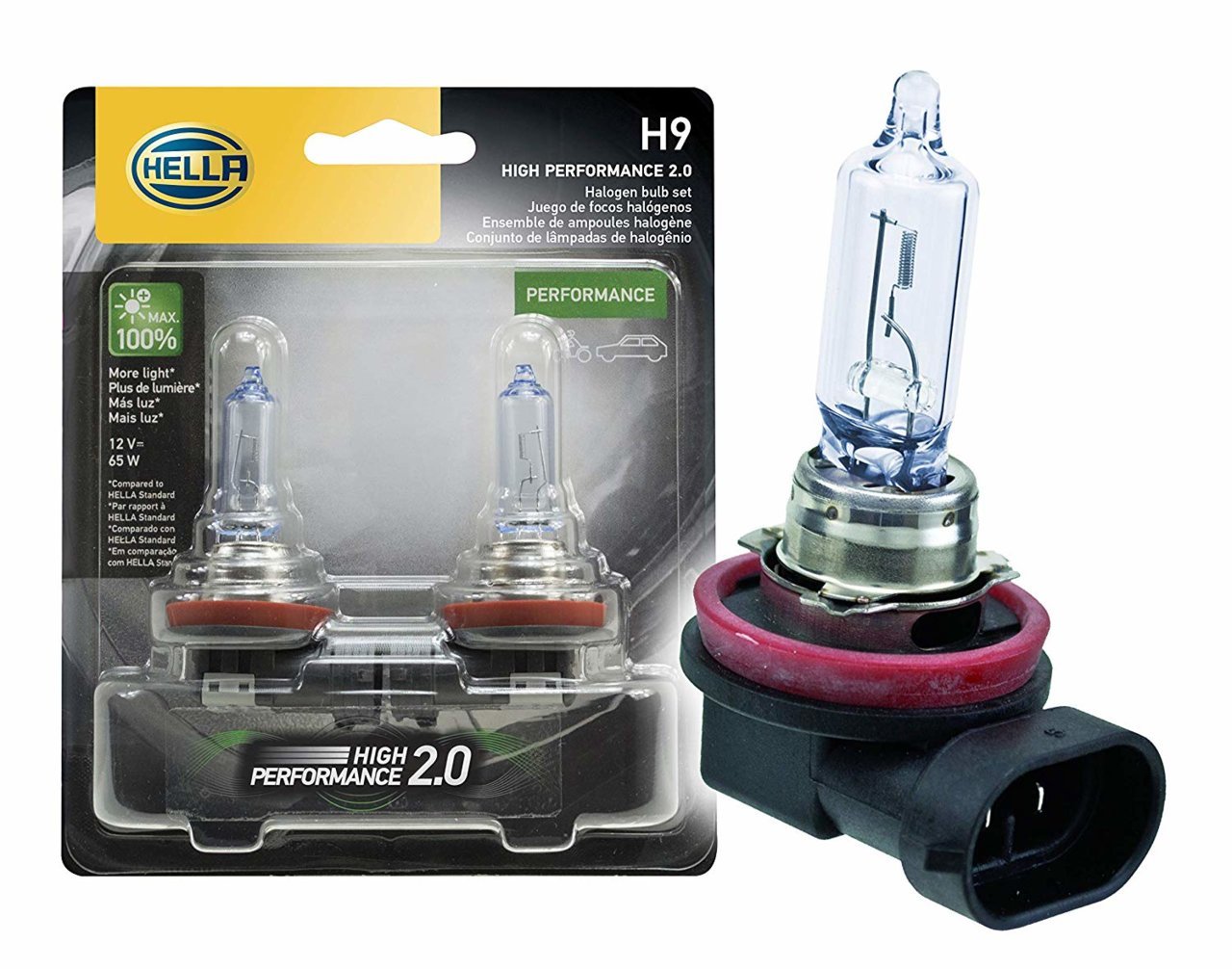

    I'll update the 2nd post and spell out all the recommended options more clearly once the last of the bulbs come in. Looks like they are currently due 3/10.
    Worst case if you decide to go with the Hella Osram Hyper H9s, the GEs are still a great bulb for the fogs.

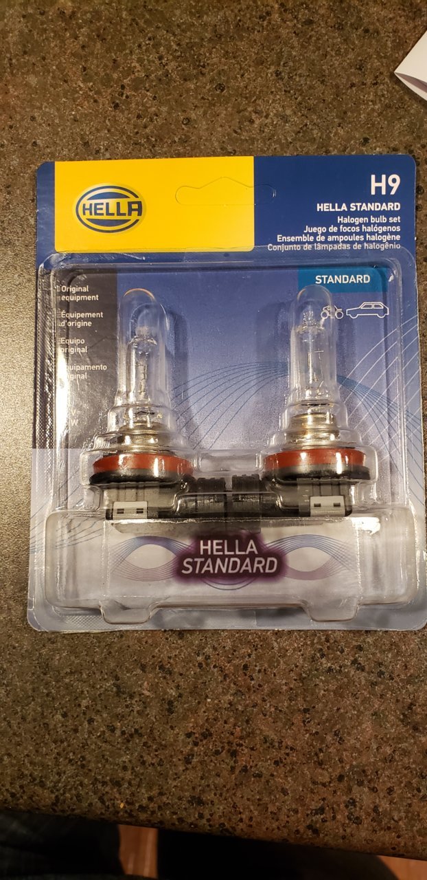

    Received these today from Rockauto.com. They are a good option for canadian buyers.
    Gonna try them tonight!

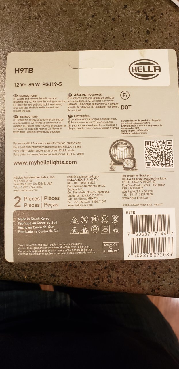

    It won’t be a massive improvement for the high beam, but it will be an improvement, and only costs ~$20.
    I should pick up the blister pack just to confirm they are the same, but I am fairly certain they would be. Those do say made in South Korea. Also note on the package the E1 And DOT labels I was talking about earlier. Let us know what you think! Try to get to an area outside of urban light pollution if possible.
