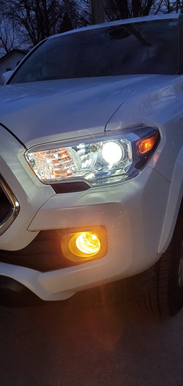

    I did a 35W 5000K HID kit in the headlights.....yellow Lamin-X on the stock fogs. Looks better and a nice boost in light output. Never been flashed either. I wanted the factory LED headlights but not for $1500.

    One of my Hikari Ultras stopped working (3 whole months), so I am doing the H9 swap along with amber Lamin-X on the fogs. As much as I hate all the yellow-ish halogen light and really would like a full LED setup, I’m just not going to pay $1500 right now for the OEM LED’s.

    I'd suggest going with the Hella Performance 2.0 H9s if you hate the yellow color, they are still halogen colored but a little whiter without losing much performance.
    Rather than laminex on the fogs (unless you want the yellow look when off) I'd suggest Nokya Arctic Hyper Yellow 2500k H11s, or Hella Xtreme Yellow 2900k H11s. They will give you the yellow output without messing with films on your lenses. I haven't tested either but the Nokyas should be more yellow while the Hellas should be slightly higher in output. Of course the best option would be Diode Dynamics SS3s in selective yellow, but I'm assuming your looking for something cheap and simple based on considering the laminex film.

    Couple things; it’s not about being cheap, it’s about living in AZ and having no functional need for “fog lights”. It’s truly more about the “look” in my case. I’d prefer the overlays because you can see the tint when not illuminated, not just when the lights are on.
    I will check out the Hellas for H9.
    Also, it’s ok to use H11 in replacement of an H16? Not too much wattage?

    I missed that you had a 2021 model. The 16-19 TRD trucks have H11s, 20+ are H16s. You'd need to swap the fog assembly to a 16-19 TRD fog to run H11s.

    Or use Lamin-X film

    At less than $20, cant go wrong....plus if you hate the color the film peels right off.
