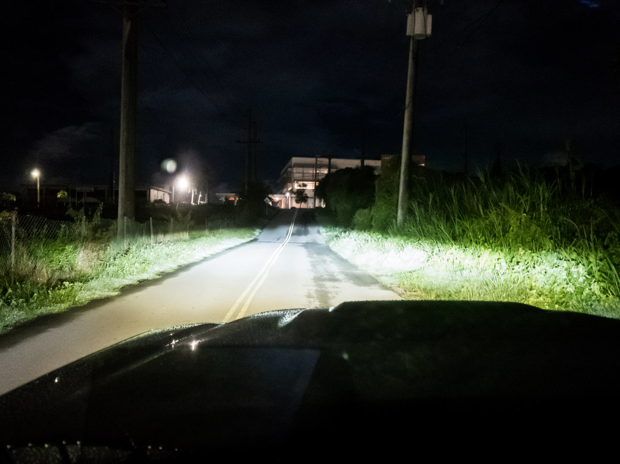

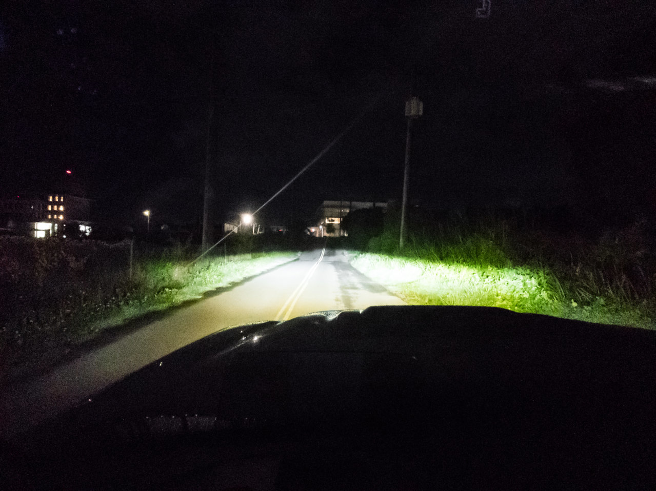

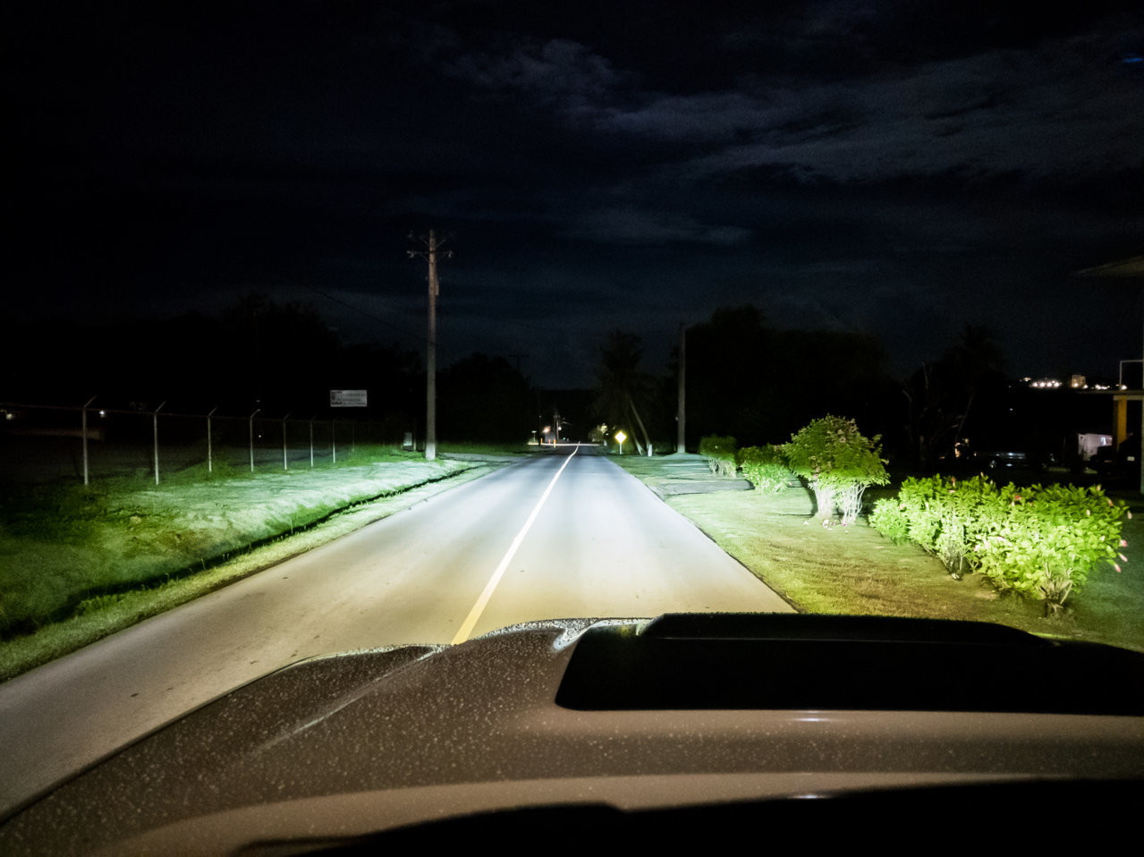

    So I went out and took pictures of my OEM LED headlight light pattern just for that one troll. Thread got locked, and now I have pictures with nowhere to go. So thought it would be beneficial to put it here.

    I dunno man, sure seems like the foregrounds pretty oversaturated to me/s. (2020 LED thread could also use them, in the lighting subforum.)
