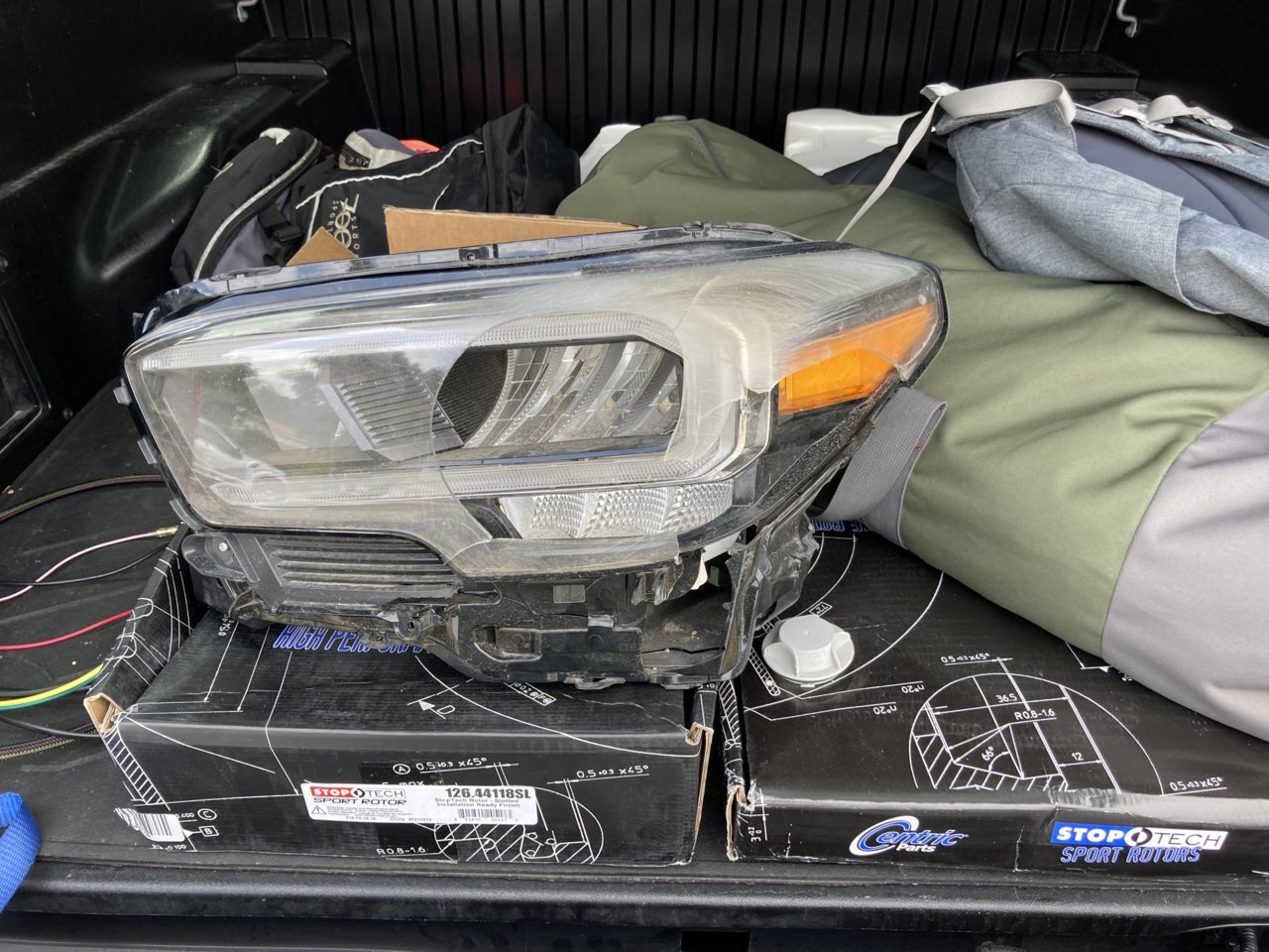

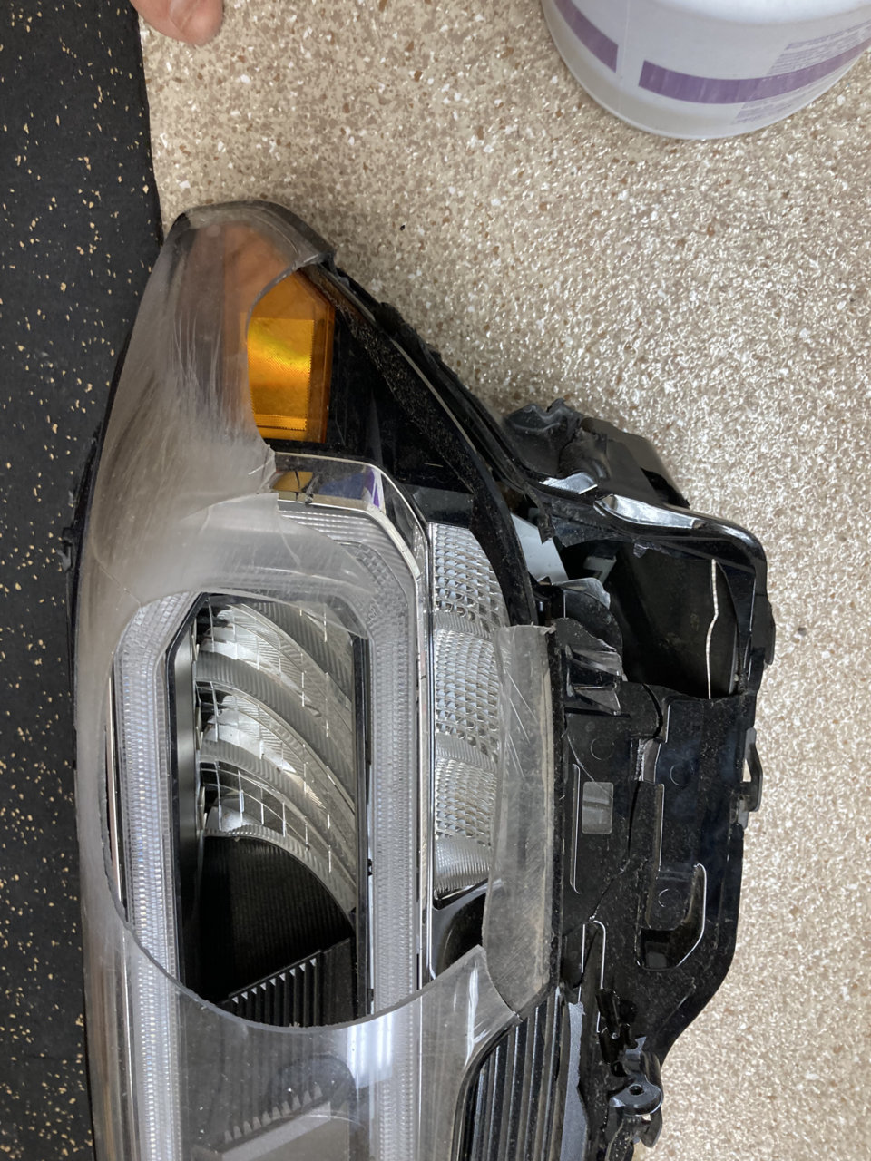

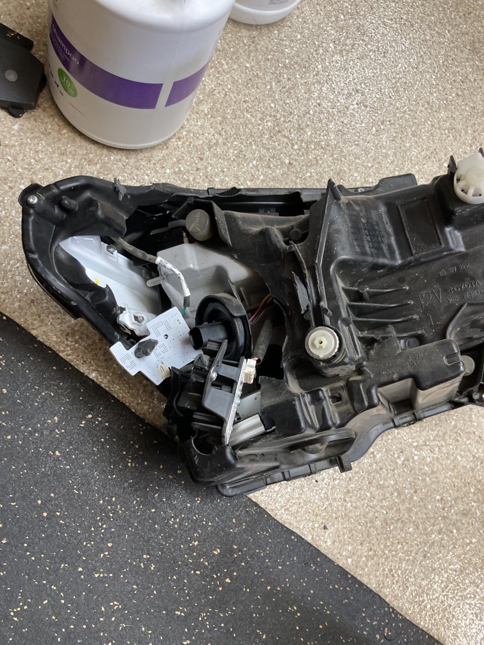

    Still a ways behind but catching up to @crashnburn80 in the bench test headlight category. Especially since two at his house are mine as well. Just picked this puppy up for $100 to use for harness validation.
    522DDE8A-06F4-452A-9467-393267321118.jpg 3B825C79-0148-42EB-8151-81562A9346C2.jpg 3DF7D29E-A761-49C5-A36B-C000A2FAE907.jpg

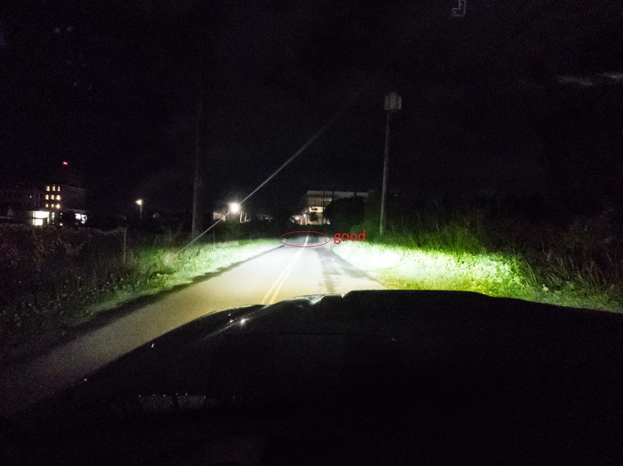

    Stop it.

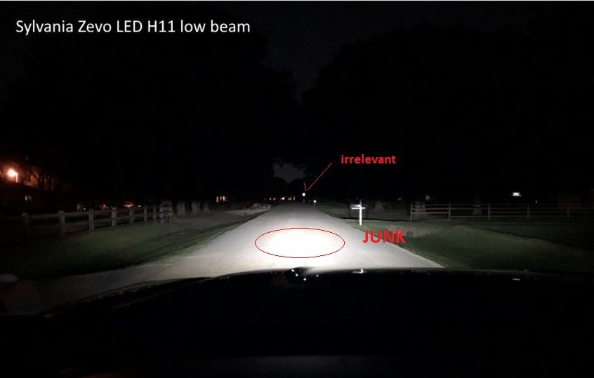

    While others have tried to explain it with words, perhaps drawings may help
    Your argument in the other thread, that the stop sign is illuminated, is irrelevant. A flashlight will illuminate a reflective sign. Even your own picture shows short-throw illumination right in front of the truck, which is the problem - you are posting exactly what is wrong with your setup
    Your picture
    OEM LED

    So from the video, your headlights glared right into the incoming vehicle. Might need to adjust your headlights lower.
    Oh ye, got em lowbeam pics you ask for. Don't really understand why you wanted to see them though, since they are functionally superior in nearly every category to any drop-in led bulb.

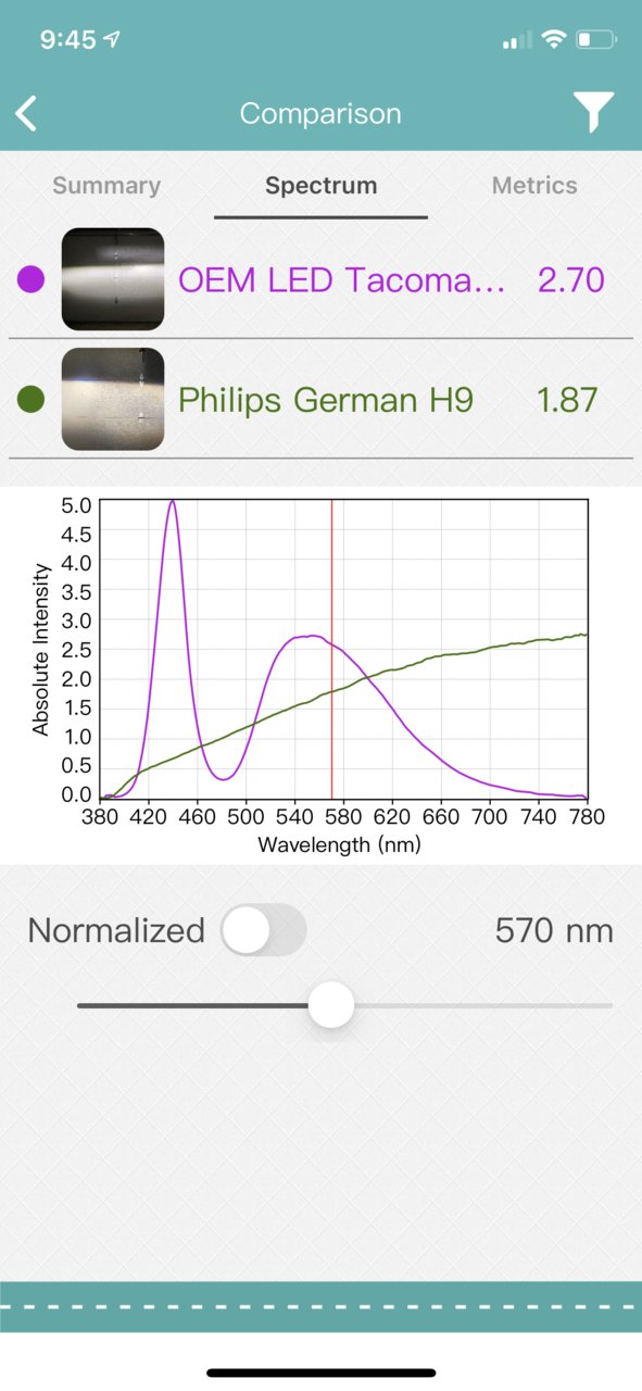

    That isn't how halogens work. HPS lights have very limited window of spectrum output, halogens have the best (largest) spectrum output of any light source.
    Human vision is far more sensitive to high color temps vs warmer color temps, which has both pros and cons. The video suggest 570nm is the best color wavelength for night vision. Your assumption is that halogens must be similar to NPS lights, but the spectrum is entirely different regardless of color temp. Below you can compare the OEM LEDs to the Philips H9 swap at 570nm. While HPS lights produce next to nothing at 570nm, the same is not true for halogen, since halogen lights produce the complete full spectrum unlike other light sources.
    A2EF5995-C0A4-4CA4-92C6-EA765F1A3604.jpg C462E605-E377-4FA8-9C1A-E00B5A564010.jpg
    What the video doesn't cover is loss of color perception using a low CRI automotive grade LED source vs halogen (since comparing to HPS) and the driver fatigue experienced by using high color temp low CRI blue based lights, not to mention the low performance of high color temp light sources in poor weather conditions.

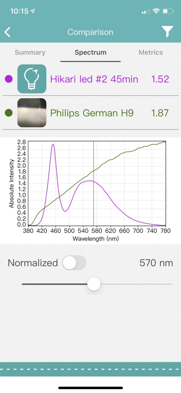

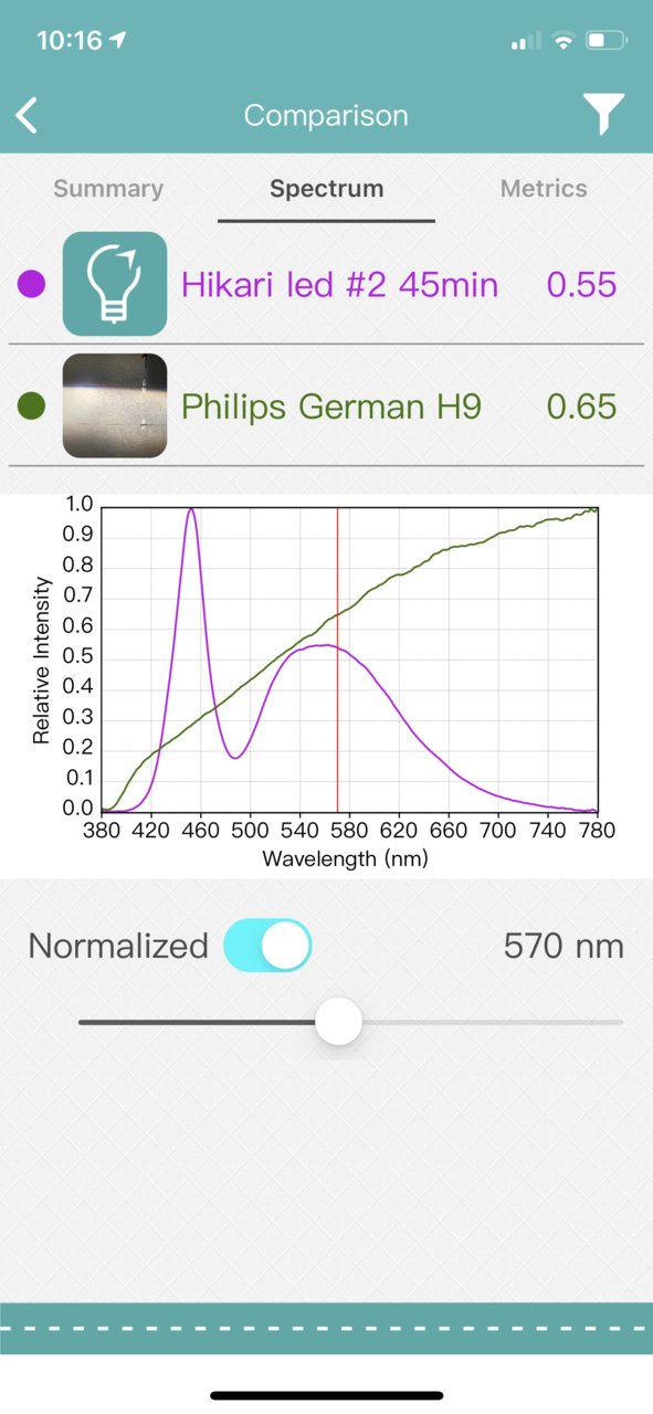

    And to provide a 570nm wavelength analysis against the highest output replacement LED (Hikari), halogens completely put even the best replacement LEDs to shame.
