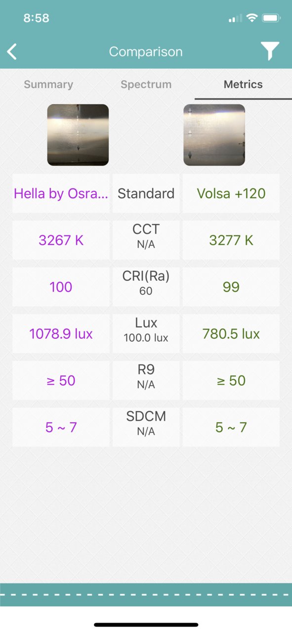

    Based on my testing, the Hella Osram Hypers are 3267k. The closest bulb I've found is the Volsa H11 +120s at 3277 which is nearly an exact match.

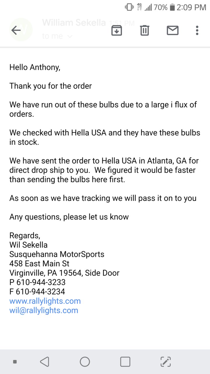

    Customer service doesn't get better than this!
  16. Feb 28, 2019 at 11:17 AM
    #496
    trazerr
    trazerr Well-Known Member
    Jan 8, 2015
    #145900
    973
    Oregon
    2024 Tundra Plat 4x4 LB (prev 2018 DCLB SR5 4x4 and 1996 AC LX 4x4 5sp)
    Literally just got the same email 30 secs ago...
    crashnburn80[OP] likes this.
