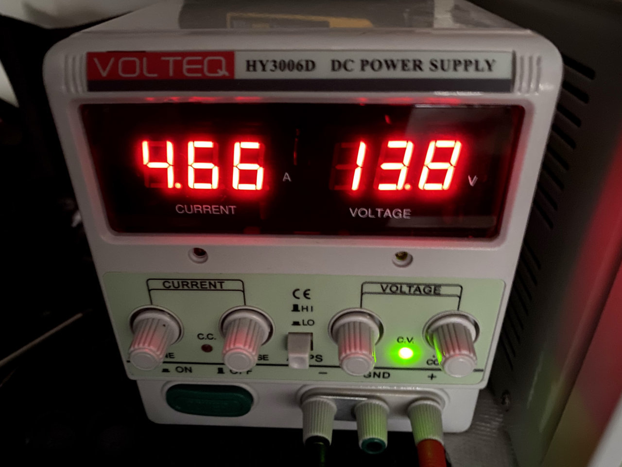

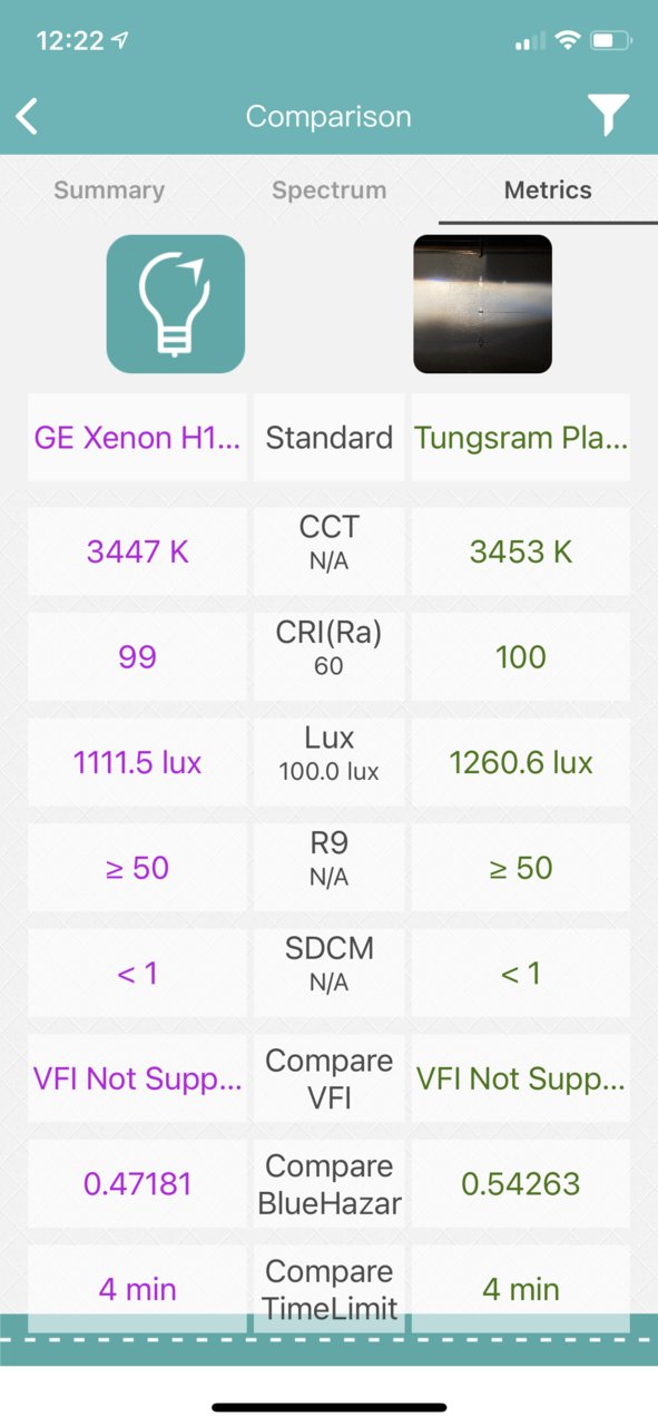

    Tungsram Nighthawk Platinum
    @skierd sent me these to compare to the leading Tungsram (formerly GE) Xenons.
    Tungsram places the Platinums below the Xenons in performance.
    I didn't have any Xenon +120s on hand to compare directly, but looking at the Platinums vs the GE Megalight +130s, it looks like the Platinums might have a slightly tighter coil winding with a slightly longer coil. The Platinums have the blue coating only forward of the filament, just like the Xenons, which reduces filtration output losses from the light passing through the blue filter before being reflected off the rear of the projector and projected forward.
    Tungsram Platinum left vs stock Osram standard right
    Measured output stock vs Platinum
    Wow. I had to double and triple check those numbers. To put that in perspective look at how they compare to the Xenon +120s.
    The color temps are even nearly identical. I cannot explain the discrepancy, though there is some variance from bulb to bulb, so I swapped the other bulb in the package and got similar results with a peak lux reading of 1210. I did a side-by-side visual test with the high performing GE Megalight +130s.

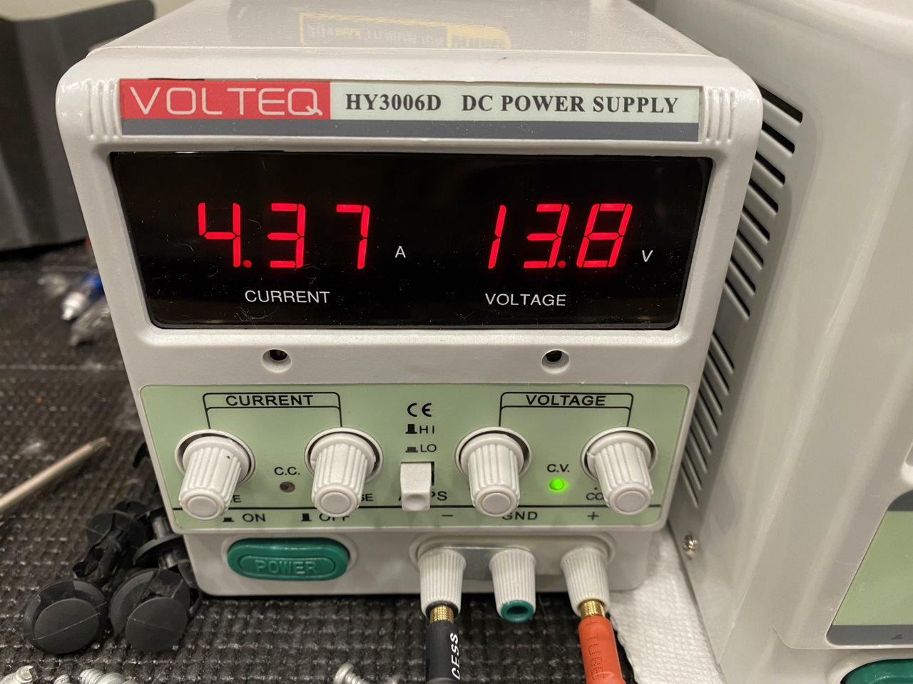

    Platinum vs Megalight +130
    GE Megalight +130 draw at 60.3w
    Tungsram Platinum power draw at 64.3w
    I'm not sure if Tungsram has made improvements to the product line since the acquisition of GE lighting, as my tested products and bulbs I have on hand were manufactured under GE. I might have to pick up some Tungsram branded Xenons to have a better side-by-side comparison. But these Platinums are stellar performers, as the best H11 tested yet. And if you missed the link in the beginning, Amazon currently has them at stupid pricing of less than $8 a pair shipped (vs $35 for the Xenons), easily one of the best lighting deals around.
