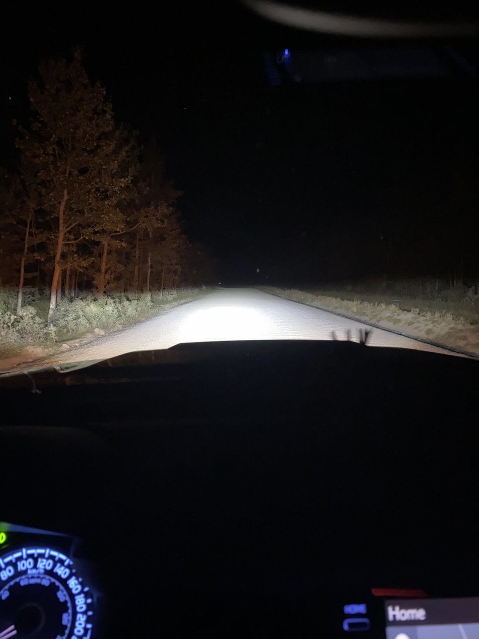

    Appreciate that - I knew it was in there somewhere. Thanks for taking the time to clarify. I swapped my halogens for LEDs that I found to closely match the filament pattern of the stock halogens before seeing this thread. I think they’re working well but after reading all of this I’m thinking about going to upgraded halogens instead. I just don’t really like the yellowish light in the stock halogens as I want the output to match the LED DRLs. The LEDs I put in have a good cutoff it seems but, again, after reading this I am wondering about their actual performance. Took some pics while out on a rural road last night…

    You could put horrible LEDs in and it would still have good cut off because of the projector assembly design. There is an internal light shield in the projector that enforces the cut off. Your picture has a lot of foreground light, that bright spot should be out at the horizon cut off, not immediately in front of your truck, which is usually the result of using a poorly designed LED having reduced distance projection. There are some reasonable performing LEDs if really wanting the 6000k look, but halogens perform better in a halogen assembly. Which LED units do you have?

    they are a brand called Fahren. 10000 lumens 6500k. Good point about the cutoff, that makes sense. I did notice the concentration of light in the foreground rather at the ridge of the cutoff which has reinforced me desire to go back to halogens. These Fahrens do seem to be designed to mimic the halogens. But I can understand where they may not do a great job.
