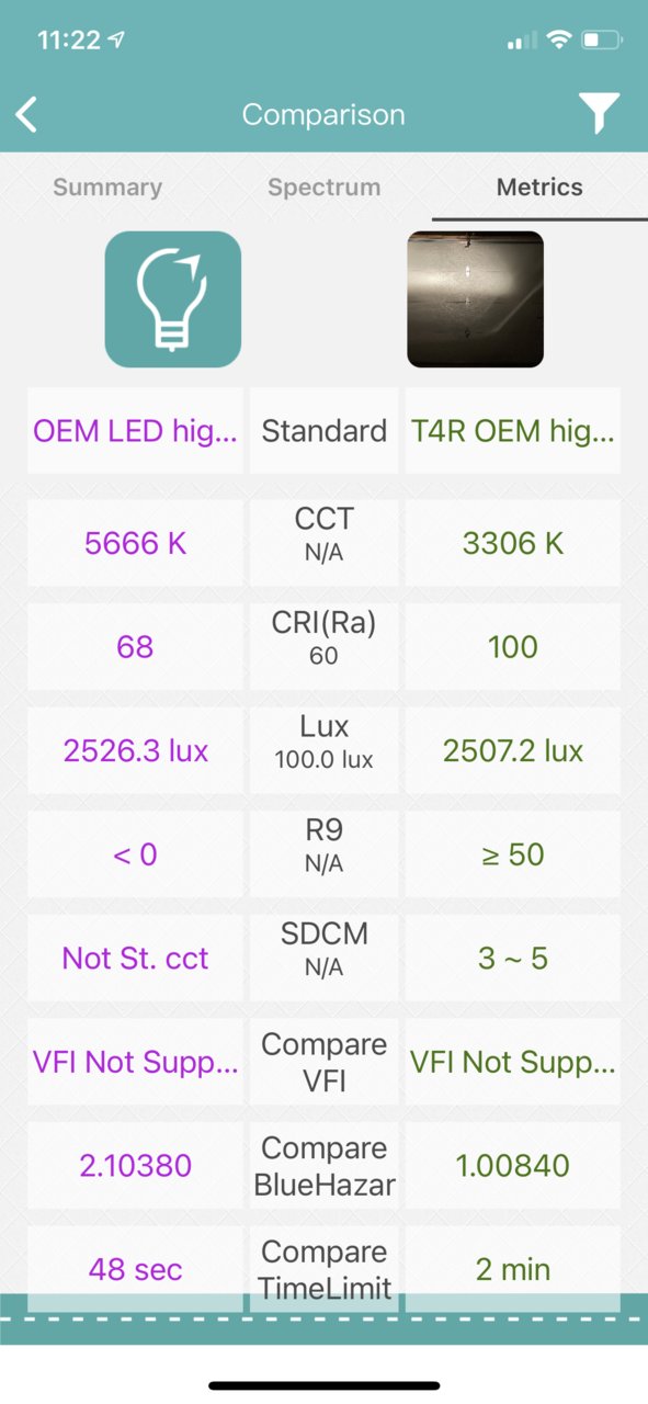

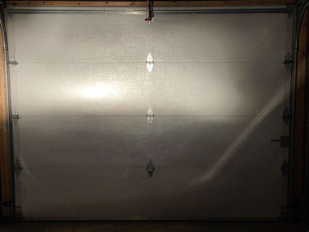

    4runner halogen high beam tests
    The 4runner halogen high beams appear to be excellent with a concentrated hot spot above the low bam cut off to maximize distance projection down road while providing a nice soft flood light outside of the hot spot.
    High beam only with low beam disabled
    How good? Compare the high performing Tacoma 3rd Gen OEM LED high beam vs the T4R stock 9005 halogen high beam.
    The T4R stock 9005 bulbs have nearly identical performance in output intensity to the Tacoma's OEM LED units.

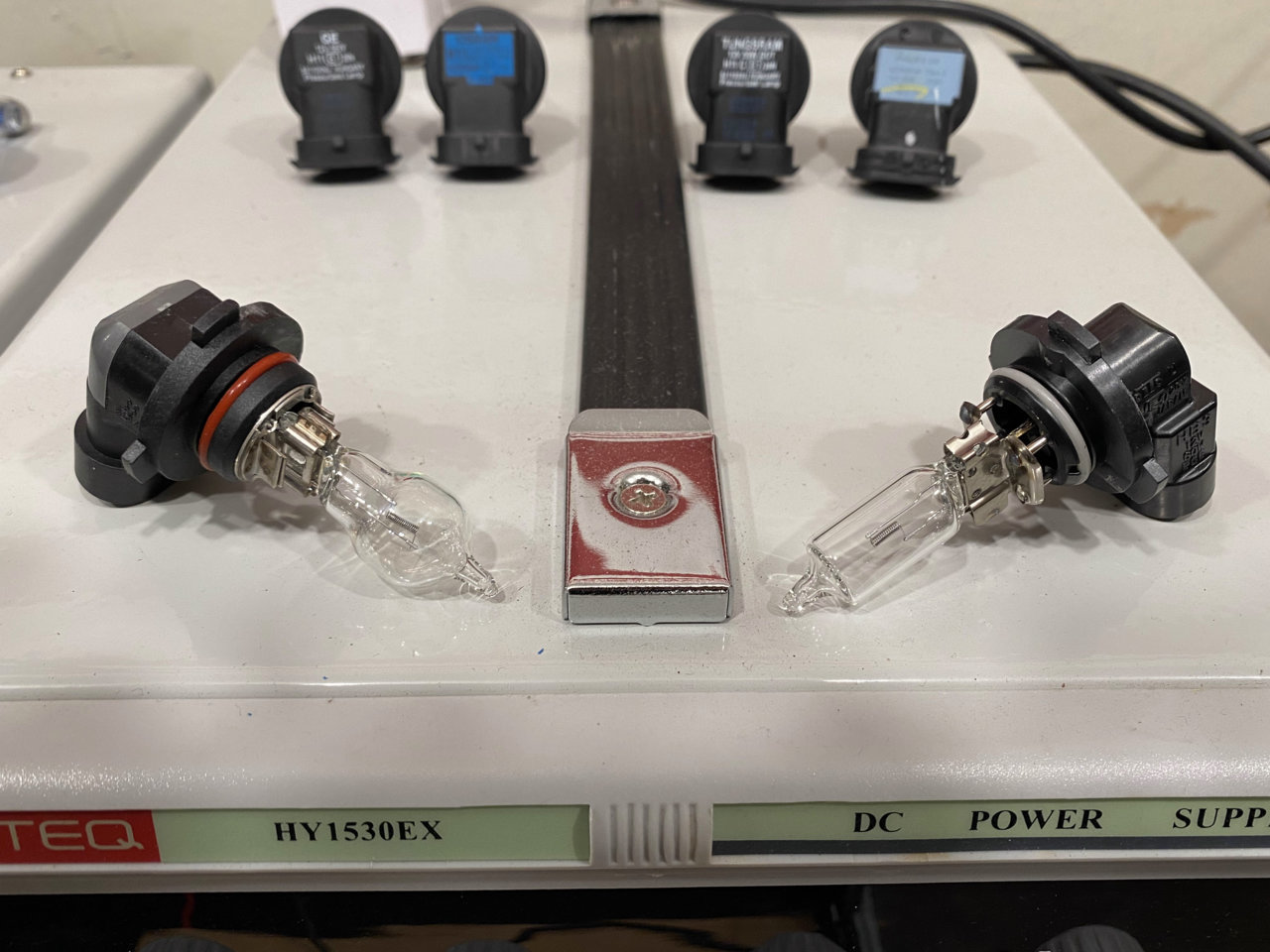

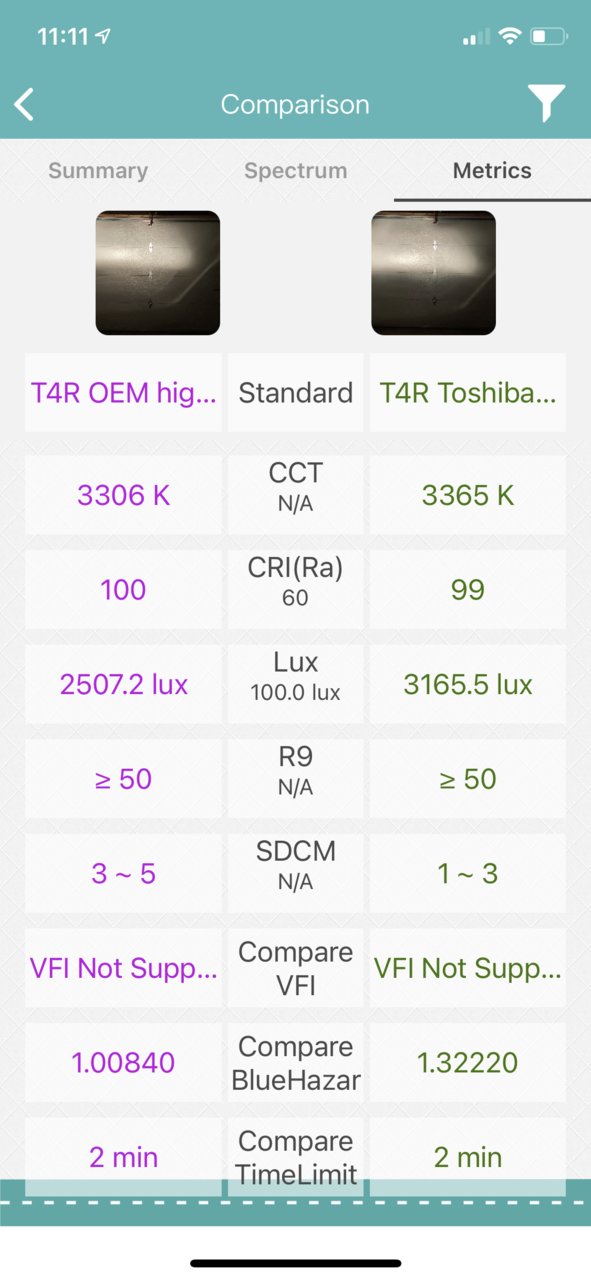

    But what about upgraded bulbs for high beam?
    Toshiba 9011 HIR (left) vs stock Koito 9005 (right)
    OEM 9005s vs Toshiba 9011 HIRs. The Toshibas return a 26%+ gain on the high beam output intensity.

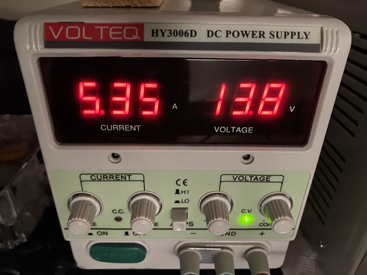

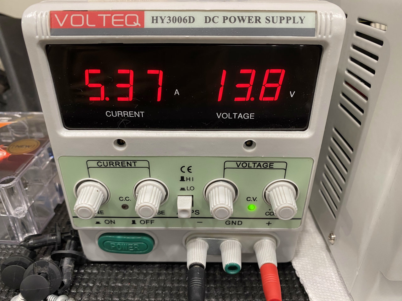

    Power draw on the OEM 9005s, 74.1w
    Power draw on the Toshiba 9011 HIRs, 73.8w. Drawing less power while being 26%+ higher output.
    The Toshiba 9011 HIRs put the Tacoma OEM LED high beams to shame with 25% higher output intensity than the OEM LEDs, while also being a far more ideal color temperature.

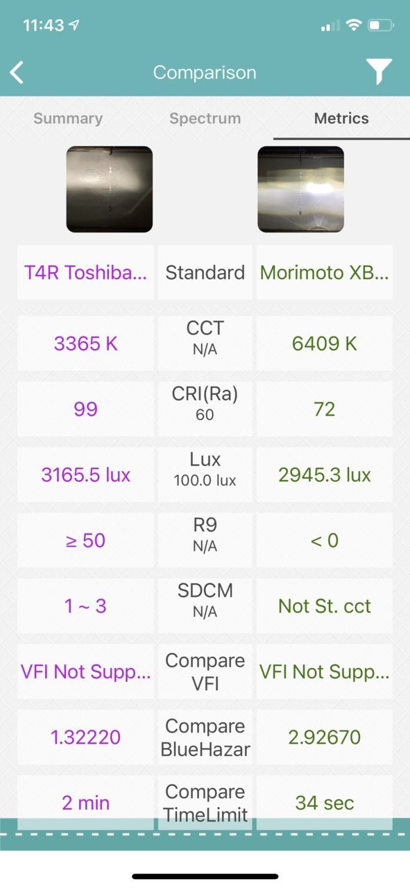

    But how does the Toshiba 9011 HIR swap compare to the ultra high output intensity high beam from the Morimoto XB 2.0?
    The Morimotos fail to outperform the HIR swap. The HIRs come in about 7.5% brighter than the Morimotos while also having a superior beam pattern with a focused hot spot and soft flood pattern that the Morimotos cannot match.

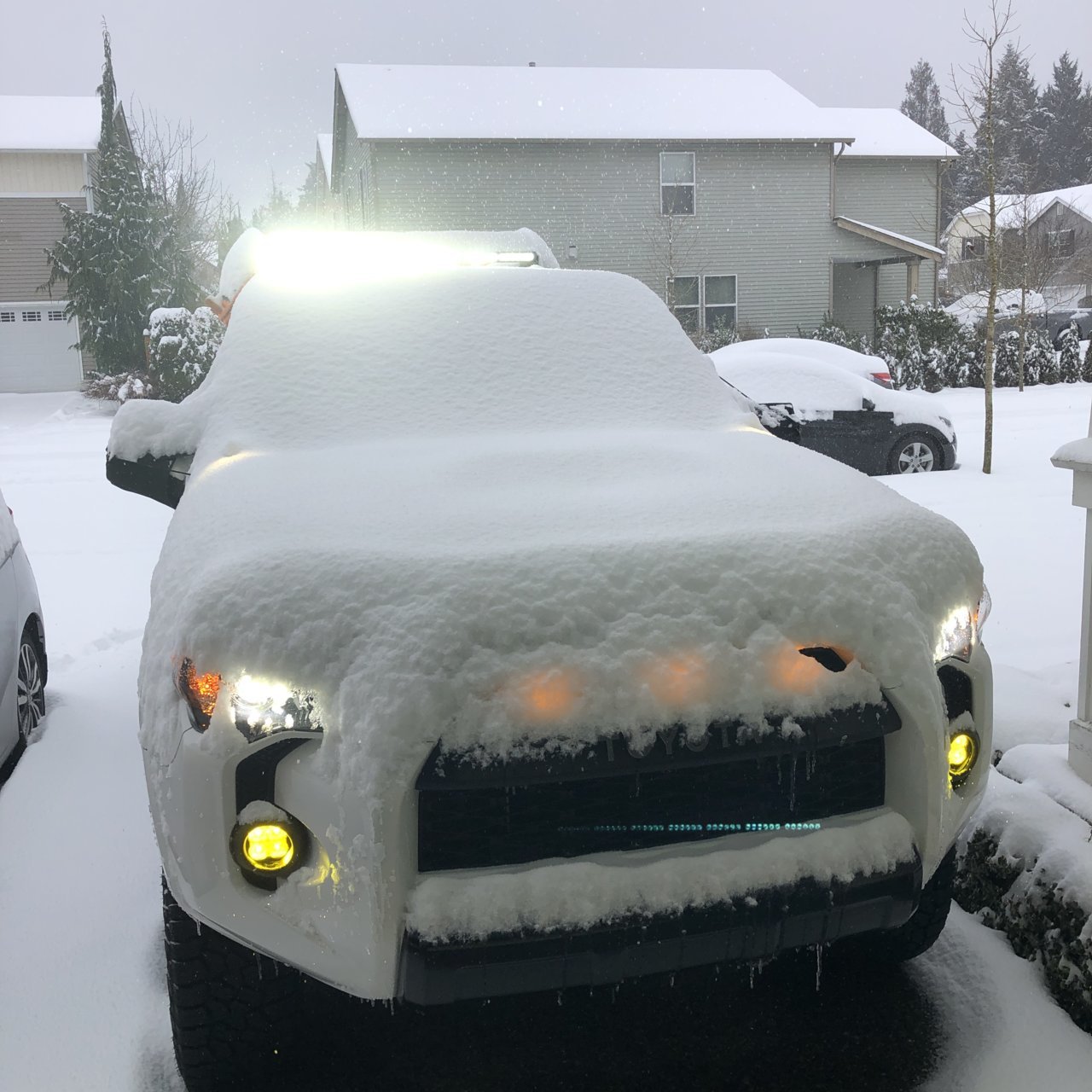

    The factory high beams were decent on the backroads coming back from late nights at Mt. Baker.
    I got to experience one of the few times where I wish the Foglights stayed on as thick fog began to form below the headlights on some of the higher speed roads. Regulations suck sometimes
    I cheated and turned on the Selective Yellow SS3 Pro's with clear driving lenses mounted as auxiliary high beams

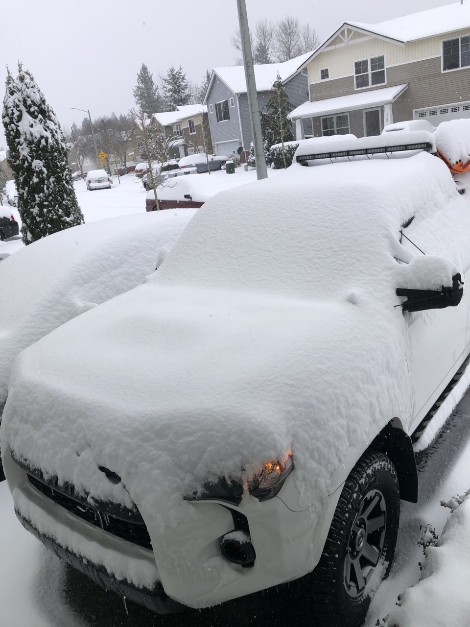

    So the elephant in the room regarding the OEM LED low beam headlights is the issue of not getting hot enough to melt the ice when in use.
    I frequent the passes and mountains in the snow season and being in WA you know the weather can get real weird.
    Is there a remedy to this problem?

    There is no specific remedy for snow accumulation on the LED low beam. All snow will not stick of course, it needs to have the right amount of moisture content to collect on a surface, especially a highly slopped one like the T4R headlights. The remedy would be to put on the high beam, which heats the entire front lens but the high beam is more harmful than helpful in snow visibility.

    Would a hydrophobic coating on the headlamps prevent accumulation?

    Exactly the setup in my T4R - except for the Oscars behind the lower grill. I highly recommend it. I do miss the Ultimate Headlight Upgrade with the 30" DD LED bar in the lower grill on my Tacoma though.

    In my Tacoma, the light bar (an all driving pattern Diode Dynamics Stage series single row) was wired through a relay to trigger with my high beams. What it gave me was a lot more reach than the high beams alone. I should note that the DD bar replaced a CaliRaised dual row all driving pattern bar that had terrible light distribution. My intent was purely longer range lighting and I was not disappointed at all with the DD bar. I still have it in the basement waiting for an application. I can't use it in the T4R because of the center mounted sensor panel.
    As for the Oscars or the DD bar, one has to remember that as good as the Oscars were / are, they're 30 year old technology. I've got some new 100 watt bulbs waiting to go into the Oscars and we'll see how much difference they make. (Installing new bulbs requires removing the whole front bumper cover.) Right now though, I'd have to say the DD bar was better.

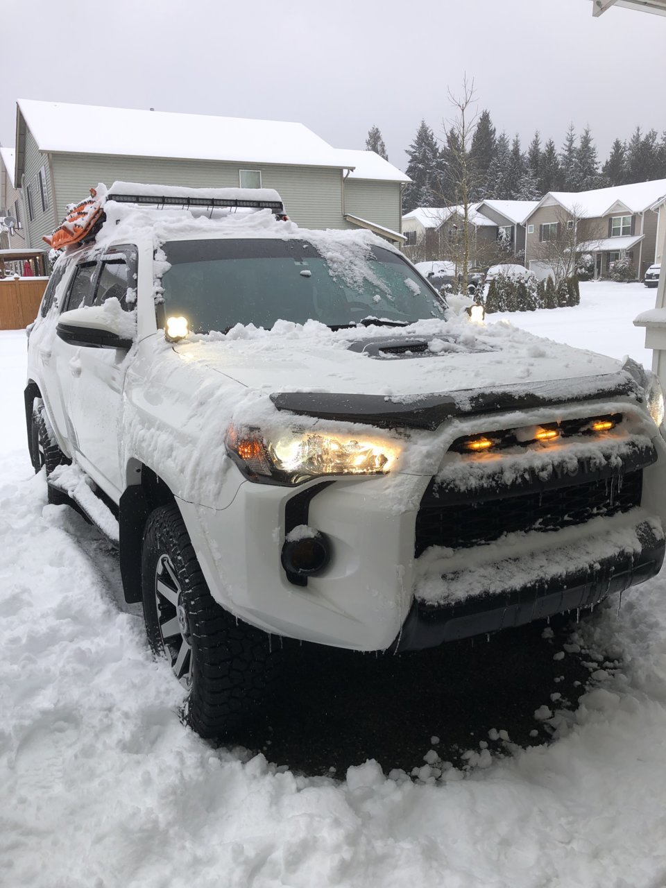

    Depends on the circumstance and mainly on temperature from my experience.
    When driving around I found it to work well. However, there have been plenty of nights in WA where it would snow 8 inches and dip into the 20's causing ice to form when sitting over night.
    Whether you have a hydrophobic (beading) or hydrophilic (sheeting) coating it will ultimately end up the same with enough time and precipitation.
    Nicest part of having a coating is Snow comes right off when needed in the morning if not below freezing temps.
